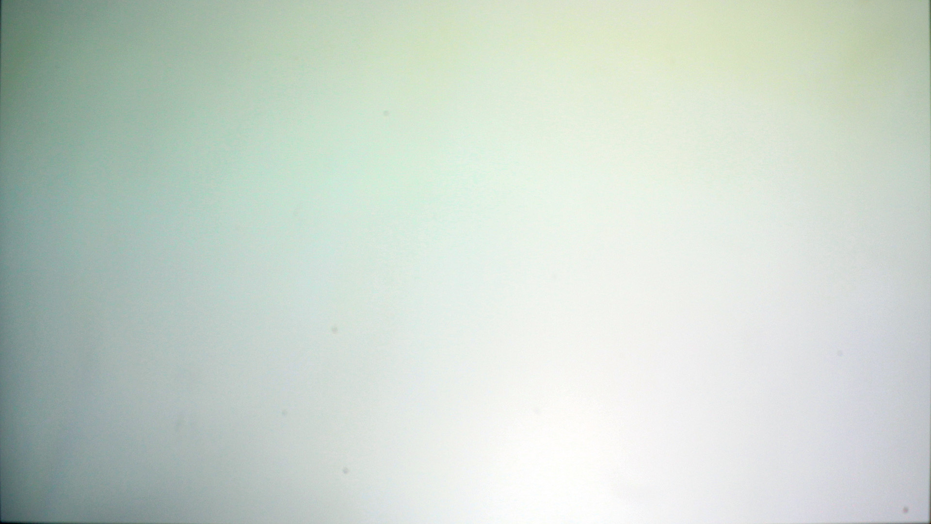

Re: Mask
well, nobody knows, trial error time!
this is photo taken with my dslr from a white image projected in a white wall. can see clearly the hot spot, and how brightness decreases to the borders, especially the left side.
this photo is photoshoped with automatics levels, and the degradation is more visible.
with this filter, is much more visible, not realistic, the brightness diference.
now, i guess, i must invert and convert some of these images to apply the mask.
