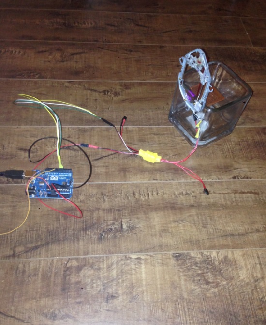

Below are some pictures:
Build Vat and Linear Drive - About 5CM Z
Stepper controller with connectors
Arduino With Connectors
