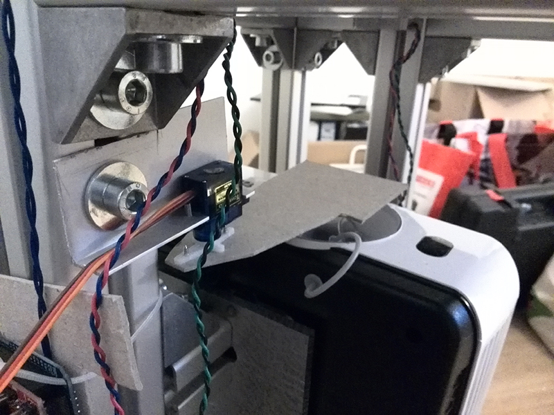

1x Servo SG90 for the projector shutter

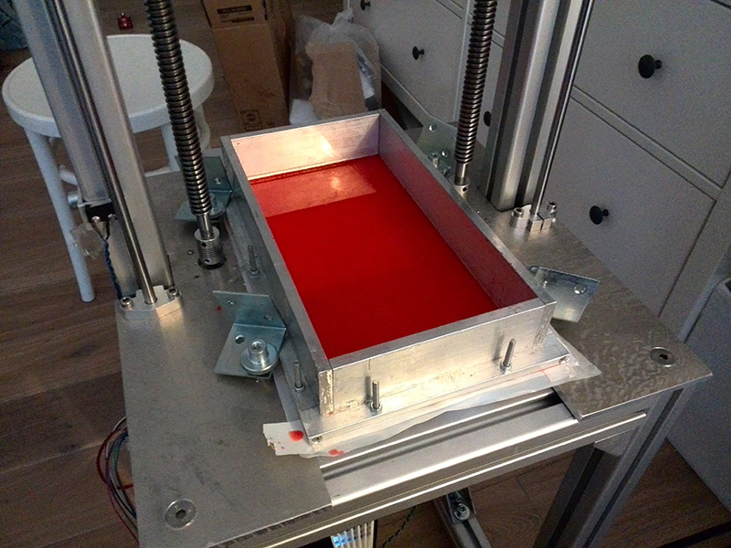

VAT:
Flexvat made of aluminium, acrylic glass and PTFE film 0.1mm
Any comments, suggestions and critiques are very welcome:

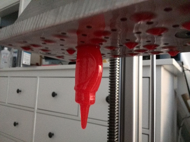

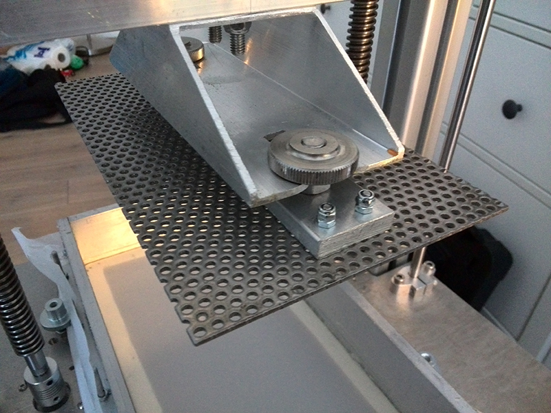

Printer:
VAT:
Projector Shutter

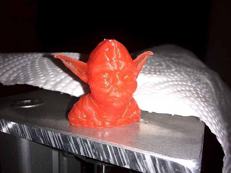

nice job. and most important, seems no problems at all in your first print. time to tune settings.
what resin are you curing?

Re: DLP Printer, FlexVat, Germany
Thanks, I'm using Fun to do at the moment. But I received some Makerjuice today and I will that tomorrow...
Wonderful prints, excellent looking machine! I'm glad it's all working well for you.
Why do you use acrylic instead of glass under ptfe?
				Matze
- Posts: 37
- Joined: Fri Jan 02, 2015 7:03 am
- Location: Germany [phpBB Debug] PHP Warning: in file [ROOT]/vendor/twig/twig/lib/Twig/Extension/Core.php on line 1266: count(): Parameter must be an array or an object that implements Countable
@Steve: thanks
@how_eee: I use acrylic because i had to drill holes into it, to tension the ptfe film. Also small holes to remove the vacuum between the ptfe and the acrylic bottom...
Hallo Matze,
I am from Germany, too.
Nice setup and good looking first prints!
Do you use for peeling an asymetric lift of the build platform like mUVe 1?
Hallo Alex
Thanks a lot. It took a few days of calibration and trying out different build platforms/vats, but I'm finally finished with the hardware part. I'm using a FlexVat similar to this (http://projectsinterestsandetcetera.com ... m-flexvat/).
I think it's the best way to design a vat. It's really fast and it takes about 10 minutes to exchange the PTFE film once it's worn out or damaged. Good luck and PM me if you have any questions.
regards,
Matthias
