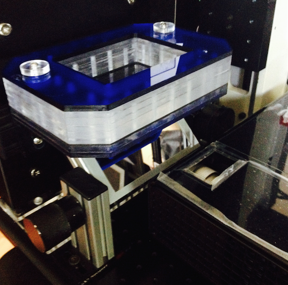

This is a sectional Vat, and the FEP film is sandwiched with a gasket. The structure is interchangeable, with a flex or rigid base.

Double the printer, double the fun! Nice work.

Beast! Looking good!
