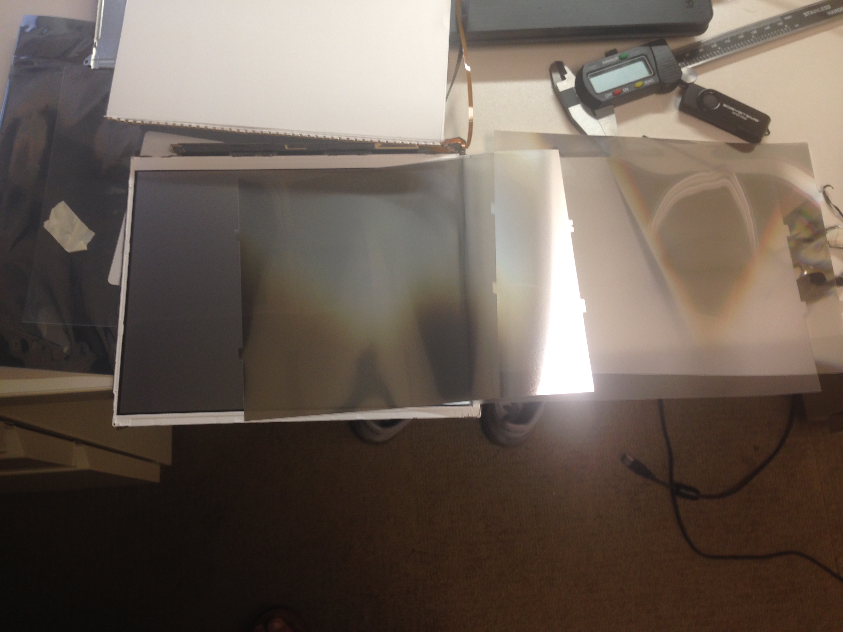

Well, seeing as no one has posted any photos before...
I went ahead and started to take apart the iPad screen. Man, that initial metal backing is a PITA to remove! Seeing as I'm not 100% (not even 50%) sure on what I'm doing, I very well could have take too much apart on this screen, though in my defense it all comes out a little to easily so maybe it was meant to be?
The layers or removal from front to back goes as the following:
- Aluminum/metal backing
- White backing
- clear sheet with LEDs on edge
- translucent sheet (my guess is that it helps to evenly spread the light)
- 2 layers of transparent sheet (makes things look magnified)
- Screen
Tried to take some photos, sorry for the bad lighting.
- White backing
- Screen

Kept chugging along, shot a short video...
Good news! I didn't mess up! Well at least it still comes on and there is a picture
https://www.dropbox.com/s/towgl7hno33iz ... 3.mov?dl=0

Phife
- Posts: 239
Re: Retina iPad Display
You did it right Anderson, Removing all the black tape along the edges allows removal of the backlight and all its films. You should be left with just the LCD Glass (black on one side, reflective on the other) and the PCB control board.
