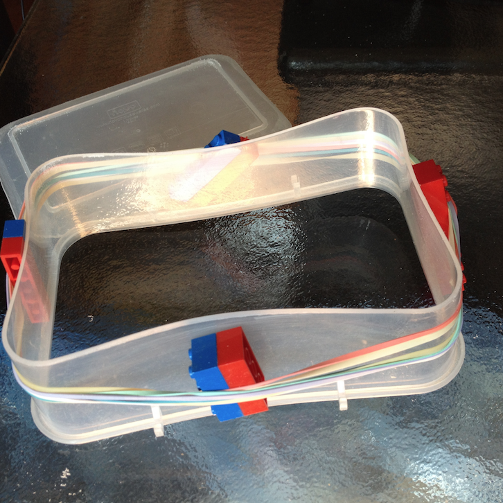

awesome idea by the way hp using a Tupperware container

Hello
Actually the resin is; directly from the bottle to test the film; As of now I am making the FLEX-VAT from a container,
and going to foil the bottom part corners away, rather than cutting it to have a clean surface .
