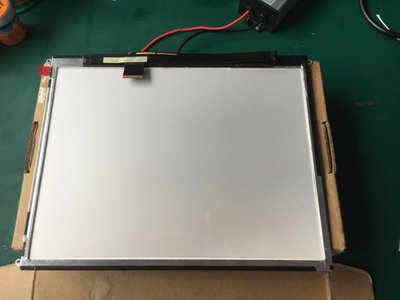

Hmm, yeah, getting a uniform light array is not easy.
We needa get some other data points about curing times aside from Photocentric. They didn't spec what layer height they were using when they reported the 55 sec layer time. They only mention the Retina display would give them a XY resolution sub 100 microns.
