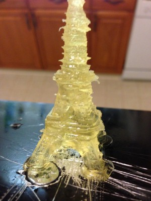

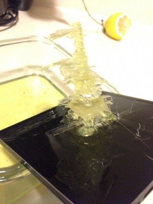

My first build didnt go very well. But at least I was able to produce something. It was supposed to be the Eiffel Tower. One thing that has me really puzzled is that it not only curing the image but the surrounding area. I tried to turn down the lamp power and played with the contrast but its not helping much.
Any feed back would be great!
Build Setup
CW VER.RC
SLICE = 0.100mm
EXPOSURE = 7500
FIRST 3 LAYER = 15000
LIFT = 2mm
To break the bonded resin I only lift the part.
RESIN
Marker Juice Clear SubG+
I think this was a bad idea having a clear resin will cause the cure to be more sensitive to light. I am considering purchasing so black die to reduce the transparency.

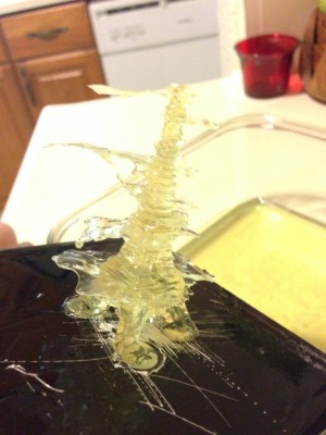

After a little cleanup.

I like it! Modern art.
I think you need to add some pigment so the light doesn't bleed up to the next layer or the surrounding xy voxels.
Keep it as cool souvenir though.

Agreed,
Without pigment, the UV light will bleed through to other areas. You may want to run a few exposure tests on the resin and drop down the exposure time a bit.

I think your problem is probably overexposure and light spread/penetration. I would try a pigmented resin and or dialing back the exposure. I would check the thickness of 1 layer cure at your exposure time and see if it is close to your slice thickness. I have mine cure a little bit thicker than the slice so it sticks well to the one above it. My exposure time with the SubG+ pigmented resin is 5500ms for a .1mm slice (actually curing 1.3mm). My projector is a Mitsubishi xd430u, 230w UHP lamp, 2500 lumens. Your exposure may be longer or shorter depending on your projector.
I have Mach3 running my printer so I have a macro I use to expose a little test square. I put a small puddle of resin in the tray and try different test exposures. I remove the cured square and caliper it to check the thickness. I have to re do this every time I try a new resin or change the color or concentration of the pigment. Maybe Steve aka PacManFan could add a feature to his CreationWorkshop to help those using the ardino controllers find the correct exposure time.
