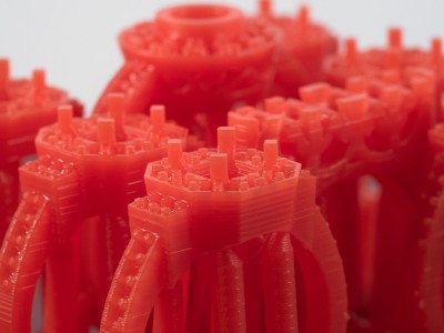

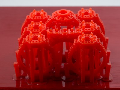

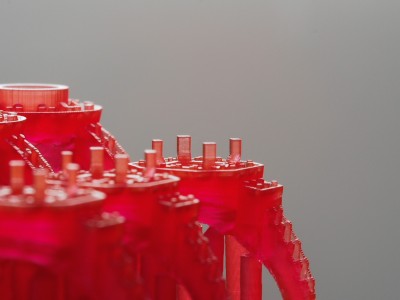

Posted: Mon Mar 03, 2014 4:47 pm
by Craig Turley
Here are a couple prints with Fun to Do Red:
50um x/y 38.1um z.

Wow.. that is pretty fine. Silly question but how repeatable is these results?
Re: Fun To Do Prints
Posted: Sat Mar 08, 2014 6:39 pm
by Craig Turley
Protoneer,
The results are consistently repeatable, just need to keep an eye on the pdms.
Craig
