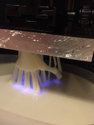

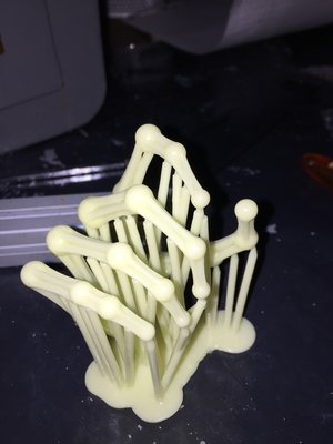

				For our event at the rapidpro we are printing some example pieces.
this print came out really nice, i'm printing a second one with 1.8 seconds exposure time.
i've also raised my vat with 4.5 cm to increase build size.. and that worked
Cheers,
