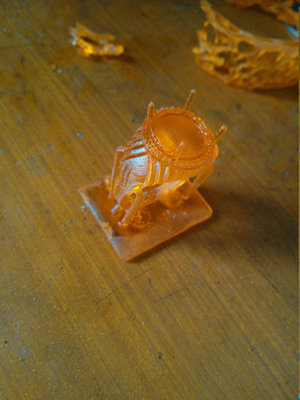

Posted: Mon Jan 26, 2015 11:48 pm
by Yongzhen
1204 cnc screw
slice thickness 0.04mm
exposure times 3500ms
bottom exposure 3000ms
top-down
z lift distance 4mm
speed 300

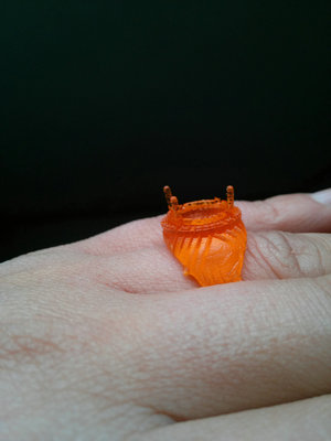

Very Nice prints! How did you generate the supports? Was it with my new CW 54 version? I see support tips angled inward.
