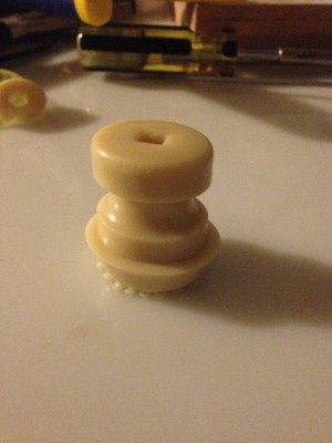

The widget was the first print from the system. Just a shape test really that included an angle, sharp corner, radius, fillet and square hole. 75 micron layers SubG+ .15% tan pigment. Had an aspect ratio problem due to my video driver. Was supposed to be cylindrical not elliptical...

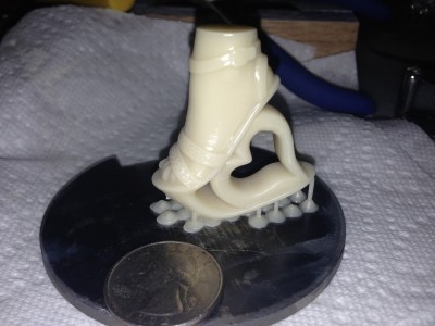

This shoe is the second print from this new system. 62.5 micron layers printed in SubG+ .15% tan pigment.
I need to fine tune the exposure and pigment levels to get sharper details but overall less than 1 week from start to finish building this printer and I am very happy with the results.

Widget
Shoe

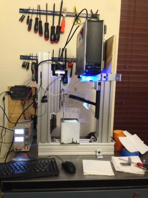

Do you have a build log or any additional info on your one-week-built printer? I'm in the process of designing my own top-down and would love to see other's successful examples!

Frame/structure is 80/20 aluminum (3030 to be exact).
Z Axis is stepper driven stage I bought years ago on ebay (has a Kerk screw and anti-backlash nut)
Controller is Mega2560 board from Amazon.
Vat is a 4.5in square steel tube - 5" tall currently.
I have the projector mounted on an Igus linear bearing so I can adjust it vertically to change the print size (within limits).

Do you do anything special to handle displacement of the resin caused by the build platform?
Do you have any 'wiper' system/recoater blade for the meniscus?
Some images of your machine would be extremely helpful!

Nothing special is required to handle the platform displacement. You have to start builds manually by lowering the platform into the resin until it covers the platform, then raising until about .5mm above the resin surface. Then I scrape excess resin from the platform, let the remaining settle out and start the build.
Here is a picture of the machine. Apologies for overall lack of refinement...
