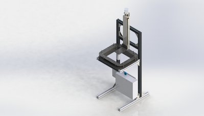

So after being out of the US for the last 9 months traveling for work I have a couple weeks here and have been able to get all the parts I've ordered and went ahead and ordered the rest of the parts for my printer. I'll be moving to Portugal after I'm done with my current project in June and will be heading there in a few weeks for work so I'll probably finalize the build until I get there.
Build details:
Bottom up
Z-axis: 300mm of travel THK linear slide bought off ebay new for $150
Vat: Flex vat where the vat walls push down into the film to tension it. Idea is to allow use with projector or LCD
Projector: Acer H6B510BD but will play with LCD options
Ball head to level build plate to vat bottom
Build some parts out of carbon fiber due to free time and supplies at work. Vat walls, platform bracket, shutter and z-axis motor adapter
