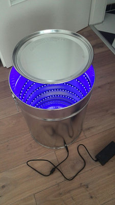

				Just finished building a cheap UV-curing oven:
LEDs 43,00€, 410nm:
Bin 15,25€, d=350mm, h=400mm:
Power adaptor 12V, 9€:
Plug, 1,25€:

				this is cool, thanks for the idea, i was thinking of building one but did not think about something so simple.

				Adding this to the shopping list, great idea! I was planning to build something similar, basically a reflective cylinder with a strong UV bulb, but the LED stripes have never crossed my mind. Thanks!

				Do you think  LEDs would work for this?
