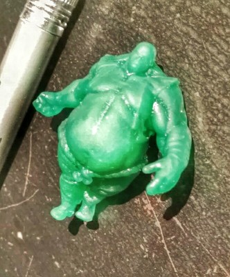

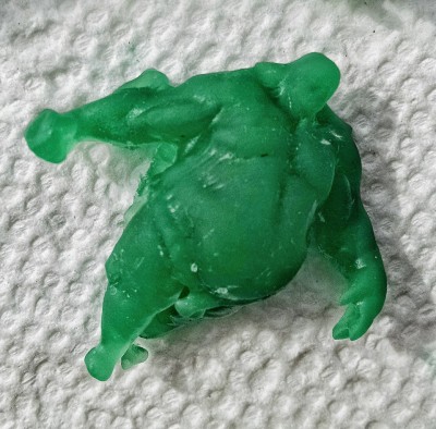

Hi all, after lurking and asking stupid questions for a couple months, my DLP top down printer has come alive! Here are the first tests and a little video
Pictures(first 2 only)
Also does anyone know how to reduce the shutter time on projector? (the time that lets the resin settle after moving the platform before turning on the image)
First semi successful print :)
