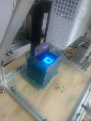

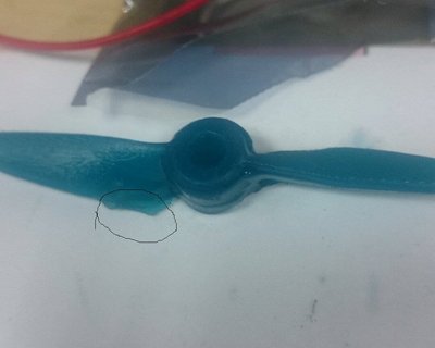

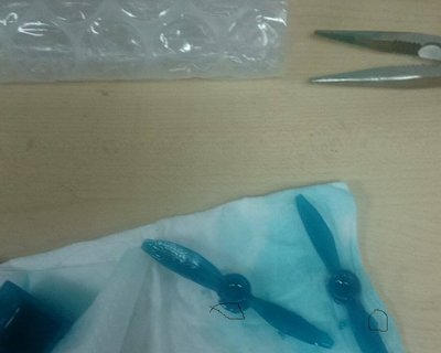

Hello guys,
i built my own 3D Printer using Top Down technique and i got some problems with Prints.
The Printed Part as same as the design plus some excess cured resin with it like attached photos.
i can't solve this Problem, i need your help to solve the problem.

Hello and welcome! Looks like it could be settling issues where it's starts to cure when the resin is still moving and haven't settled. Try bumping up the wait time in between layers...mayb3 15000 or longer, depending on how viscous your resin is.

Hello Guys,
Thanks for your recommendations , its all about intensity of light and exposure time.
the problem is solved totally when i used low penetration resin.

Hey james, i don't remember too
i'm using MS Resin, the previous photo attached below.
how ever i solved this problem for this part while it takes place with another parts geometry.
the parameter i changed is blank time and Z Lift speed.
