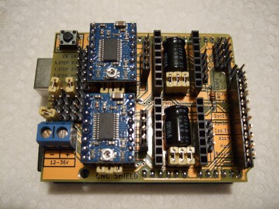

by johnrpm
soldered board
I have opted for grbl running on a uno for my dlp printer, with blue ice stepper drives and a protoneer shield, this makes for a small controller that can fit in a small corner somewhere, the only seller I could find for the grbl shield was from new zealand, only took 6 days to arrive in the UK.
As the PC must be connected to send images to the projector, no point having sd card support, or temperature stuff with ramps type boards,

The shield is not essential, but makes it neater, to keep costs down, direct connections could be made, grbl is the basis of a lot of firmware versions available, without temperature, extruder stuff.

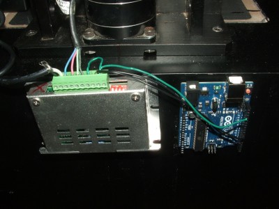

Today I connected the board to the motors and fine tuned the settings, by sending $$ over serial, it lists settings,
for example X steps/mm is $0=100, would make the number of steps for X axis 100.
$1 is Y, $2 is Z, and so on, no need to resend with arduino ide.
the blue ice stepper drivers do not get warm, but I have not set the amps above half way, I had intended having a small fan, but it looks like it is not needed.
I have a PC power supply with the green wire tied to ground to enable it, will put a switch on eventually, when the panel is added along with some LED's, nice to have some LED's here and there to make things interesting.
The tilt and slide is working well, limit switches have been added but not wired yet, next is a base plate for the whole thing, with a sub plate for the projector to be able to slide it forward and backwards to align and focus the single element lens.

I have had my 3d printer powered by grbl doing dry runs, that is to say, no resin.
the settings take some time to fine tune for smooth operation, one is $7 enable,
normally after a move the motor power is removed, this is ok for leadscrews but
my worm and wheel vat was loosing position, so I set $7=255, which leaves motors
powered on, they only get slightly warm so no problem, the current adjuster can be
lowered if things get to hot.
still need to configure endstops for homing, and I think I now understand the invert mask,
so will invert the z motor direction.
