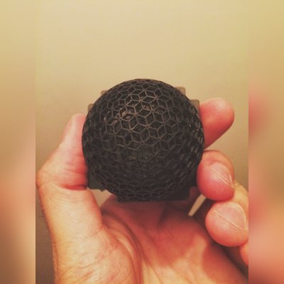

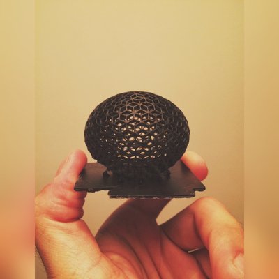

Hey guys,
I recently finished my printer but I still have some issues with the z-axis. All my prints are out of shape on the z-axis. I'm using a Dell M115 HD, Ramps 1.4, Pololu stepper driver, Nema 23 stepper motor (
http://en.nanotec.com/fileadmin/files/D ... 1008-A.pdf), 16mm Rod (4mm pitch per rotation) and 1/16 micro stepping with configured 800 steps per unit with the modified mUVe firmware. Does anyone have a clue for me?
Layer height: 0.1mm
First layer time: 20 sec.
Layer time: 15 sec. (the projector has just 450 Lumen)
There is no wobbling on z. There seem to be no problem if I move z manually.
What do you think?
Thank you so much!
And please just ignore the cracks on the base plate.

Okay, after printing 60 Layers of .1 mm (dry run) I can actually measure a height of 6 mm. I don't get it. Everything seems to be correct. Could it be a projector issue?
Re: Issue with the z-axis
Posted: Wed Jul 08, 2015 4:26 pm
by JohnGay
At a first guess: If that ball is supposed to be round, but the Z axis measures correctly, maybe you have the X-Y axis wrong?
They are supposed to be the measured dimensions of the projected image, not the resolution of the projector.
Otherwise, maybe the ball is getting squashed somewhere in you software path?
Posted: Wed Jul 08, 2015 6:21 pm
by PacManFan
Check the projected dimensions of the X/Y axis. Measure them with a ruler and make sure that the correct resolution is selected.
Posted: Wed Jul 08, 2015 7:32 pm
by mxmlan
Wow, I actually forgot to check that. Thank's PacManFan & JohnGay!
