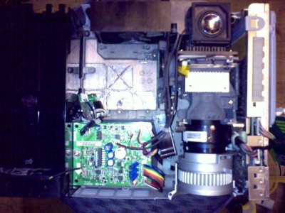

hp vp6121
on my projector, where the lens joins the housing, (4 screws on mine), I added 4mm spacers to bring the lens further away.
the screws may need to be replaced with longer ones, or you may be lucky, some people cut a plate spacer which would
keep dust out, the 4mm may need a bit of experimenting with.
I am trying to replace the lens altogether, with a single fixed lens, as the zoom focus has at least 3 elements, which reduce the UV somewhat, but
not sure if its worth the effort.

I did the identical modification to my Infocus 2104. I detached the lens, and I 3d printed a 3mm spacer to move the lens farther outward.
