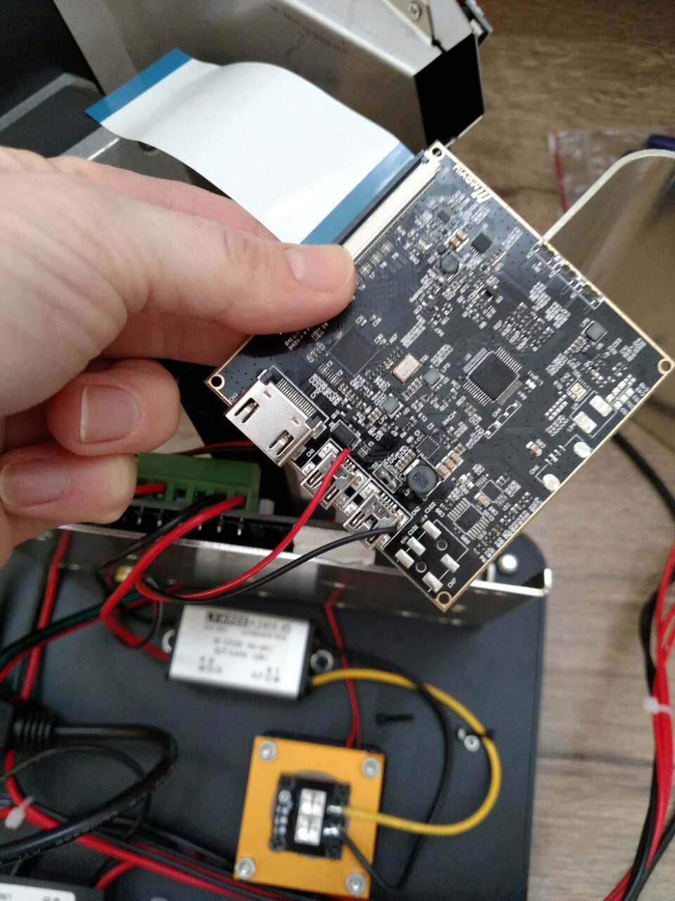

I have found the problem.It is a display card.It doesn't work constantly.If I touch HDMI cable it works...I will try to repair it.And I have found the resistor to risen the voltage to the step motor.I have made DIY printer before-fdm .It works.So, I can see this printer is not so complicated.But it is not robust.I would like to make some amendments to mechanical part.... But I need to repair this damn display card..

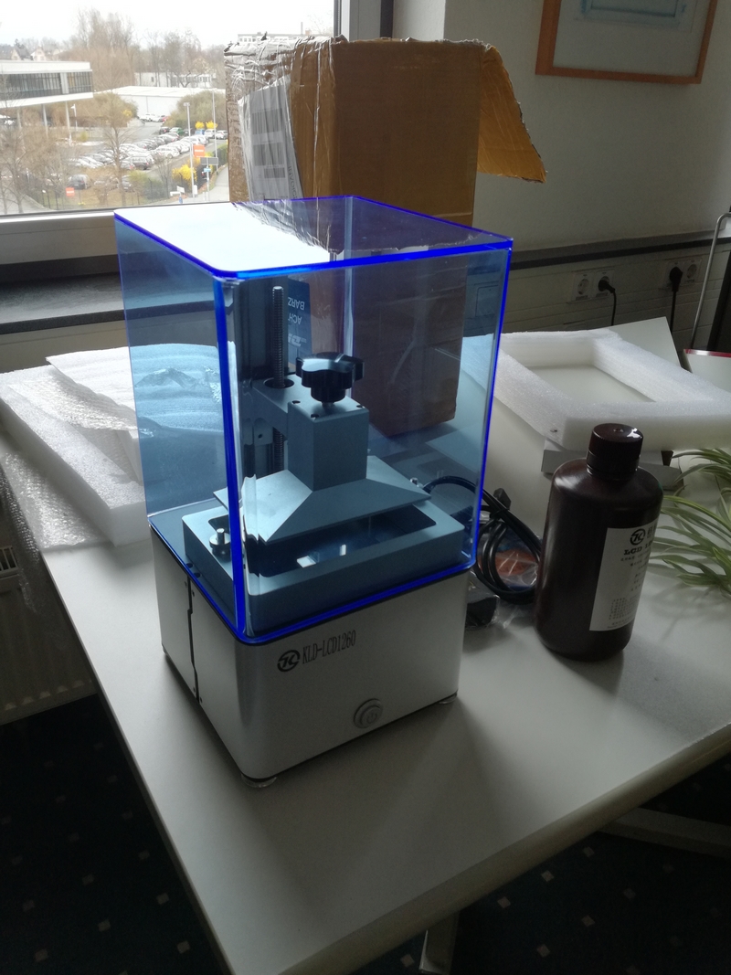

I just got my printer today and it's blue! Oh well, looks kinda nice.
But: I noticed there is no glass to attach to the platform. I contacted the seller and he said - Quote: "We do not sell glass anymore. It has been improved." And his answer to my follow-up question: "How can I level it then?" was: "Because do not need leveling anymore."
Just a visual inspection shows that the platform cannot possibly be leveled as is. Now what? ^^
He is going to send me the manual tomorrow, i got the raspberry pi version and i would like to make sure to do everything the right way and not meddle with it beforehand.

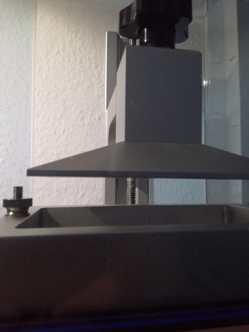

Dr. Woo, oops yeah you're absolutely right - for some reason i thought the leveling was done by the glass on the build plate much like a heated bed on an fdm-machine. But still, does it make sense not to have the glass? Does anyone of you have a link to the manual with the raspberry pi version so i could get started today? The link in one of the first posts is dead.
