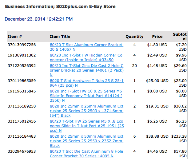

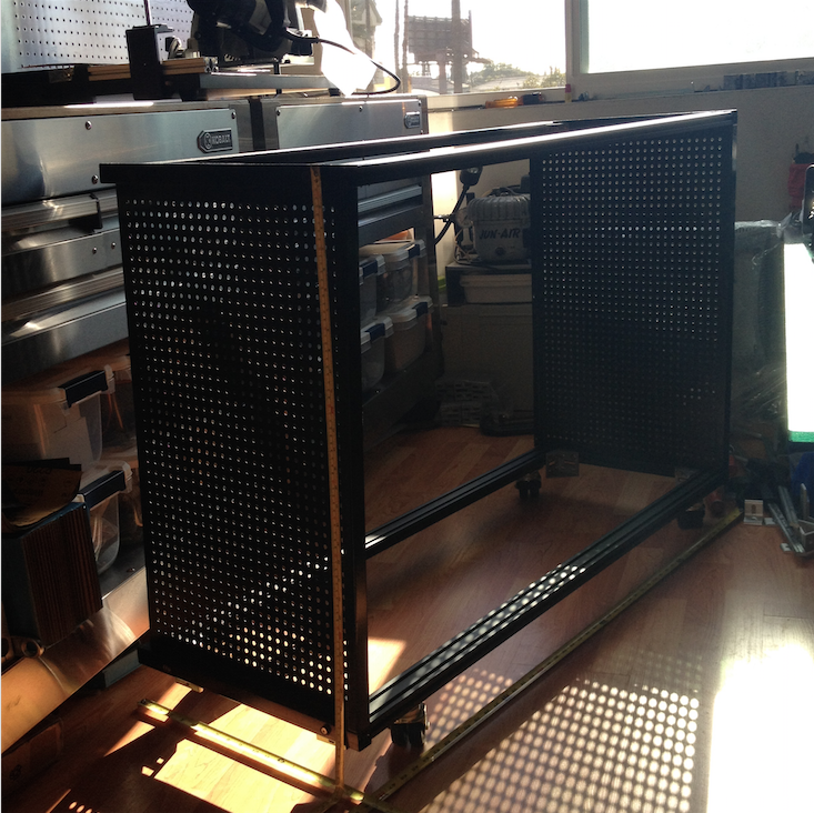

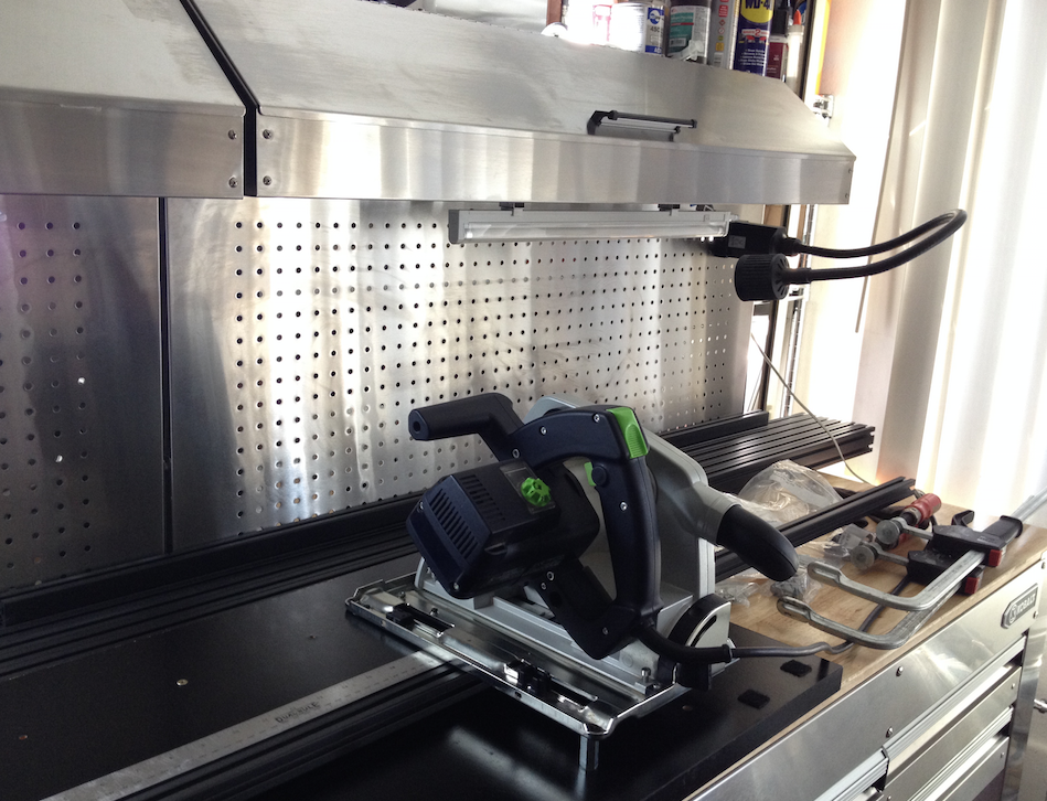

Finding the proper hardware for 25mm series extrusions is bit of a challenge, here in USA. I made the best fit by utilizing 80/20 30 series brackets by splitting into two units. the whole frame assembly is going to be completed in about two weeks.
A simple DIY jig; and a fixed plunger saw was used to make the precise cuts of extrusions.

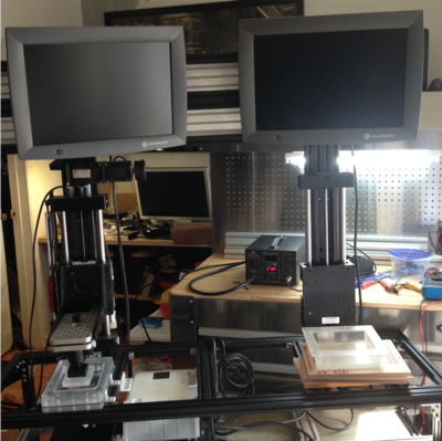

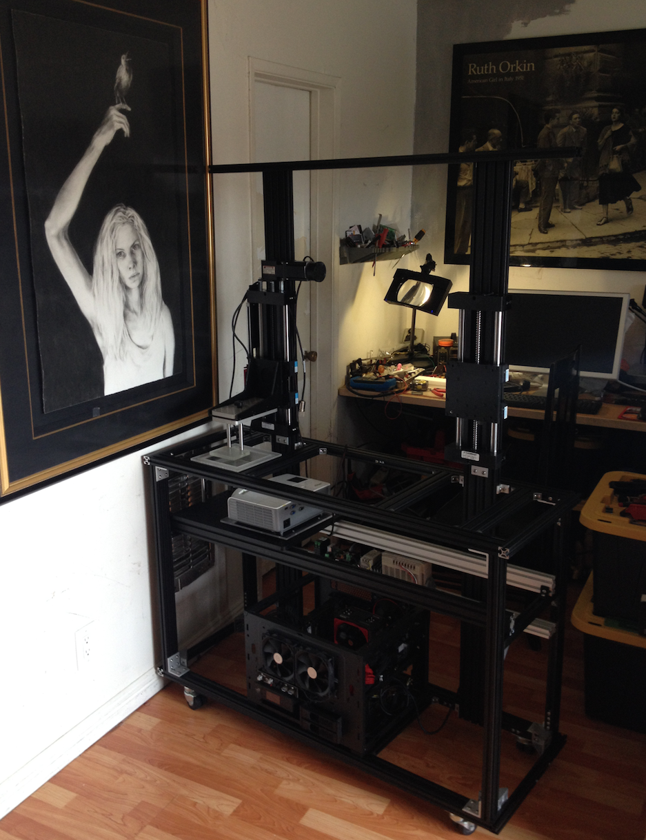

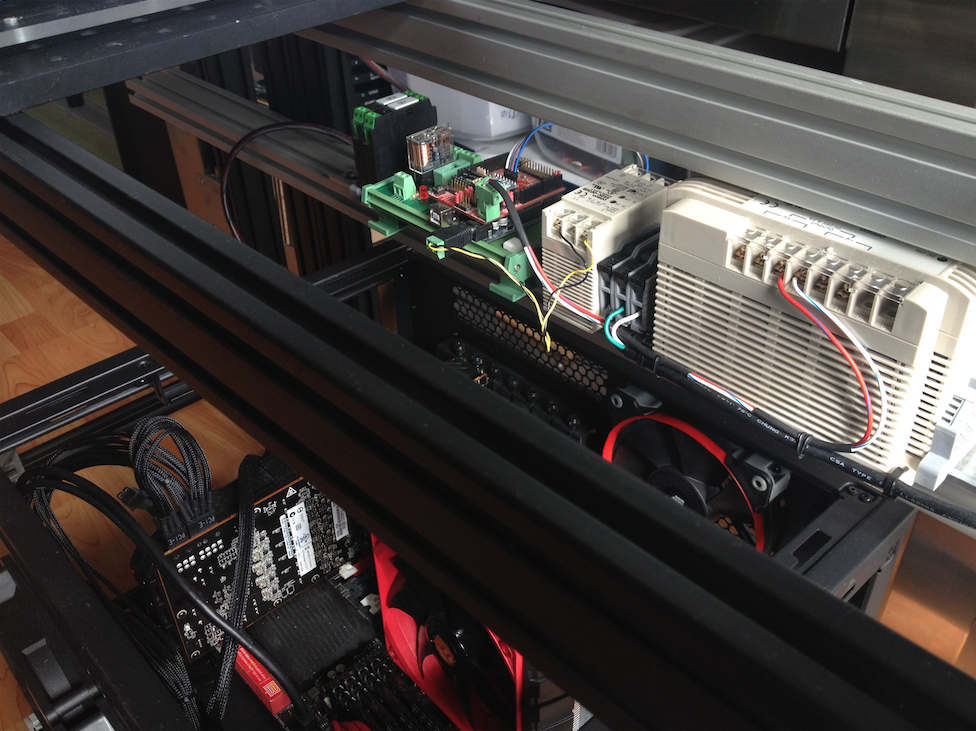

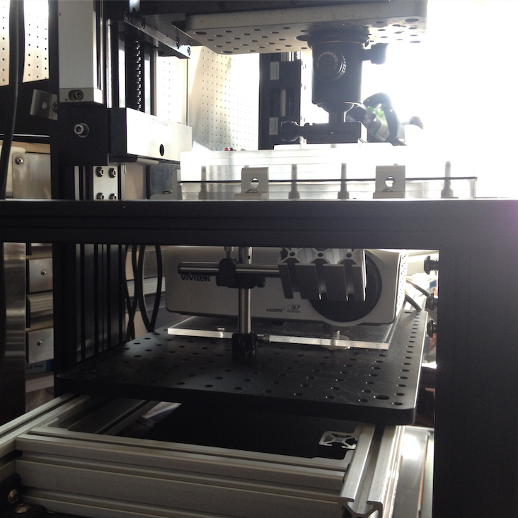

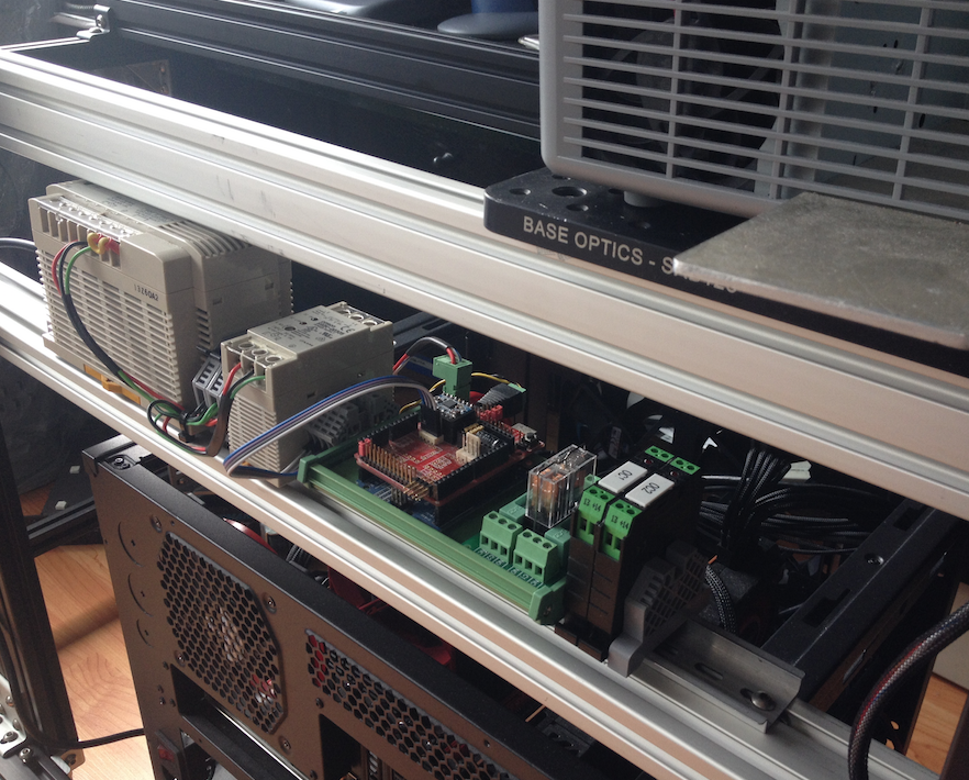

Complication of Part-one, Photographs, and moving onto the integration

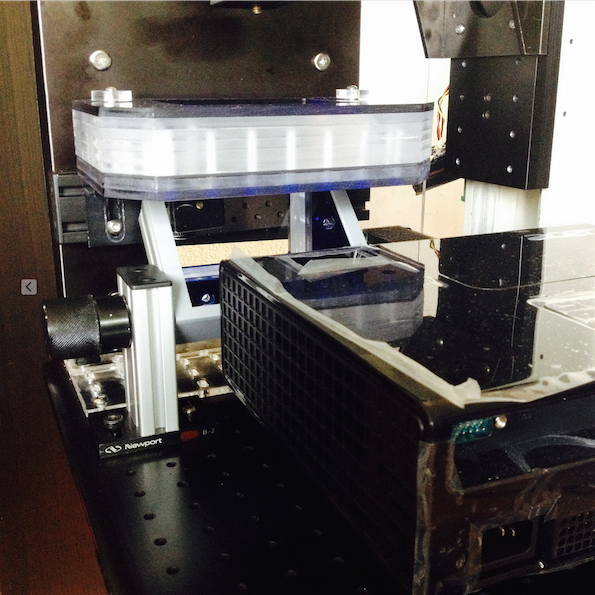

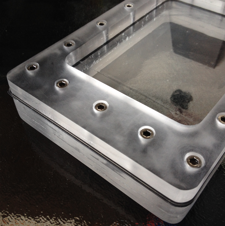

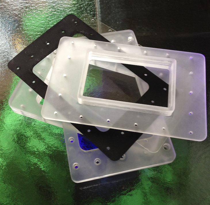

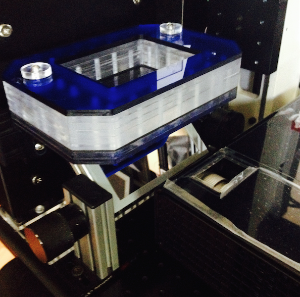

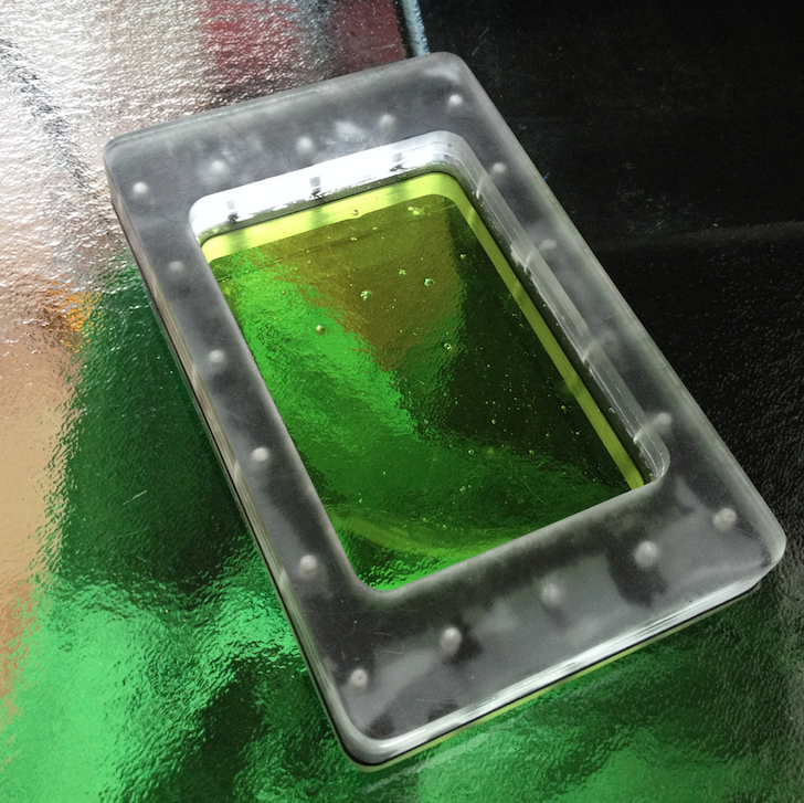

This is a sectional Vat, and the FEP film is sandwiched with a gasket. The structure is interchangeable, with a flex or rigid base.
