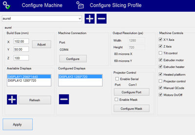

Hy there. I am building (actually finished) a top-down dlp printer. Everything seems to go ok except one thing. The software only sees the Acer H6510BD projector as 720p, seriously limiting the print resolution.
I have tried all there is to try. I modified the machine profile manually but of no use. Even if I set it up as 1080p the projected image gets much larger athan the print area so I cannot print.
Is there any solution to this ? The projector is connected using HDMI. Unfortunately I don't have a port on the video card for VGA.

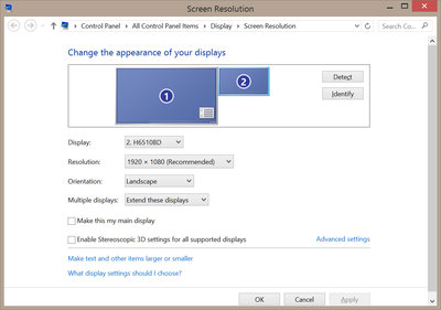

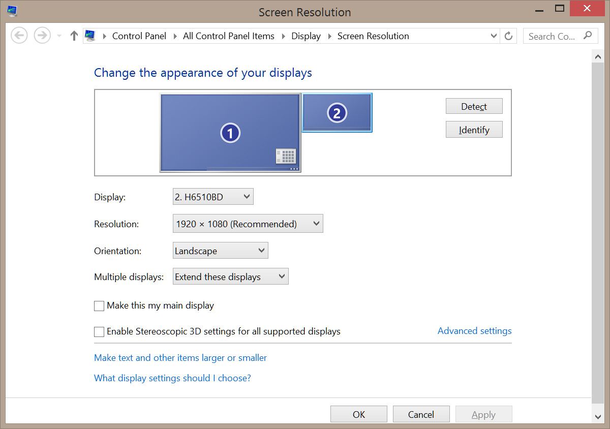

Hi.
Yes, in windows everything is ok. Actualy in CW all displays are misrepresented and the image is pixelated as if the internal frame buffer is much smaller.
Here:

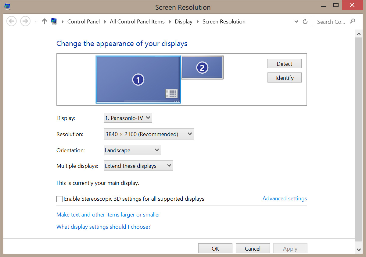

Lol, I think I got it.
It was because of display scaling in windows8. i am using a 4k main display and it is impossible to use it with windows standard scaling. Is there a workaround for this ? As turning off scaling, signing out each time I try a a print is not the best way to go :p.
