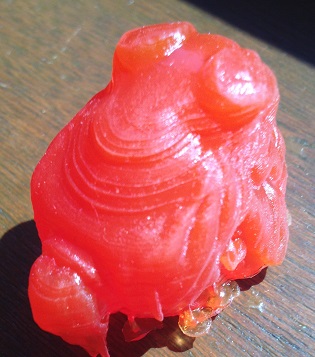

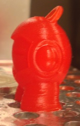

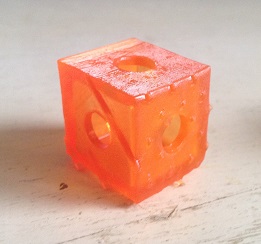

These are some pics of my crappy prints, just to give you an idea of the trouble I'm dealing with:
2014-10-30 19.41.17(2).jpg (33.23 KiB) Viewed 65046 times

I can only see one photo, not sure if you uploaded more. I encourage you to make a thread in here showing off your prints! Even the bad ones! If you post lots of photos, we can more accurately identify whatever problems you may have, and provide references for others.

Alright, now I can see all 3 of your photos. I always use to upload my photos, then just link to those photos, rather than using the "Upload attachment" button.
I can tell you right now that putting RAMPs on your printer won't improve your prints at all... It looks like all of your problems are originating from either the projector or the resin (And all RAMPs does is make it easier to print at lower layer heights).
Your third picture is the most telling... That Marvin keychain is way squished! Double check Specifically the first three photos relating to the projector resolution. Also double check your 10mm grid. Every time I adjust my projector or move my printer, I double check the 10mm grid.
The roughness in your layers appear to be from light bleeding... What's your projection time and dwell time? What resin are you using? Did you add any pigment? How close is it to its expiration date? All of these are factors.

You were right! I took my projector out and reattached it to the frame and now my grid lines are lining up much nicer!
However it shut down due to overheating before I could make a print, have you ever had that issue before? I hope it's nothing that will become a problem in the future.
I'm going to try either tonight or tmrw night to make another Marvin print to compare the round nature of the print in comparison to the squished one from before.
I've gotten an IMGR account so I'll attach both my good and bad prints here in case you have any comments to make or suggestions to offer.
Good prints:
Bad prints:
