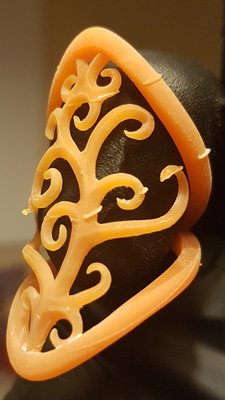

Thanks to the people in this forum I'm actually having success printing but I have one more problem.
I have horizontal lines in my print that appear as grooves then the slice above (or same slice?) is off center causing a ledge. I did a lot of searching but I couldn't​ find much, some about flexvat tension but that was before the acrylic plate was part of it so I don't know if it's valid anymore.
Only happened twice in this print but it was enough to notice and likely ruin one of my more detailed prints:

What kind of computer are you using, are you using it while printing? is power saving turned off? making sure not to bump the printer during printing? tight vats generally result in fine shift lines not something this severe. Do those layers flare out on the reverse side too? (ie. do the layers seem overgrown, or does a segment seem shifted to one side.

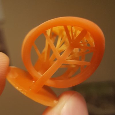

It's all working as it should be now, I did a few things at once but I'm sure adding horizontal(ish) support was what sorted it, tilting in 2 angles helped too. It was as you said, and the ring was splaying apart at a few points when going down to the flexvat. I just made them in 3ds max, it seems complex but it wasn't too bad to remove:

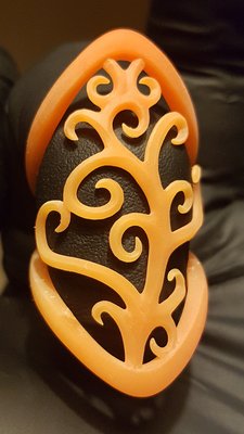

And the finished ring, no errors:
Thanks for all the help.
