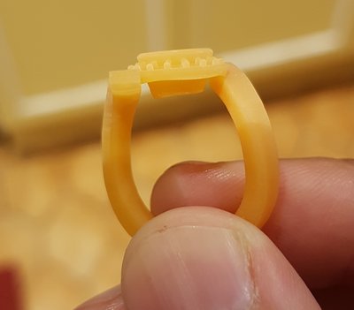

Hi all!
Using waxcast and encountering this issue on uneven builds. It also happens on B9 Yellow so must be a hardware issue.
Got any ideas on more accurate builds?
You can see the wavy bottom of the halo collet. I've noticed this on other prints too.

You should be able to solve this issue by tilting a few degrees on X or Y your model , just consider the first layer of the halocollet is/are very thin so it remain flexible , when you lift/peel and go back on you vat floor the first layers ( 1-3 depending on you layer thickness ) will be very easy to deform and keep some extra resin in between that will be cured ...
other option is to give a long settle time before exposure on those critical/sensitive layer.
