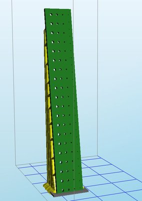

To tackle this I created a tall test part with graduated small cylindrical holes to monitor bleed at different heights (see below). I tilted this at about 15 degrees from vertical and ran some test prints:

Below is an image of the test piece I used for assessing changes in reactivity and z bleed at different heights. The bleed is seen filling the smaller holes.
