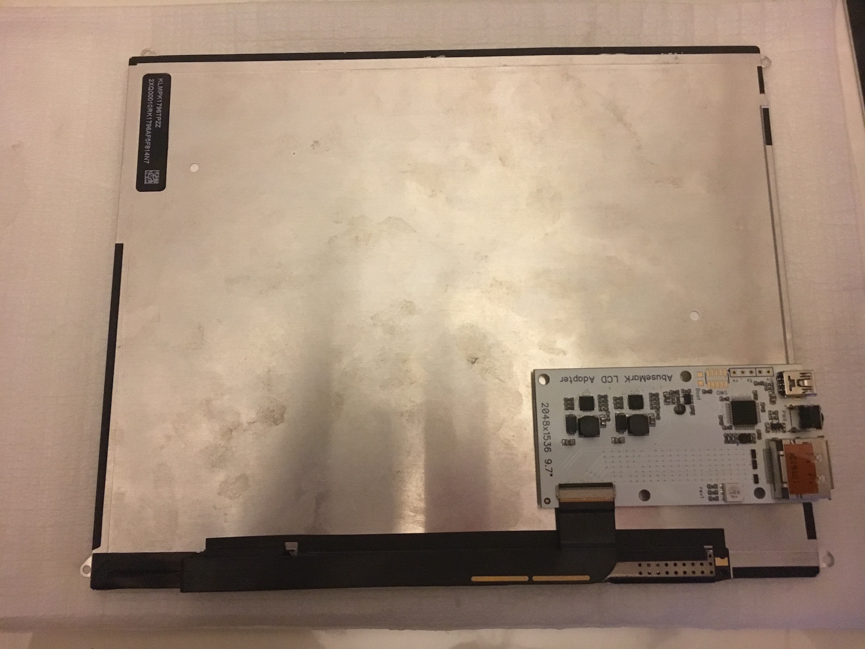

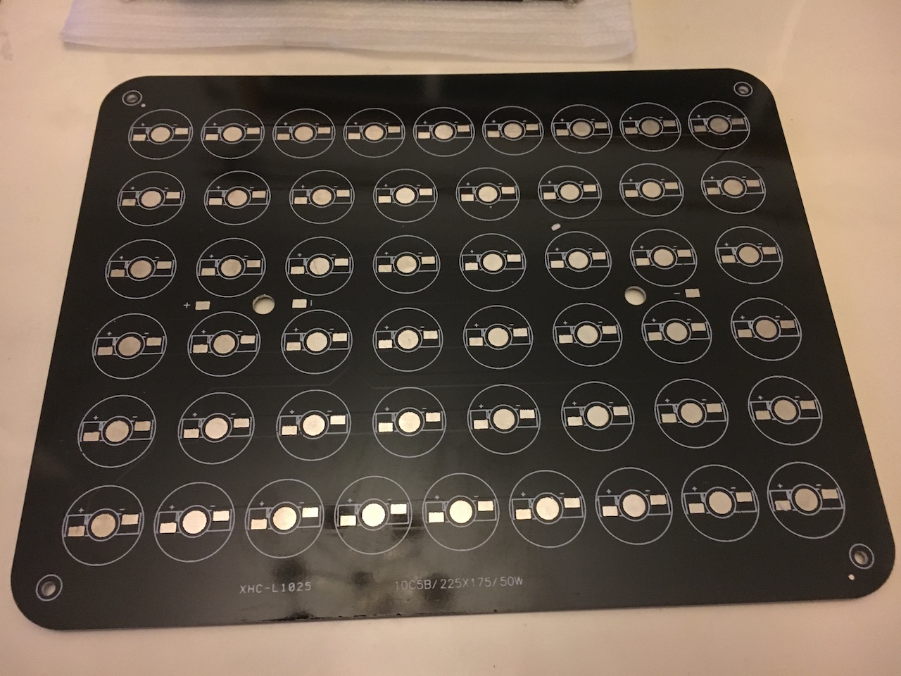

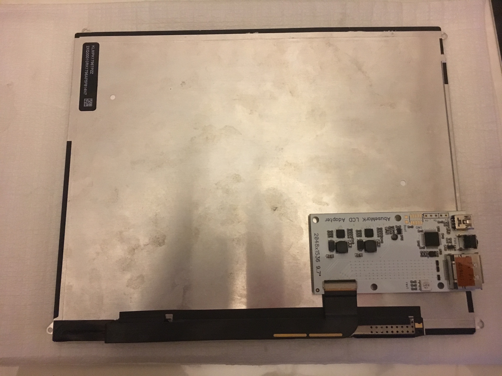

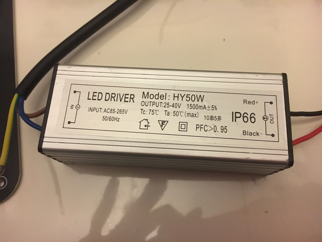

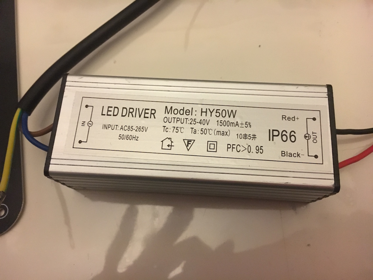

LED aluminium PCB and LED Driver arrived today.
my second iPad Retina Display with Abusemark adapter attached ,ready to be stripped down ...
460-470nm 1W LED and lenses / diffuser should be bought tomorrow.
Regarding the resin , I unfortunately have no choice , 60GBP only for shipping to Hongkong , they cannot ship to China mainland directly ...
Keep you updated .
