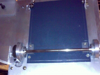

I have made my vat with tilt and slide, a worm and wheel, salvaged from an old piece of kit
driven by a stepper motor salvaged from an ancient hard drive, rotates an eccentric pin
to slide the vat and then tilt it down, the other end slides on small bearings.
At the present time I do not know what forces are needed, and if the stepper is up to the job,
but it would not be hard to fit a bigger one if needed.
underside of plate
I still need to cut the aperture for the glass plate, but will mount the projector in position
and mark on the vat the actual display area, then cut it out.
more info as I progress.

I'd like to see the worm gear you're using. I'm using a leadscrew drive mechanism on my machine. The stepper motor on mine is mounted on a tilting axis to arc back and forth while it pulls down on the bottom of the vat.

Believe it or not, I do not have a camera, apart from the phone one, but
the images are rubbish, so I ask the wife to use her camera, then I will post images,
which will explain better than I.
