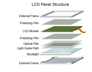

Reading the info, it seems that the polarizers, or at least the second one, allow us to see the image, as
without it we see nothing, I have not yet got my head around wether it would cure resin without the second polarizer,
ie, is an image formed but not visable, or no image is formed????. (I think maybe no image)
this site gives a bit of information. http://www.lcd-parts.com/polarizer.aspx
and this one, http://www.gizmag.com/stealth-computer- ... ses/29700/
lcd structure

it seems that the first polarizing filter is used to set the direction of the light where as the second filter is twisted at 90°, so the light doesn´t travel through the screen. the lcd unit just switches the light at 90°, something like a direction-mirror, so that it can pass the first and second. in this kind of way, the whole screen can be black and partially be enlighted by the backlight.
polarizing filter seem to block light at frequencies lower 400nm, thats why i didn´t had success with 365nm energiesaver bulbs. so the clue seems to be to rip off the uv filter at the first polarizing filter, use somewhat high power lighting (keeping in mind my screen is a tad larger then Din A4 paper) i´m going with 30x3W led (405-410nm) and get some good polarizing filter followed by resin able to cure at frequencies slightly above 400nm.
i have just to discover tomorrow if the width of the polarizing film has any influence on the light power, e.g. the smaller the width the less waste of light power.
