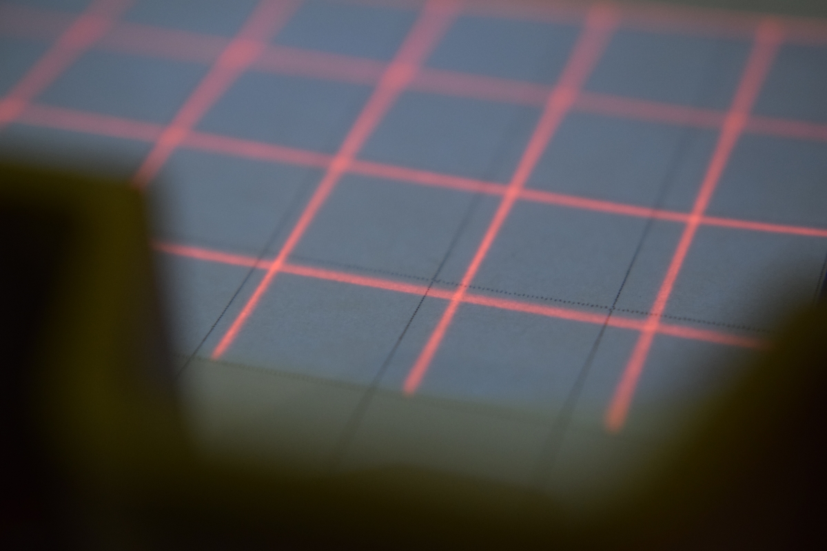

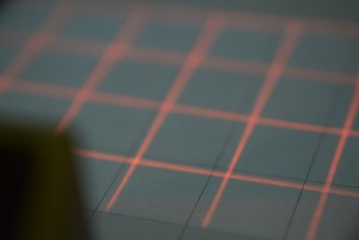

how can i solve this issue please?
Re: Please help !
Posted: Fri May 26, 2017 8:08 am
by cooly
Are you asking about the different grid size between projection and calibration?
Re: Please help !
Posted: Fri May 26, 2017 8:24 am
by Nitros
yes, in some point, square are the same size, in others not
Re: Please help !
Posted: Fri May 26, 2017 10:34 am
by cooly
Are those images after mirror or just in front of projector? If the mirror is not well aligned, it can happen. In case of without mirror, there should be some misalignment with projector optics.
Re: Please help !
Posted: Fri May 26, 2017 10:37 am
by Nitros
thanks for the reply, no mirror, the projector is seted at 0
Re: Please help !
Posted: Fri May 26, 2017 12:00 pm
by cooly
If the projector lens is parallel to the screen and you still have the uneven grid spacing, it should be a problem inside projector optics. I'd return if it's new. If it's used one, I'd open the lid and look into if there is something misplaced inside.
