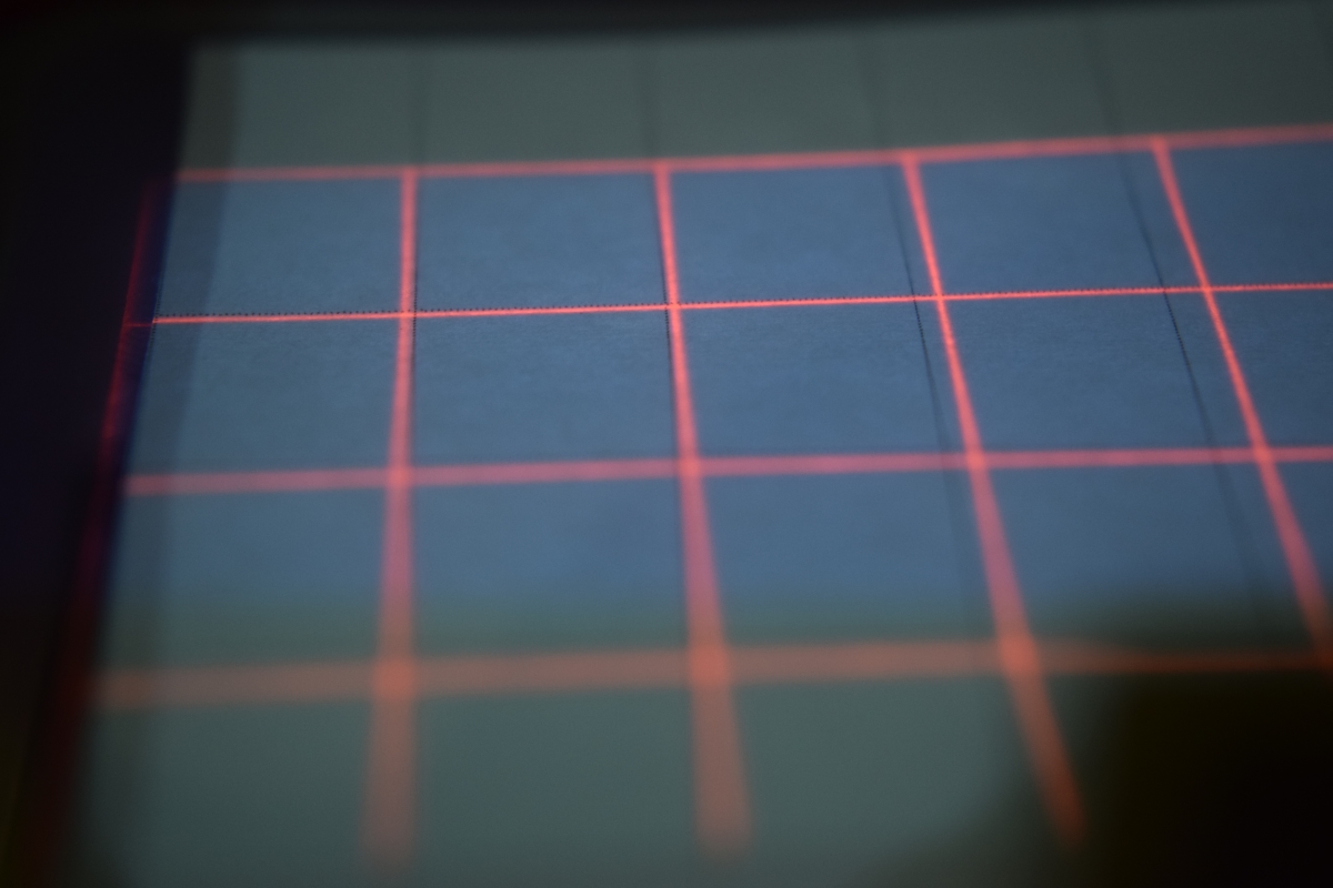

how can i solve this issue please?

Are you asking about the different grid size between projection and calibration?

Postby Nitros » Fri May 26, 2017 8:24 am
yes, in some point, square are the same size, in others not

Postby cooly » Fri May 26, 2017 10:34 am
Are those images after mirror or just in front of projector? If the mirror is not well aligned, it can happen. In case of without mirror, there should be some misalignment with projector optics.

Postby Nitros » Fri May 26, 2017 10:37 am
thanks for the reply, no mirror, the projector is seted at 0

Postby cooly » Fri May 26, 2017 12:00 pm
If the projector lens is parallel to the screen and you still have the uneven grid spacing, it should be a problem inside projector optics. I'd return if it's new. If it's used one, I'd open the lid and look into if there is something misplaced inside.
