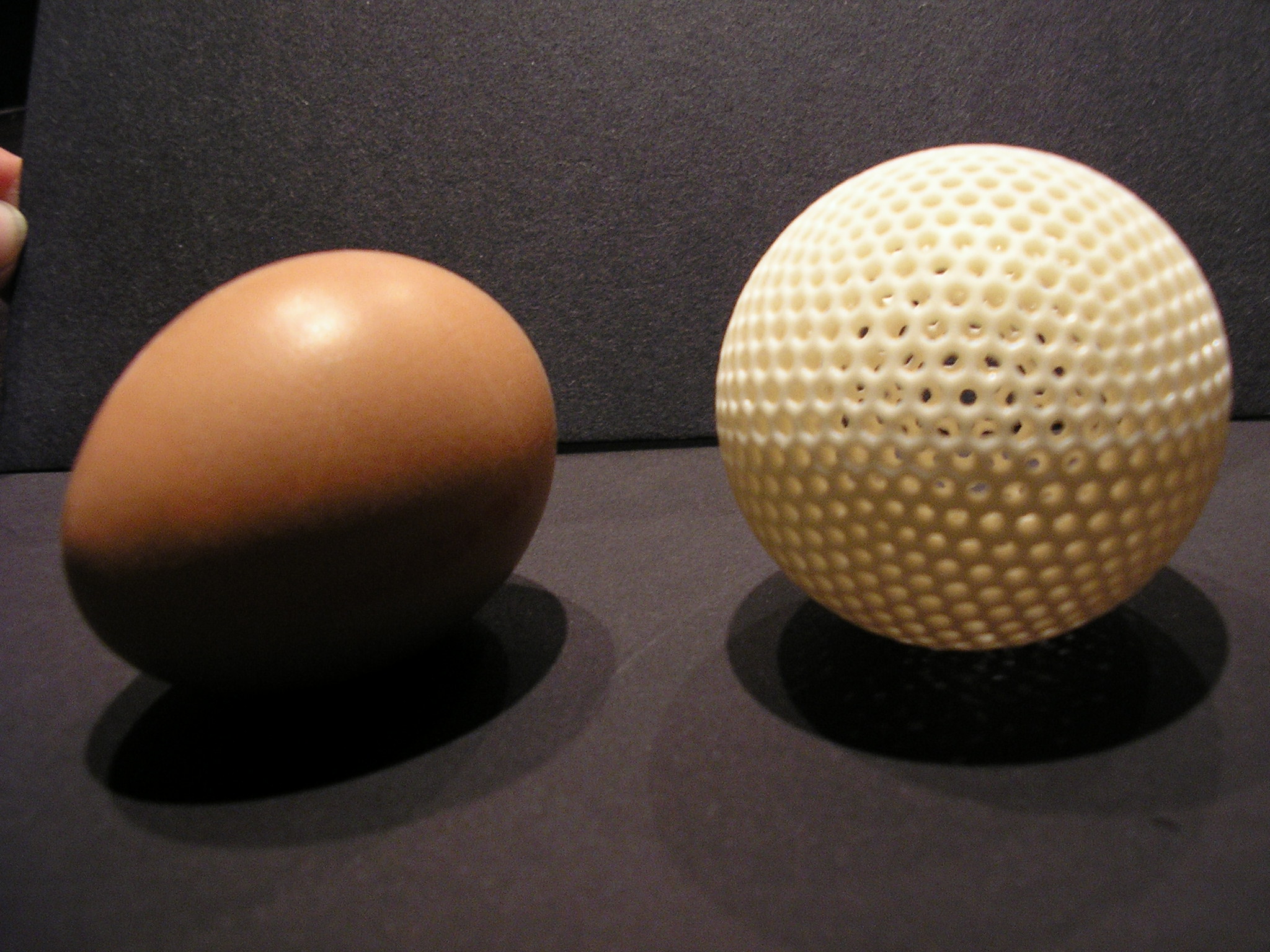

that passive release looks like it's working very well. This is the pillow vat design, correct?

Very nice! For a while I thought about building a belt driven printer and was discouraged by the amount of force needed to release the part from the tray. It seems like your printer works smooth and effortlessly.
On a funny note, for a second I thought you had printed the egg as well!

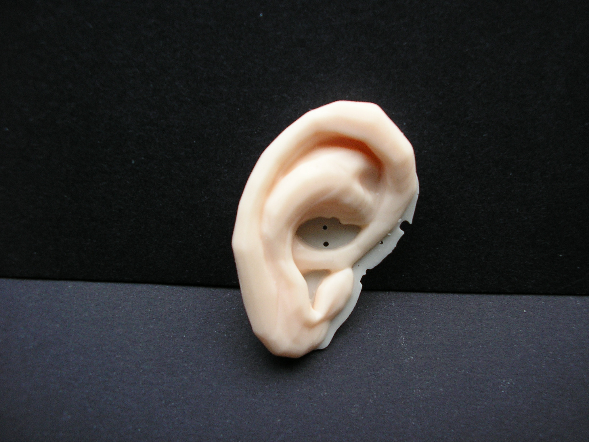

Re: my DLP build
Here is my latest print. actually it was an print assignment.
color came out great, the STL file is undetailed, low triangle count
Resin: Mixed SubG+ and SubFlex
24 micron xy
50 micron z height
print duration: 30 minutes
