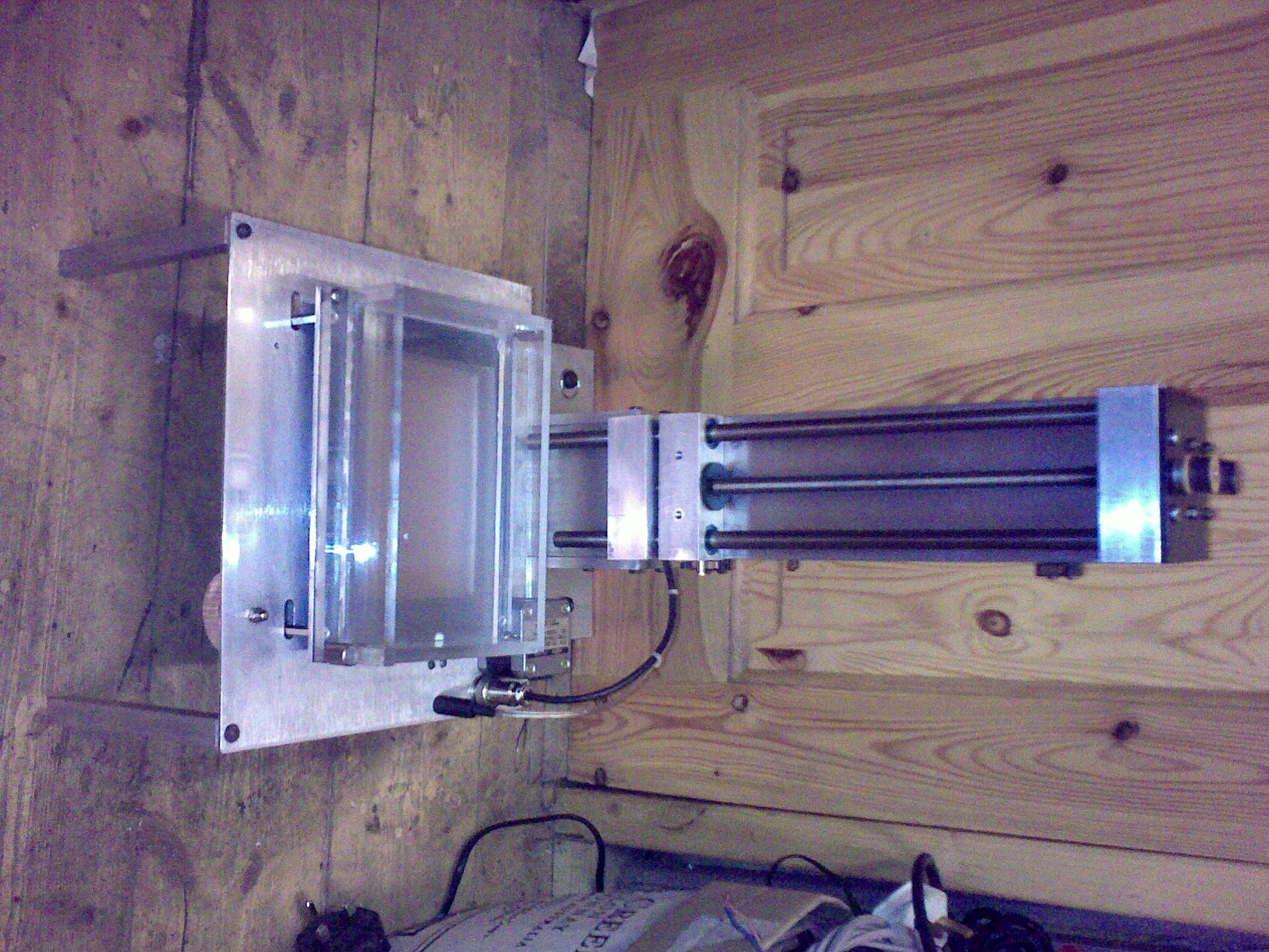

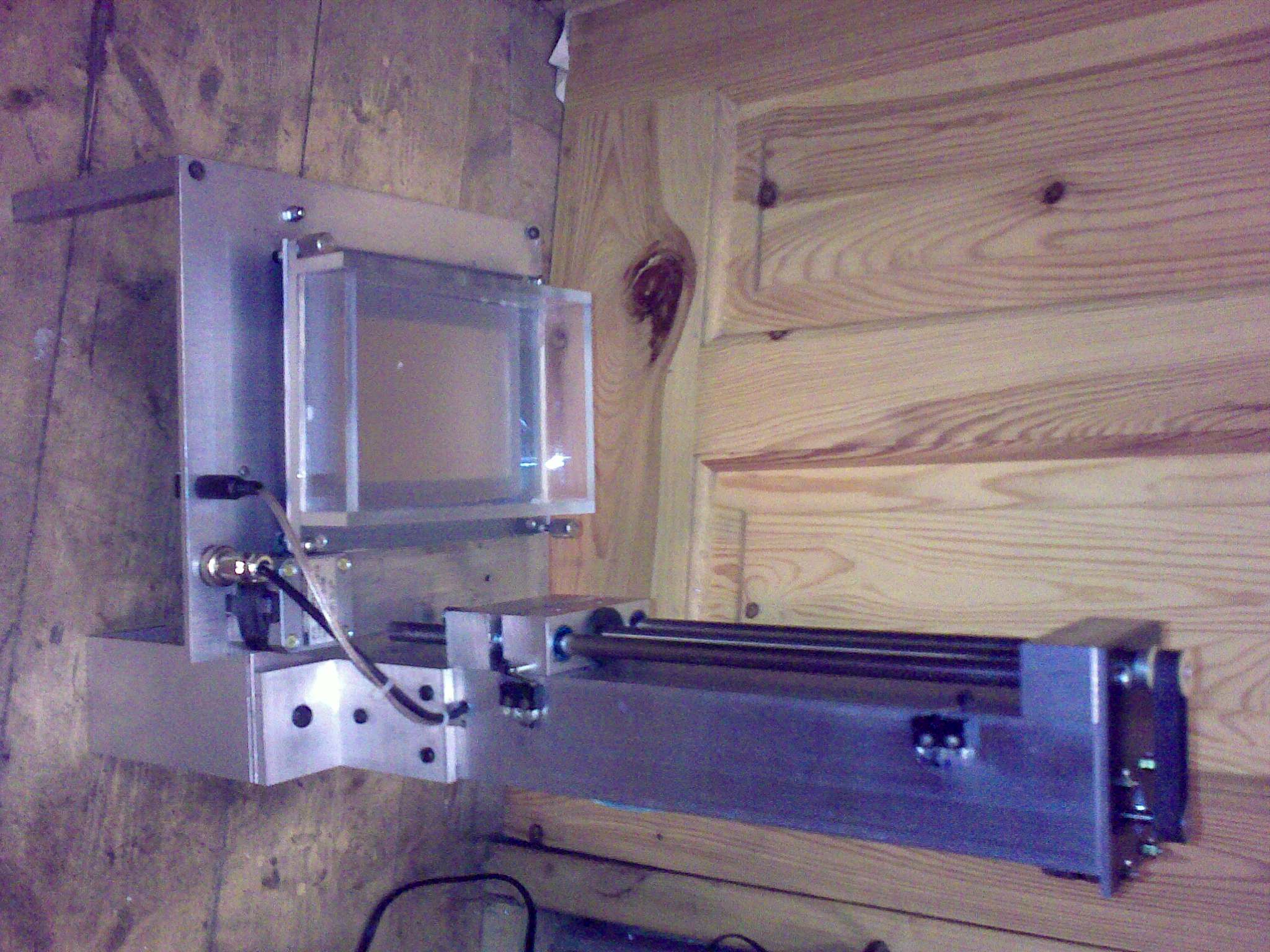

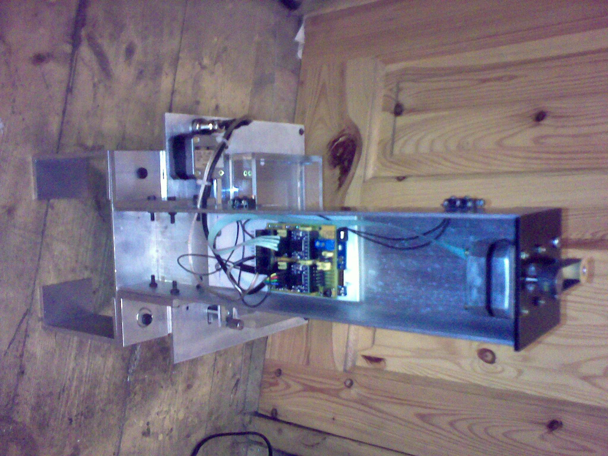

I have put a lot of hours in the shed, but on a project I have been working on for 2 years, anyway some rubbish images of the build.
sorry, forgot to rotate them.
The z axis rods are genuine stubbs silver steel I have had for some time, not hardened, but should
last for a while, ball bushes, and 3/8 bsf threaded rod leadscrew, (.050 pitch) also had this for some time, its a lot better quality than the studding these days, the leadscrew nut is made from oilon, "nylon cast with a lubricant", no backlash and very smooth.
The z axis is a piece of ally channel, 3"x2" and made to fit the stubbs rods without cutting them,
down, the rod holders and slide were bored on a milling machine.
the motor is salvaged from who knows, it has a resistance of 4ohms on the windings, so pretty powerfull for its size.

Postby Finhead » Sun Feb 09, 2014 1:30 pm
I think it looks great. :)
What is your VAT made of Plexi? And your tilt mechanism I assume runs of the smaller stepper on the side, any info on the actual linkage etc?

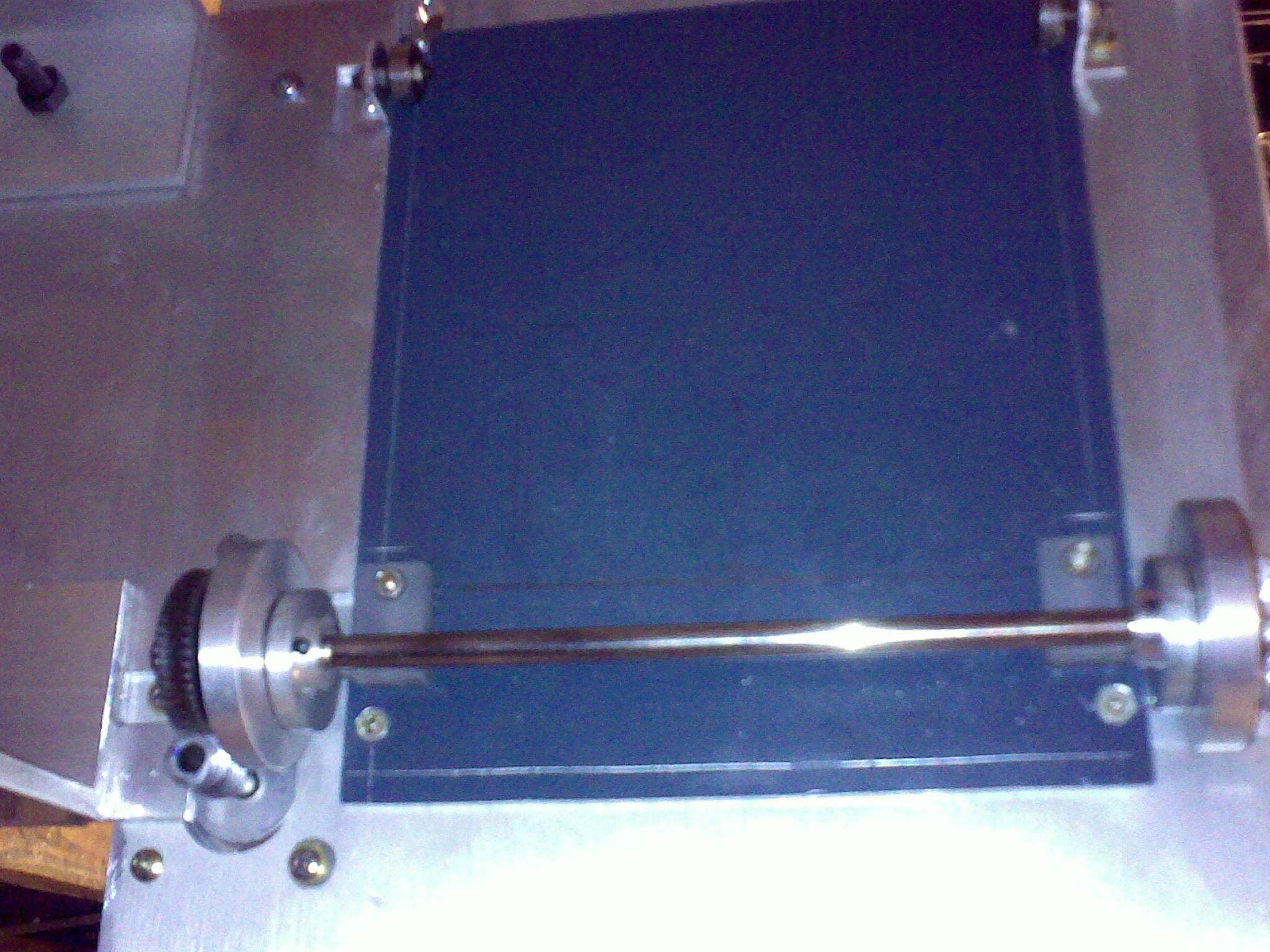

I made two vats, one from ally, the other "shown" plexi, the tilt /slide image is in another thread, but here is a copy showing the underside, it moves in a nice sideways and down action, but not sure if the motor is strong enough yet, with everyone saying that lots of force is needed, but should not be a problem to fit a bigger motor.
Its driven by worm and wheel, salvaged of course.

Re: DLP 3dprinter build
Postby Finhead » Sun Feb 09, 2014 5:33 pm
Thanks for explaining John :)
I'm going to try a passive tilt for now but yours looks easy enough to add after if needed, nice job on that easy to fallow design.
