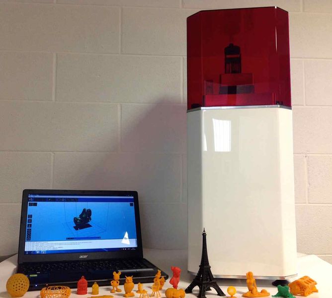

I'm Jody and I'm italian and after one years of work and test i made my 3d printer, called Totem3D.
the dimensions are 280 x 700 x365 cm and weighs 21kg. is made of machined aluminum with CNC machines and plastic outer cover.
the max print size are 102x77x130mm and i use a 1024x768 DLP projector.
the resolution is 0.1mm for x/y and 0.05mm in Z.

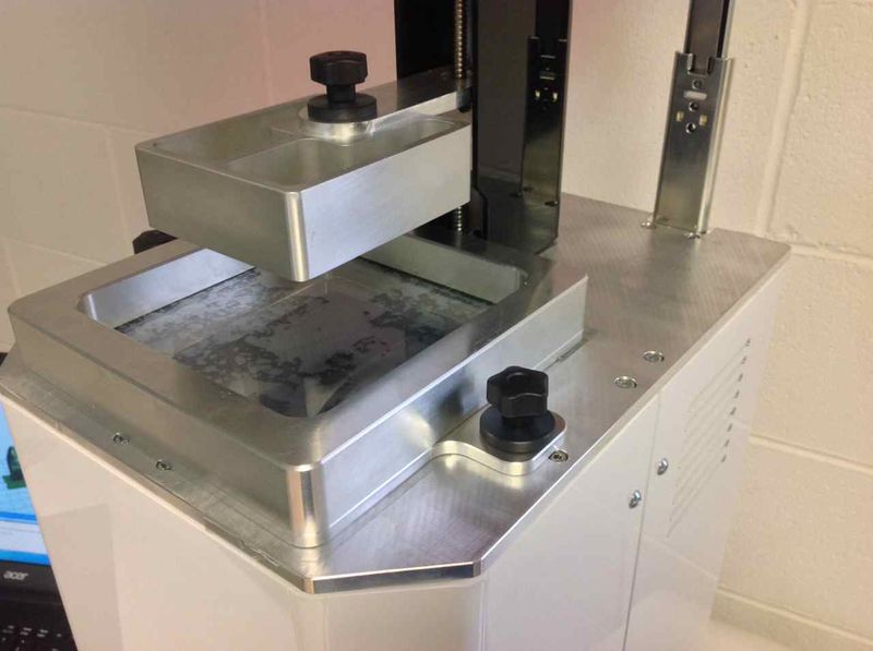

the vat use a little rotation slide for help the detachment of the piece and fep film in the bottom of the vat.

Wow very nicely built, looks very consumer grade.
Do you have any details on the build or a blog? Would love to see how you went about building it. Thanks for sharing.![Smile :)](./images/smilies/icon_e_smile.gif)

thanks.
I have Facebook page called "Officina Del Bianco"
