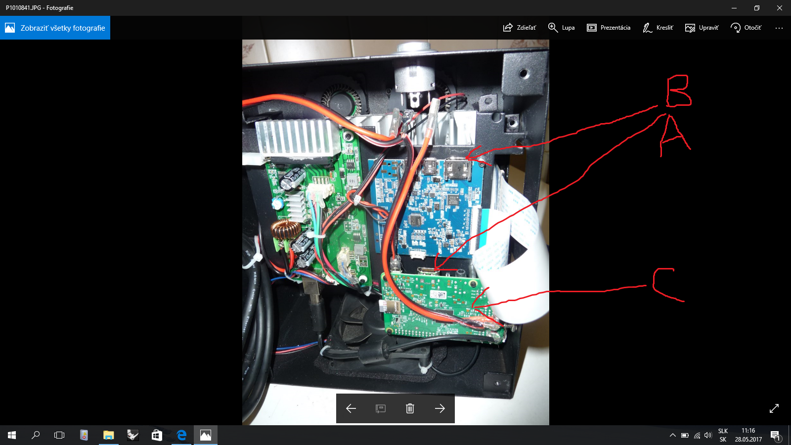

The machine now works well,
the only problem I still can not solve is to communicate nanodlp with the lcd panel, maybe for problems in the config file, or because I damaged the panel in disassembly

Well, I have modified Rastberry Pi config files for the display to work - to support the LCD resolution
You can even find it here viewtopic.php?t=5515&start=30
