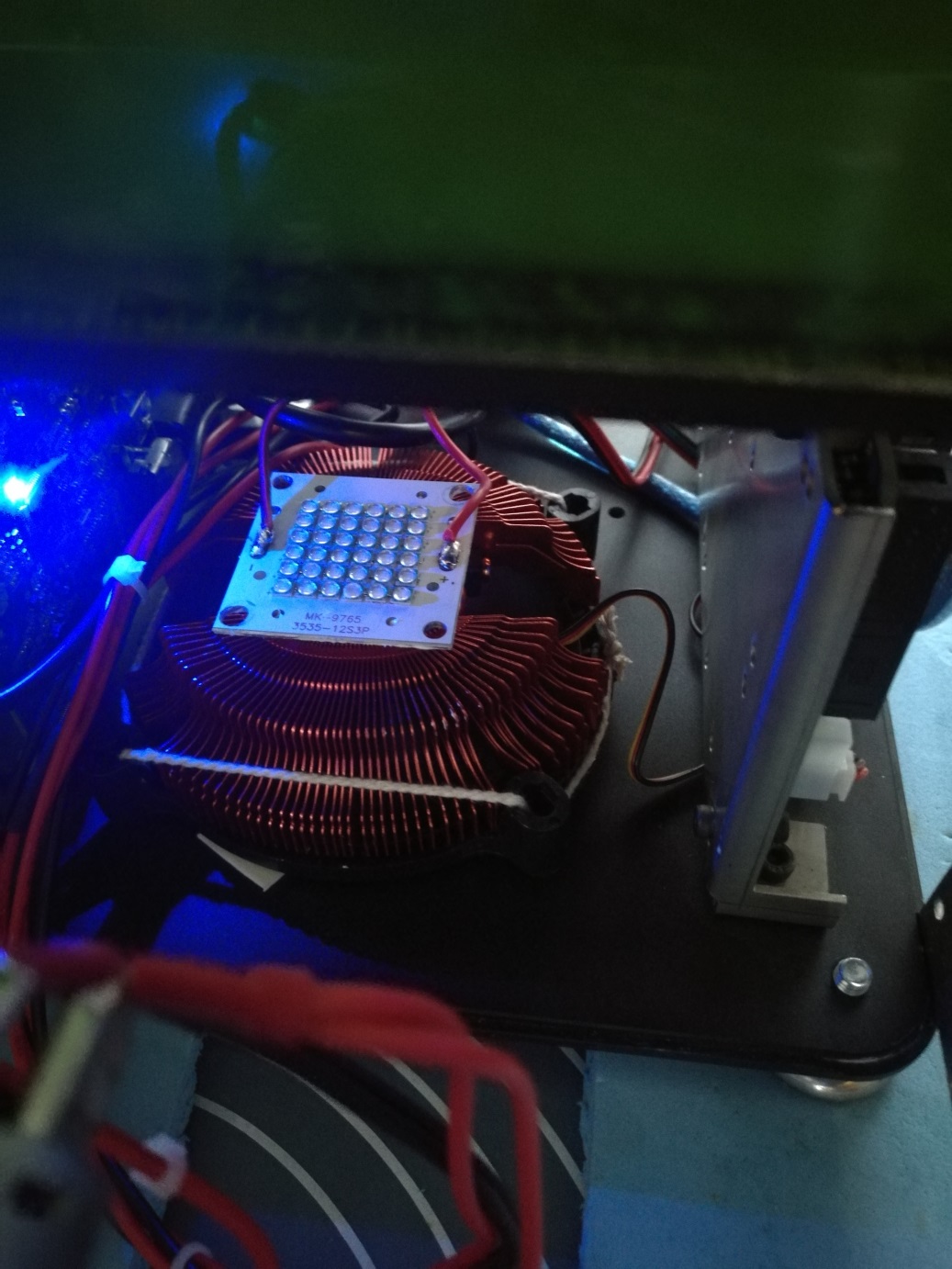

Upgrade 32W UV LED 405nm for KLD1260 with NanoDLP.
Hi, I have finish it.
- UV LED module 32 W 405nm at 40 Volts / 0.9 Ampere
- LED Driver MeanWell LCM 40 with dimming function 0-10Volts.
- 2 resistors as voltage reducer for the LED driver.
- CPU Cooler with sink lowest possible.
I was at 18 seconds / layers with my very thick resin from china, and now down at 6 seconds. without reflector yet.
I use the original output of the UV LED to control the driver LCM40. the output M106 S255 give a 12 volts output, so need 2 resistors of 220 Ohms and 1.5KOhms to downs the voltage to 10 volts, and connect this to the DIM connector of the LCM40.
Plug the 220 Volt and the new UV LED and voila.
I have to invert my front panel to place the switch ON/OFF up side down.
Will have to fix the driver on the back panel.
and drill some opening to give more air circulation.
As the cpu cooler is very large, every thing is cool down good.
Now lets see for the life time of the screen...
