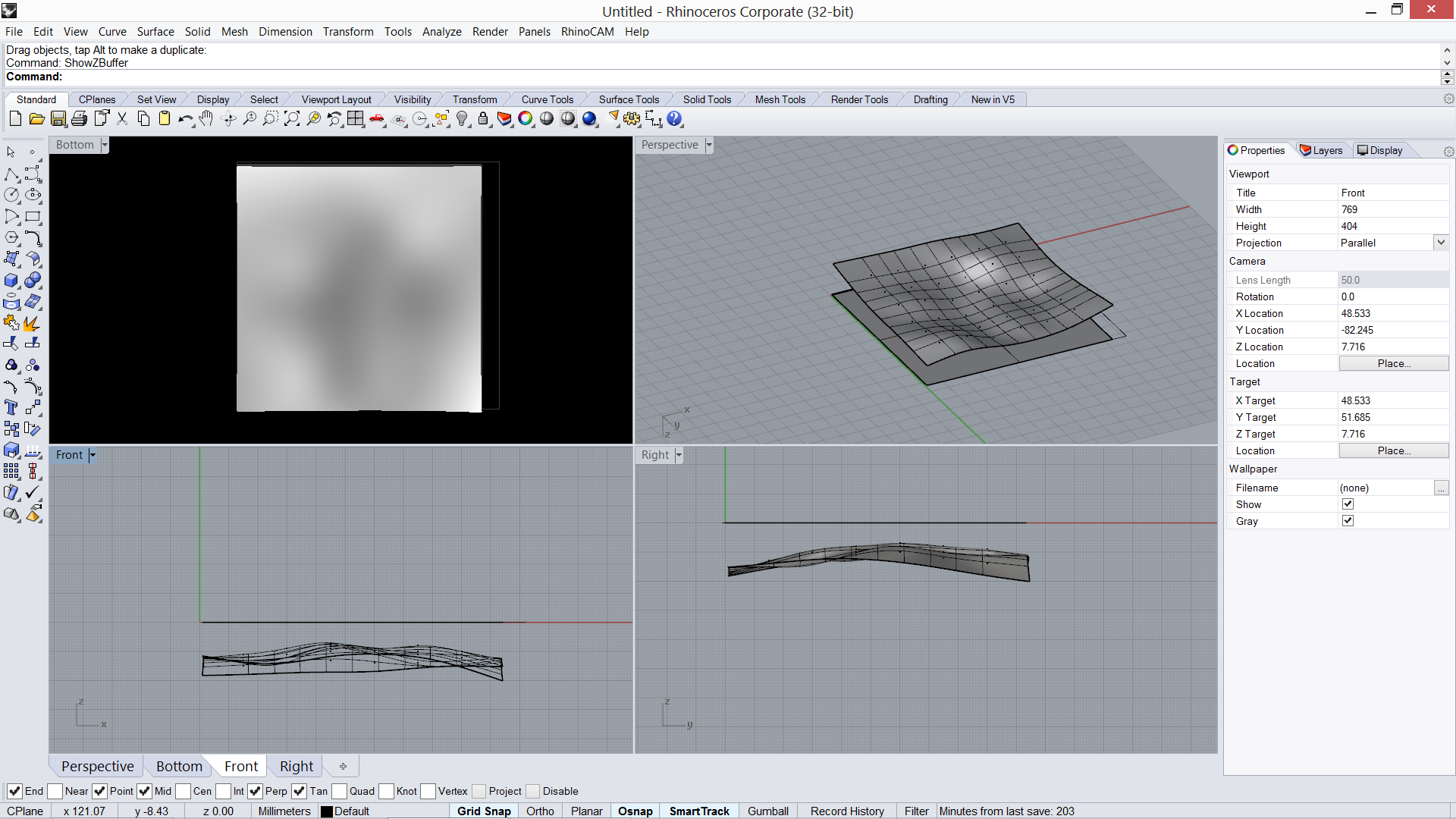

My current plan is make a png file of white dots on a grid and take sensor readings from that. I'll then input those as a point cloud in Rhino and use the "Patch" command to make a surface from them. I'll then take the surface and use the "ShowZBuffer" command to shade the surface by height (UV energy read by sensor" Then I will out put this as a .png Not the cleanest work flow, I'm sure there is a way to do this with software but I don't really have the time to put in to that right now...

Rhino picks the surface closest to the camera as white and the furthest as black. If you look in the screen shot you can see that I added a plane on the XY plane. By moving this plane towards our away from the surface you can control the amount of gradient on the constructed surface. I also made the surface then moved it below the XY plane and ran ShowZBuffer from the bottom view so the lower readings would be white. You could also just make your surface and put the plane above it. Hope that clarifies if not I can make some more examples when I get home.
