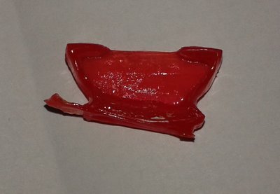

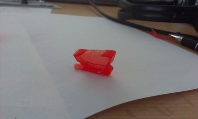

and the prints look like this if are tall then 10 mm
first print was meant to be a cylinder, but...

Did you check that the Configure > Configure Machine > Build Size > Z Setting is correct in CW?
Can you go the full 20cm manually (by pressing the Z axis controls in CW) ?
