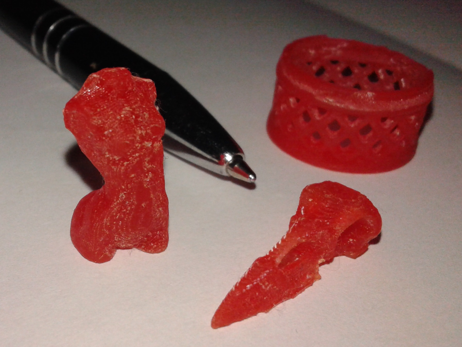

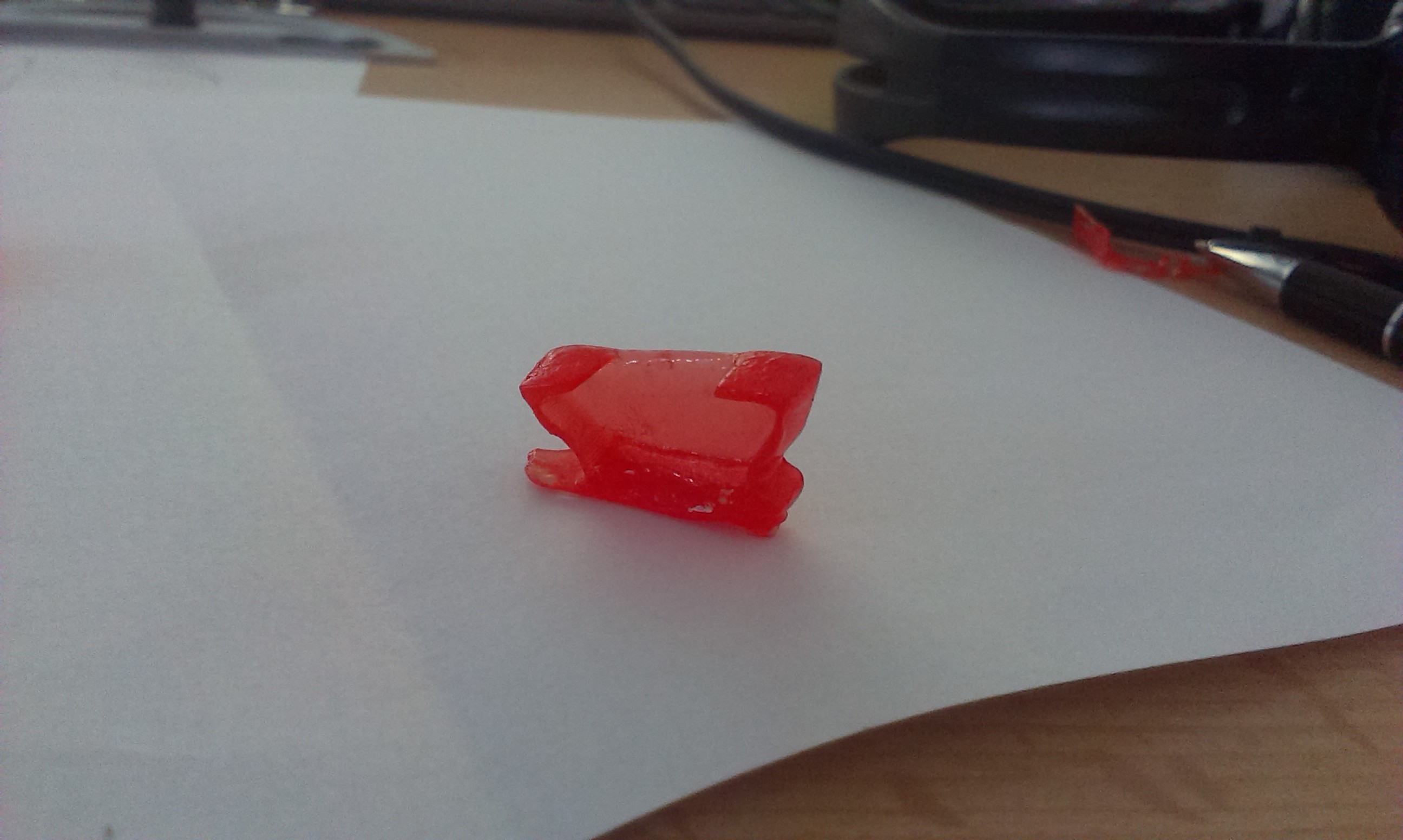

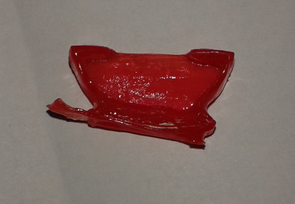

so, my problem is that on every print after 10 mm the z axis stops to rize, the print wont get bigger than 10 mm. the z axis will still do all the movements necessary to print but will not get bigger than 10 mm. any suggestions?
the print goes flawless, for the tests that i did till now, until reaches ~10mm, after that it won't grow,
i use megatronics v3, a top down setup, benq mp610, and a trapezoidal screw with 3mm pitch. and i use CW_Main_1.0.0.54
