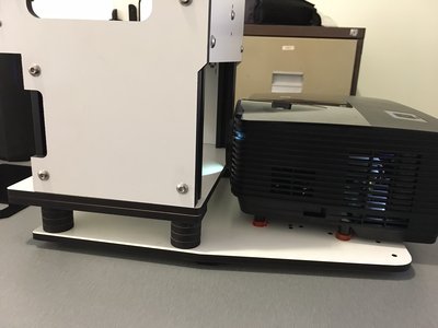

I have received my Little RP2 the extended height and build area version. Managed to set it up (probably incorrectly).
I have been using B9 Black resin, and the project is the Acer X152H

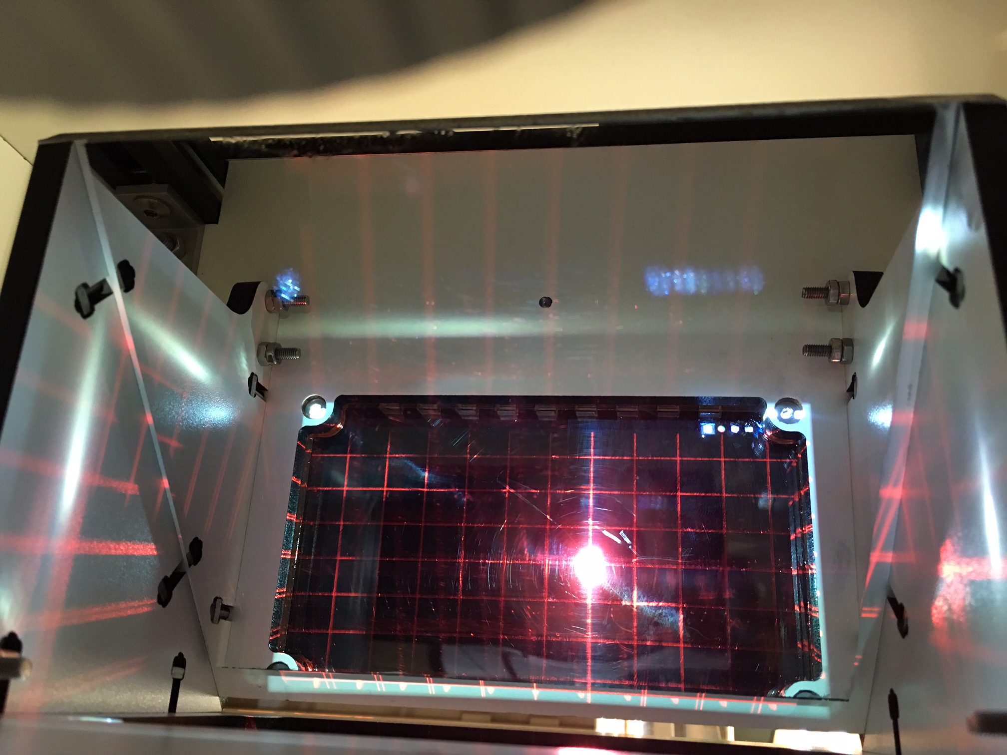

My main issue is when im trying to focus the projector (Acer X152H) i'm unable to get all of the focus lines square and to fit in the actual build area.
I also dont think i should have to have the projector like this.
And there seems to be a few to many left overs :O

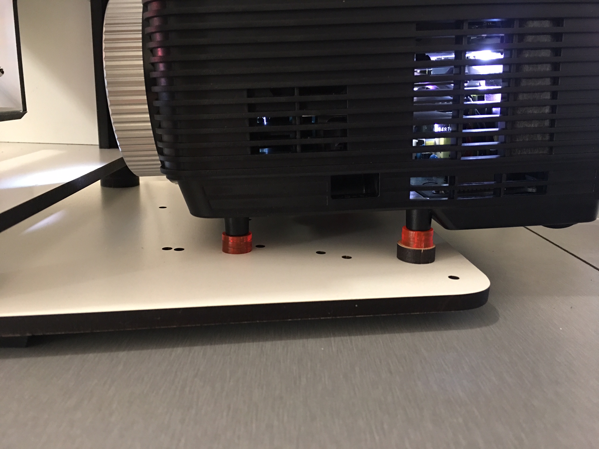

Generally you don't want to tilt the projector, in your case adding more of the 20mm white circular spacers to make the printer taller will let you return the projector to a flat plane.
Not having all the lines on the buildplate may or may not be an issue, if you just avoid the very outer perimeter when laying out your parts it won't cause an issue. Other options are to make sure the zoom ring is all the way unzoomed, the x152h also has a second set of mounting holes that are more forward that will result in a smaller projected image.
If the x152h runs into the square base in this forward position, that is what those two long skinny plates are for they replace the square base leaving the center open. With the x152h removing (pulling off) the front silver focus ring of the projector will give you more room to work with.

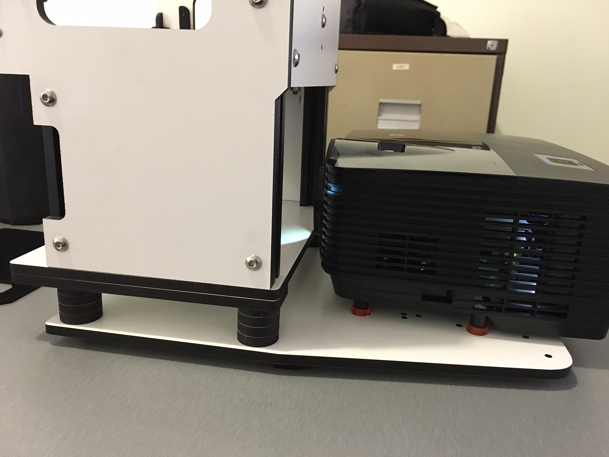

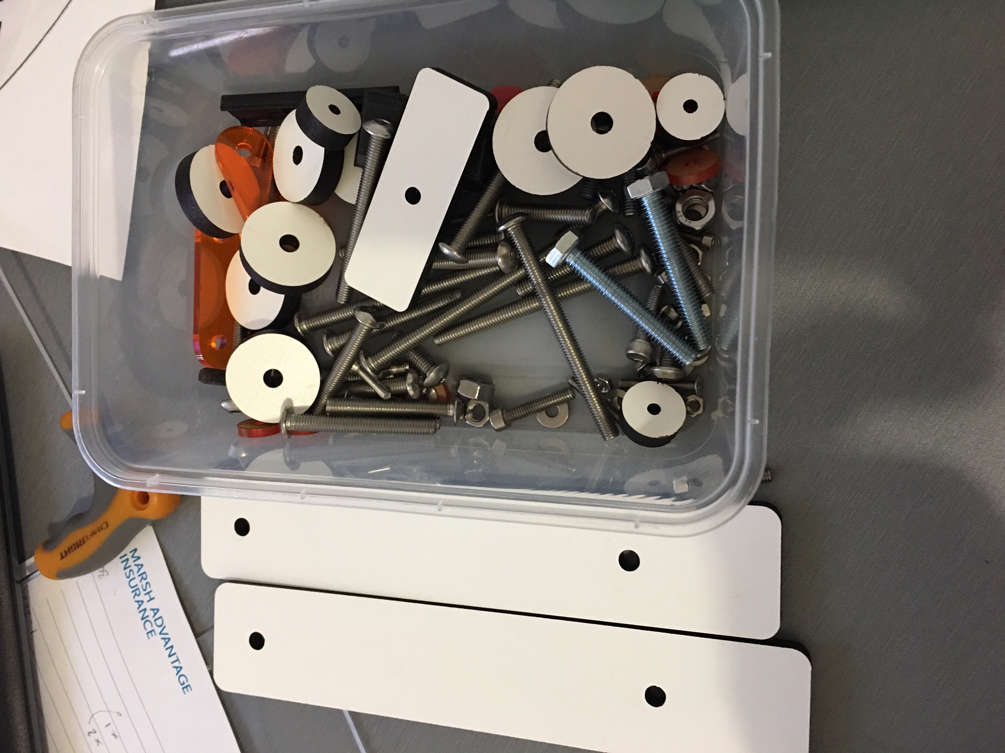

So i have made the projector level again and tried to change the height of the printer side by adding the long skinny plates to the front and a extra 20mm spacer. (I think that's what you meant to do?)
By doing this has actually put the gird nearly dead center on the mirror which is great.
I have also moved the projector into the 25micron position (i had it in the 37 and had the computer printing at 25)
But after doing this im unable to get a focus. What do i do now?

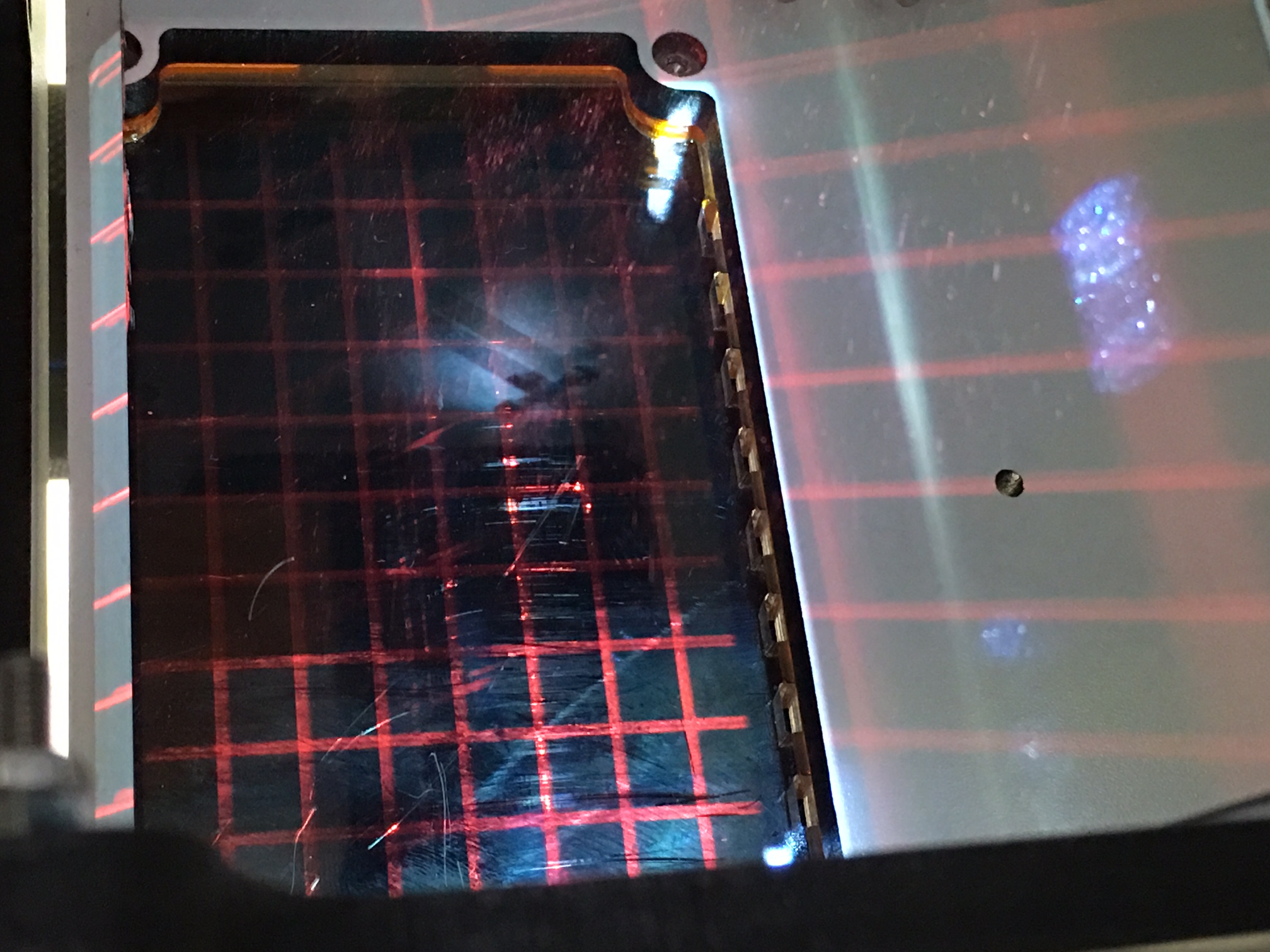

**I have also scratchedthe acrylic plate that goes under the vat.
Can i please purchase another as well as more of the VAT consumables, whilst setting up etc i have already destroyed two of the films and foams.

Correct the new spacer arrangement looks right for forward posistion x152h in eba mode.
Regarding focus, is your projector unmodified? If not you can either modify the projector for close focus or move it back to the other position and avoid the perimeter. I have linked a good guide on the github for modifying the x152h: github.com/goopyplastic/littlerp2

B9 resins are pretty tough on teflon film for some reason, they are tuned for PDMS so for whatever resin they seem to really beat up the teflon.

So i went to github.com/goopyplastic/littlerp2 and followed the guide to modify the projector. (Was easy thankfully)
