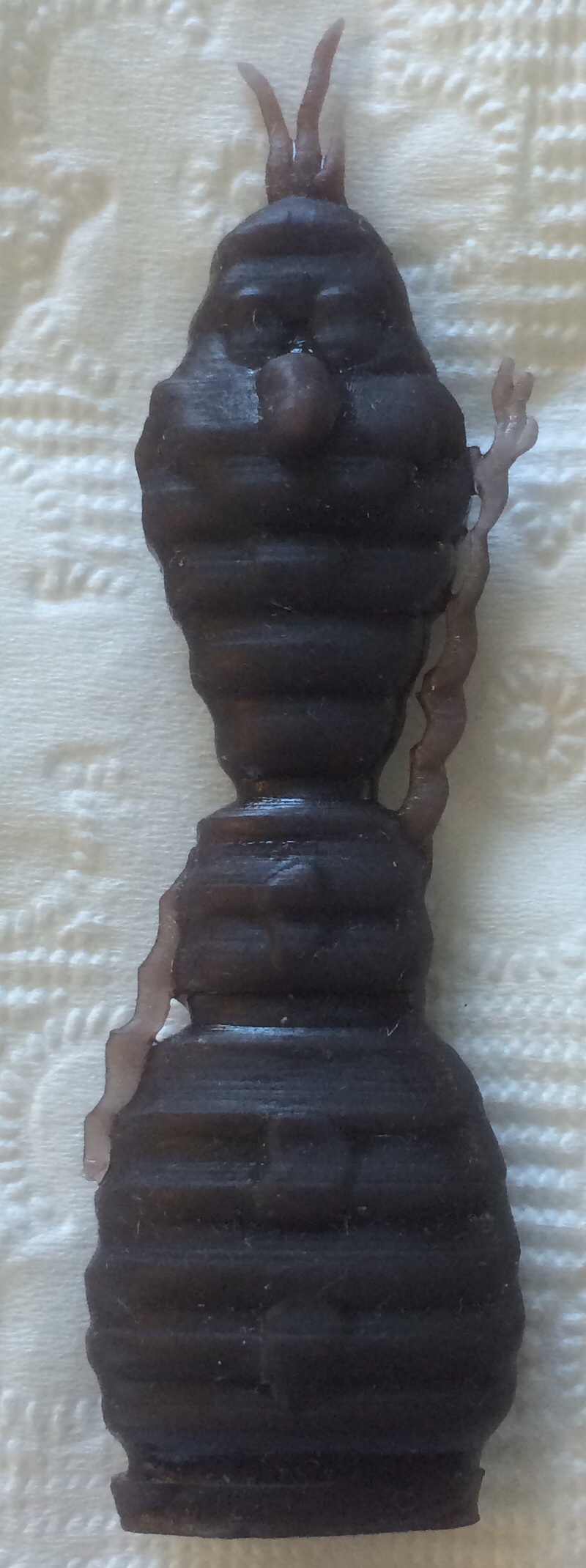

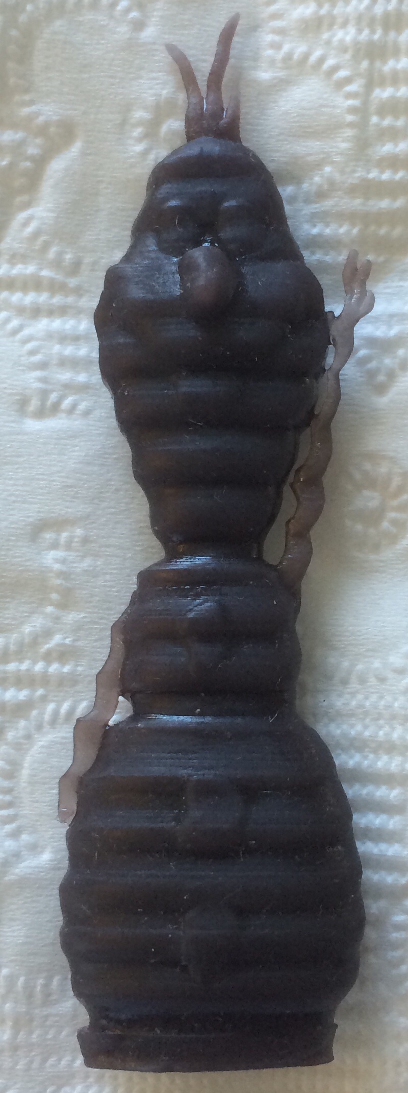

my exposure settings vary depending on the resin i use, i have 4 different manufacturer who make all their own different type of resin. varying from 0.9ms per llayer depending thickness to 3.4 sec per layer
the first few layers i use 10 seconds or 13 seconds. the biggest part is a 26cm long bottle, the widest part is a ironman helmet, 10cmx8cm

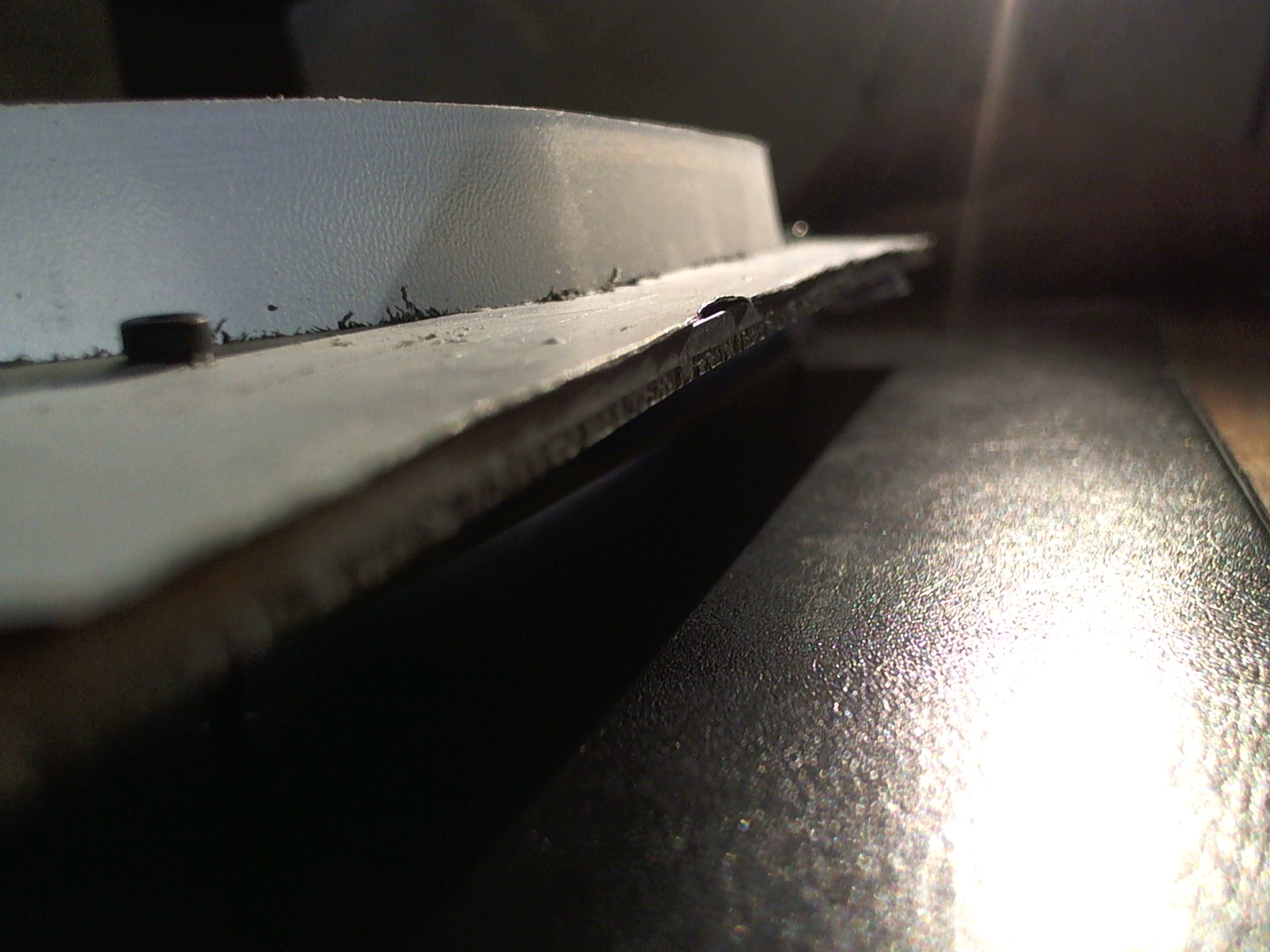

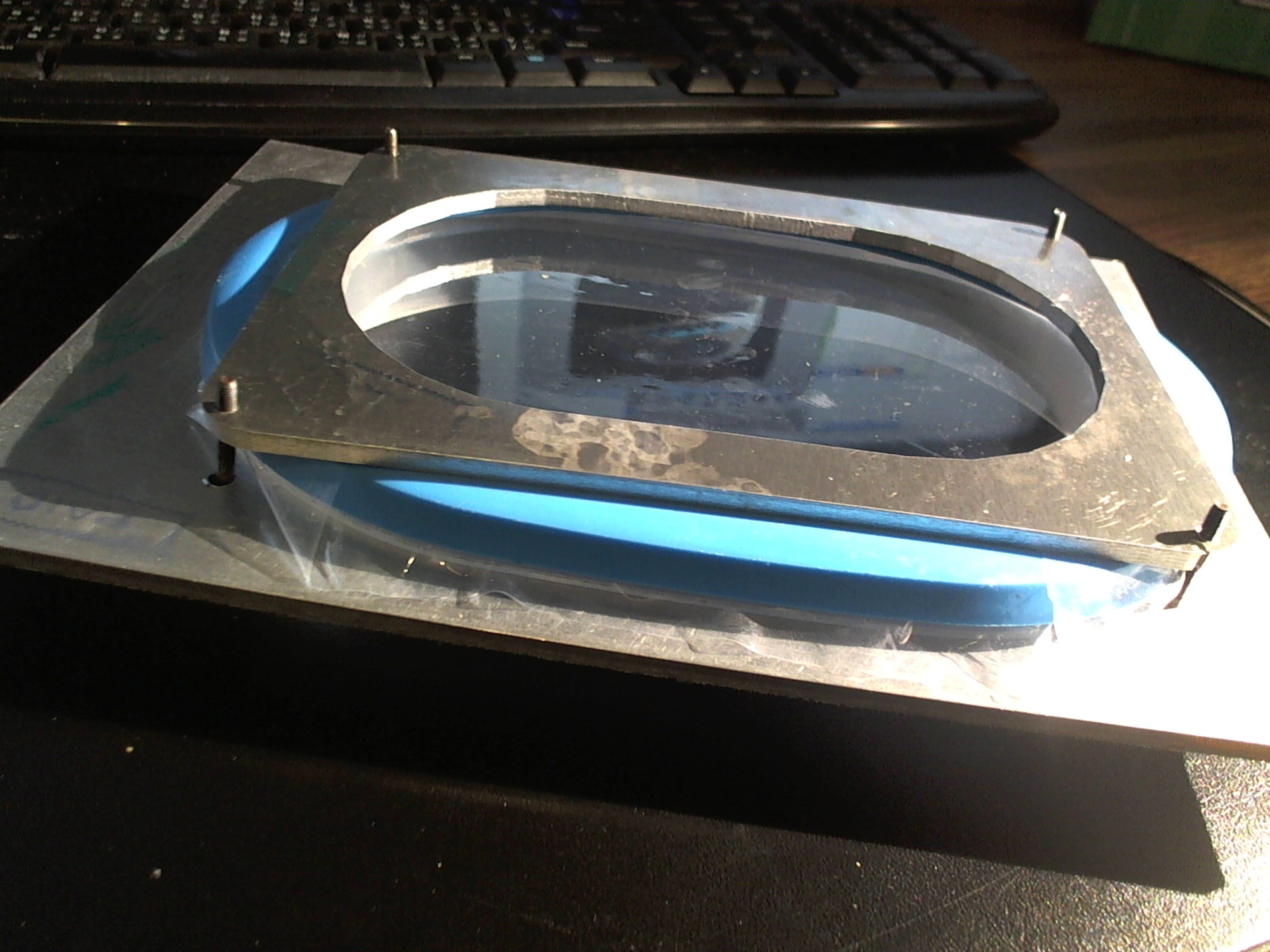

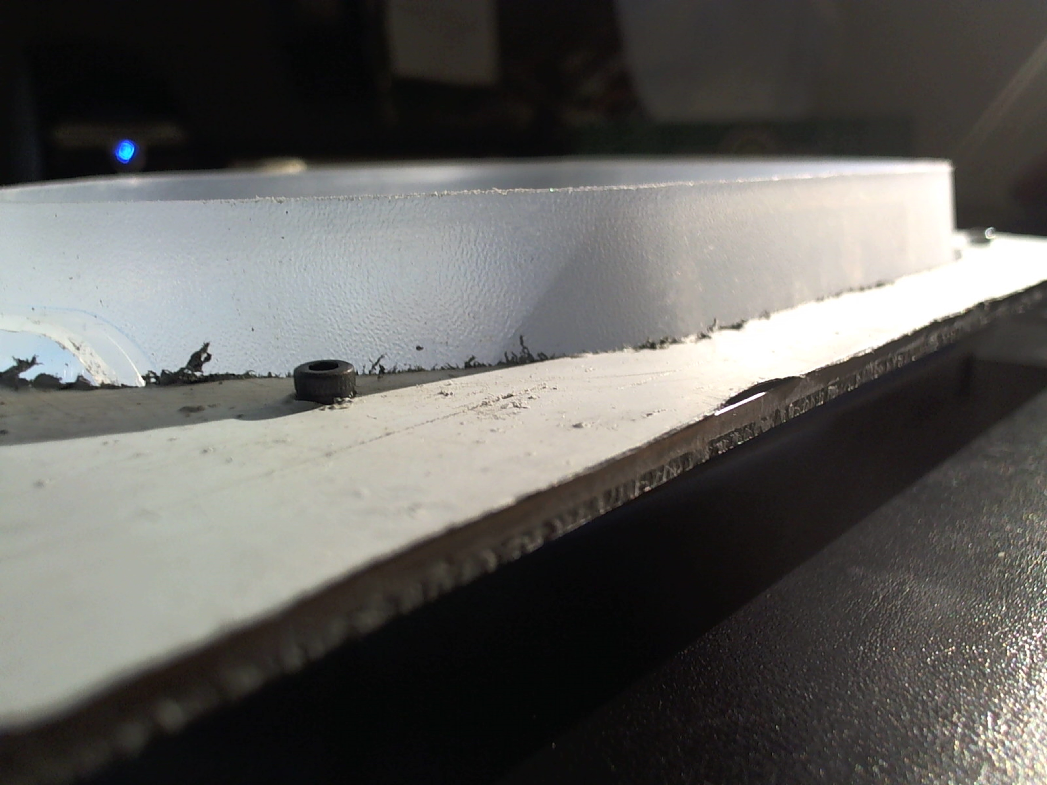

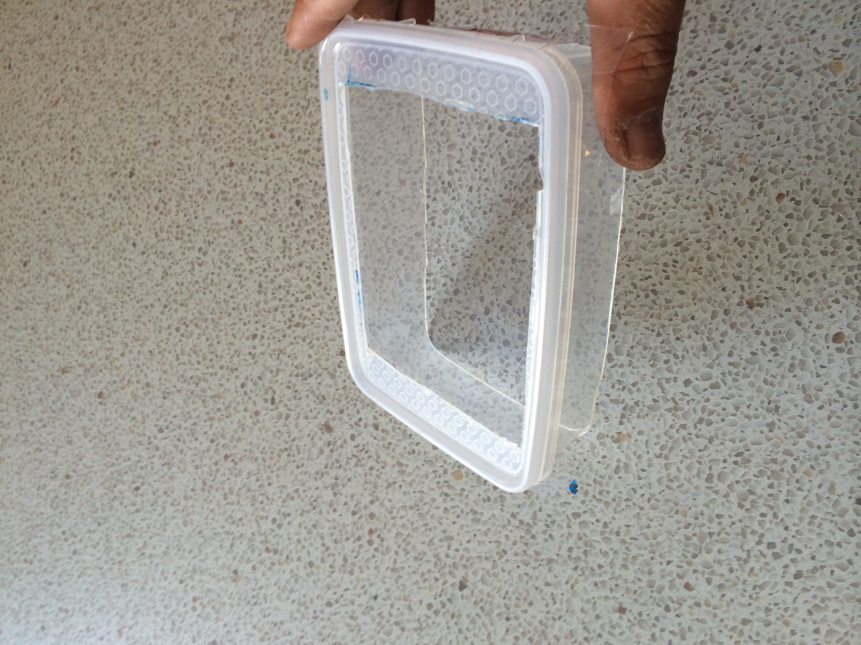

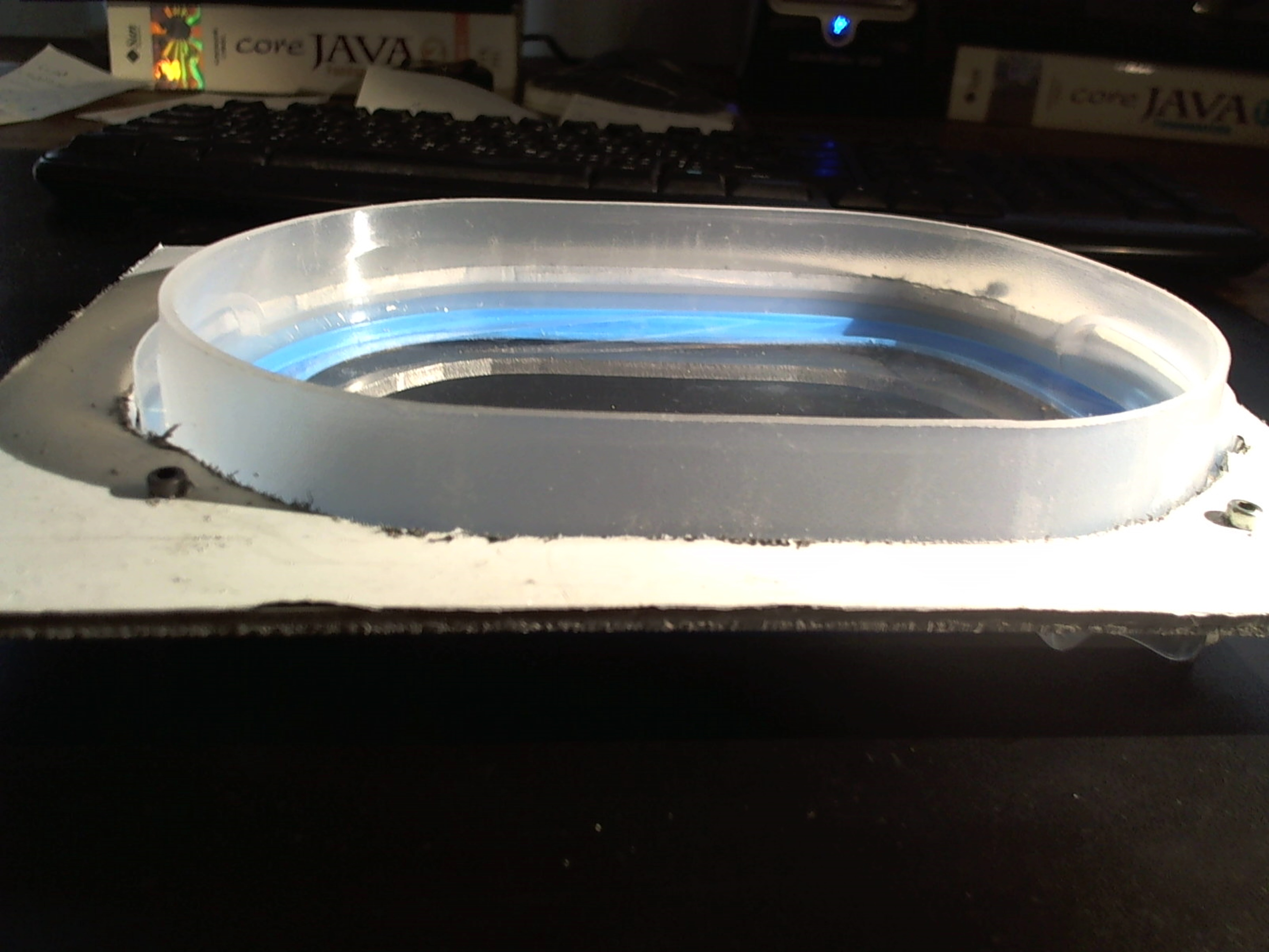

Hi dangre,

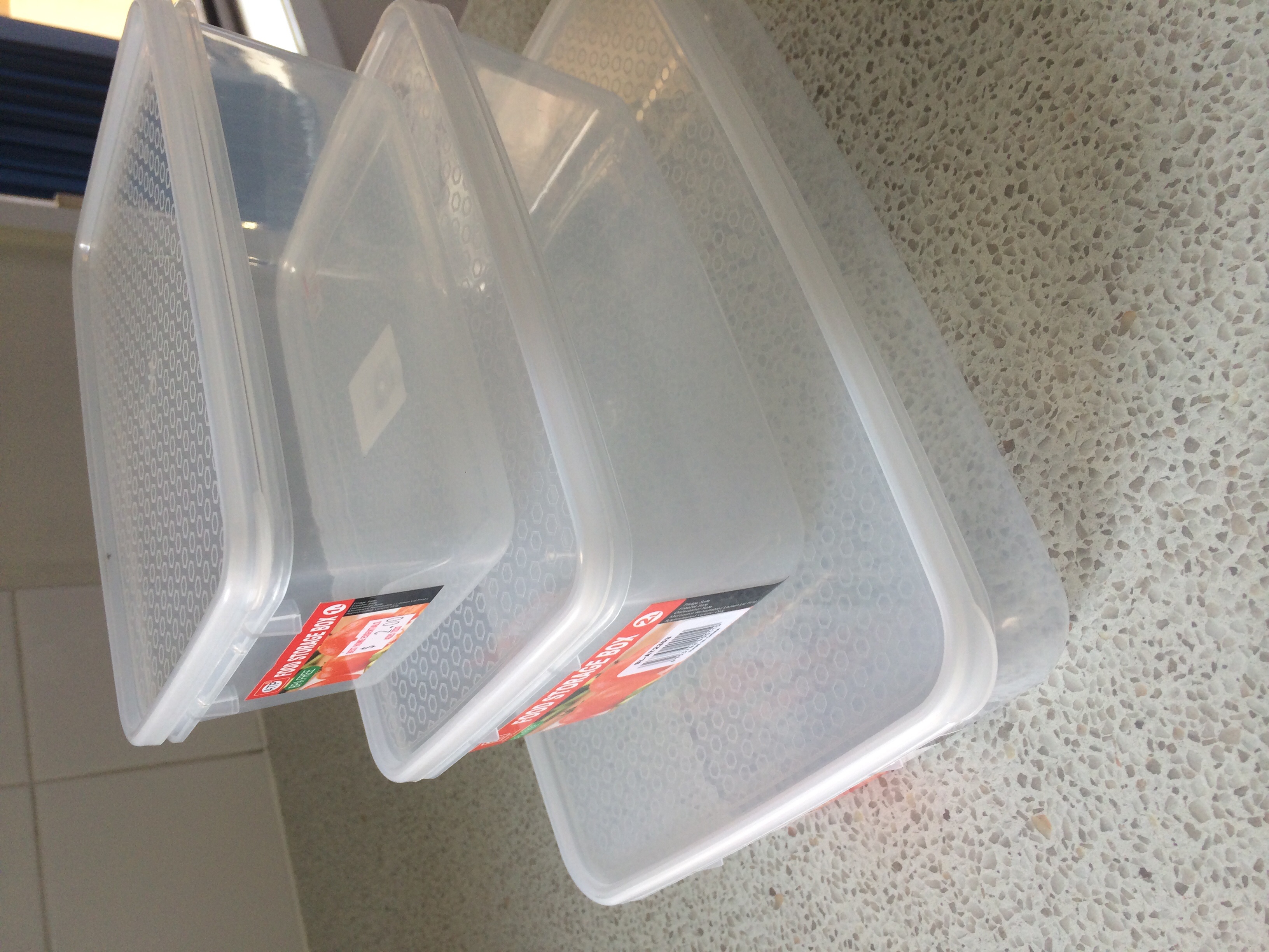

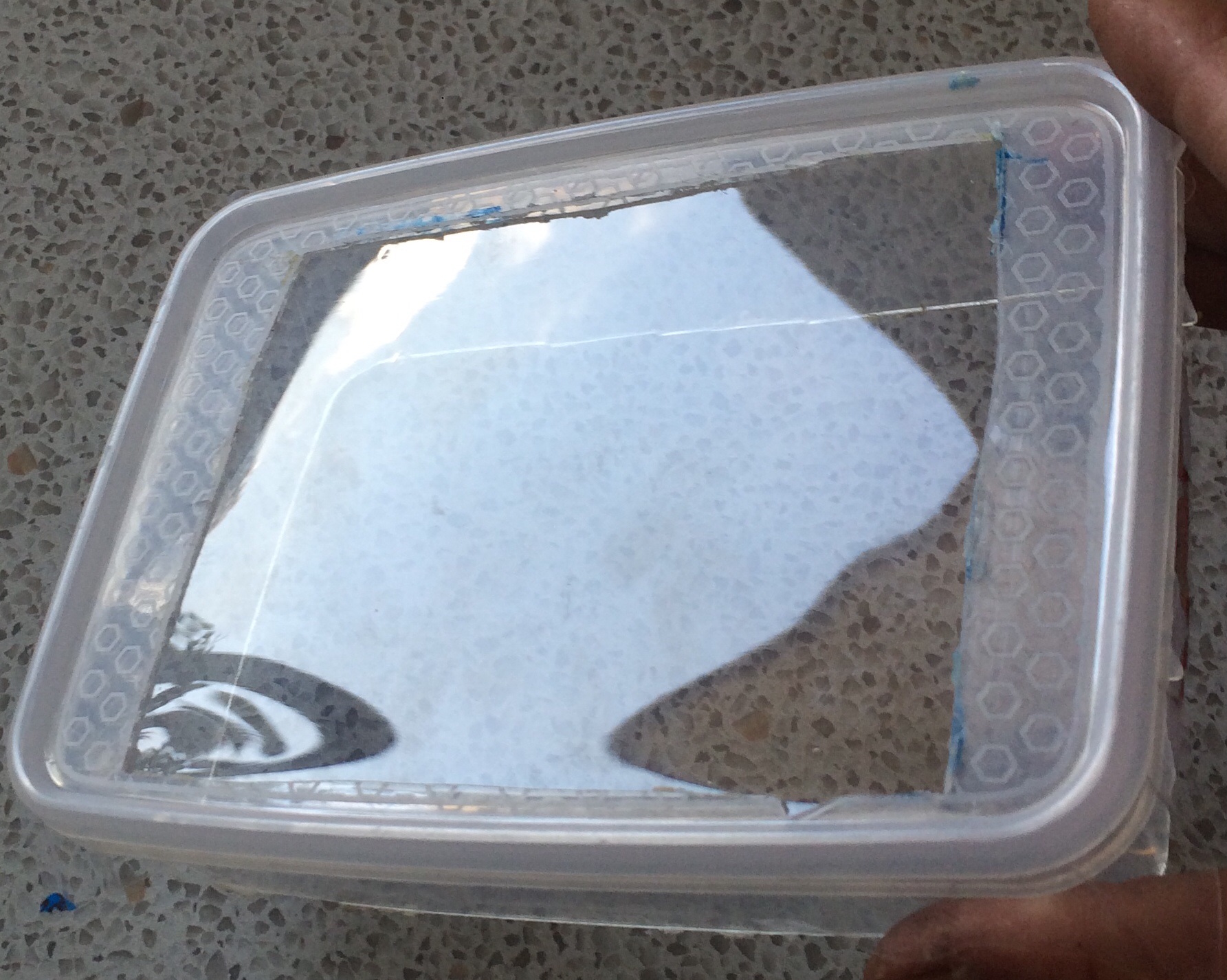

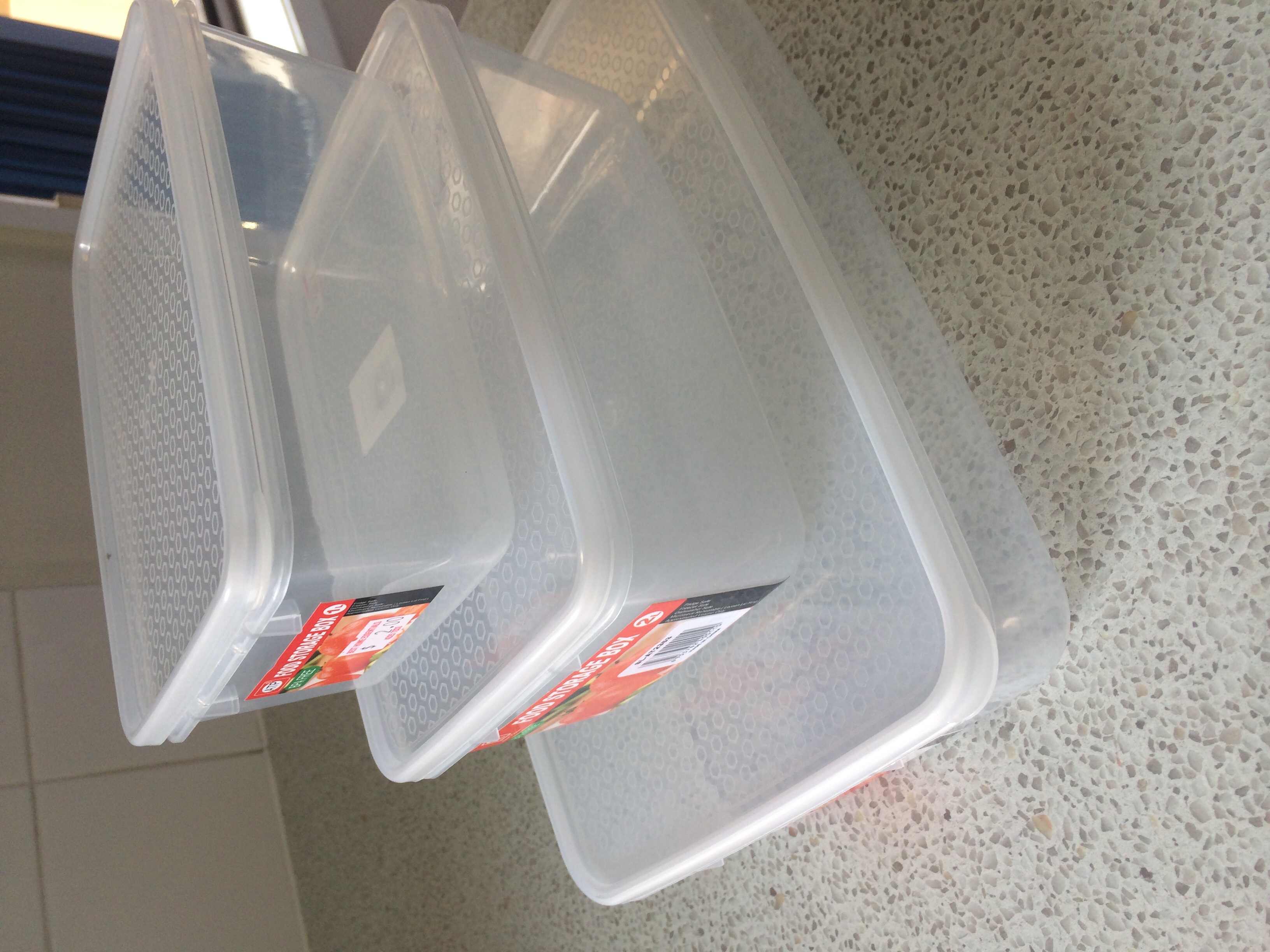

i do pre-tension my container Flex vat, as you can see in the picture below, I have room to tension the fep film by pushing a piece of 10mm electronical cable between the lid and the fep film.
giving pretty tensed fep film. And thanks to my neighbour who cut of the bottom part of the container makes it a perfect usable Flex vat
this is the top side:
this is the bottom side
