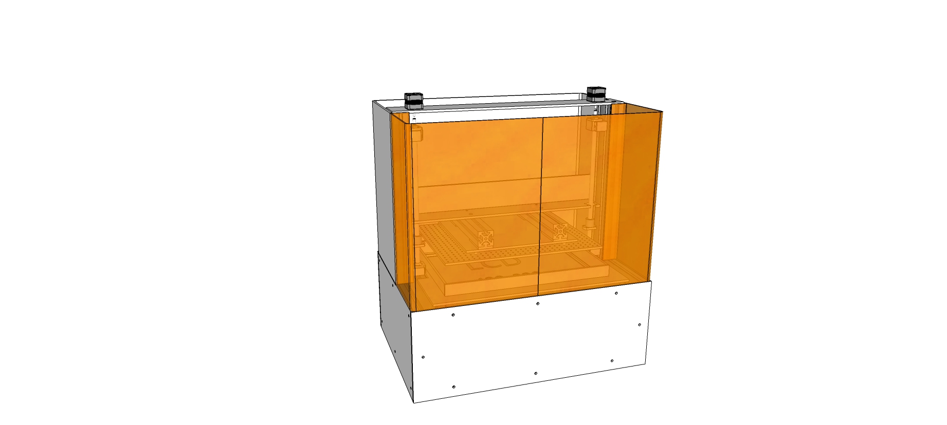

Re: New Builder - LCD Based 3D Printer - Introduction

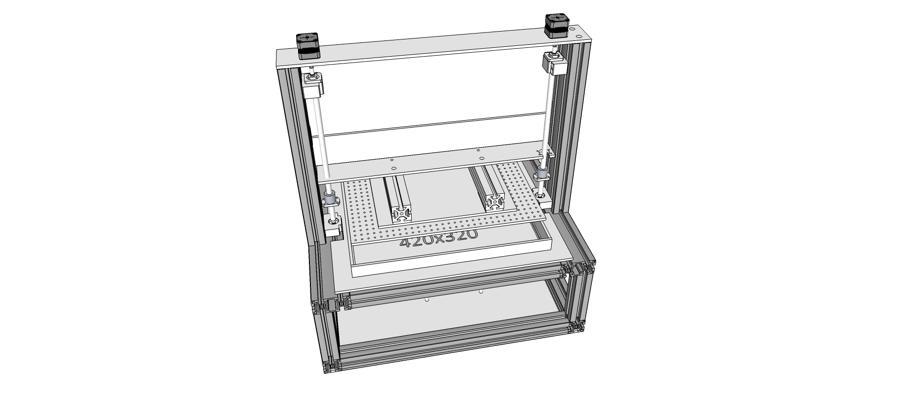

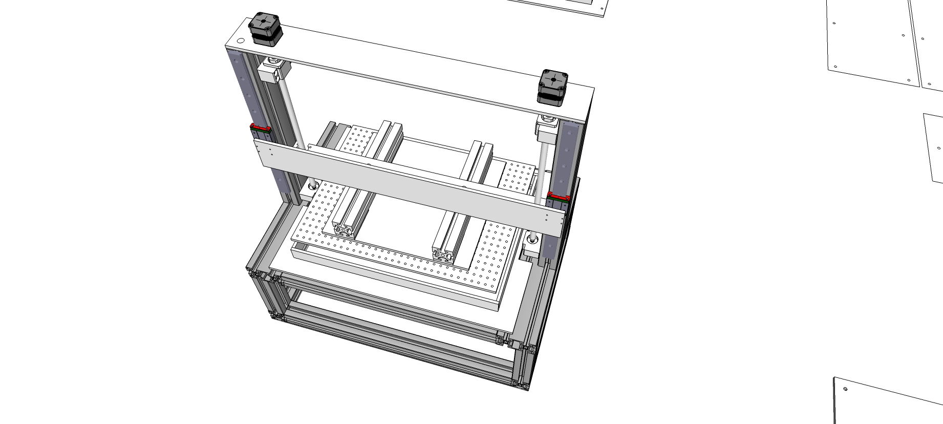

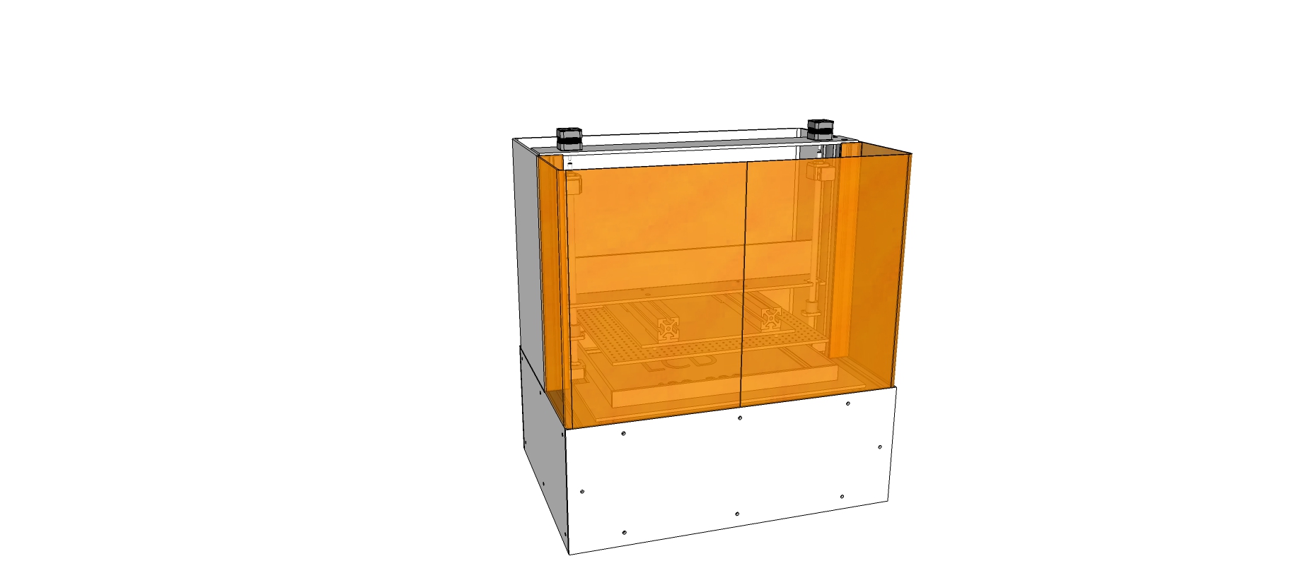

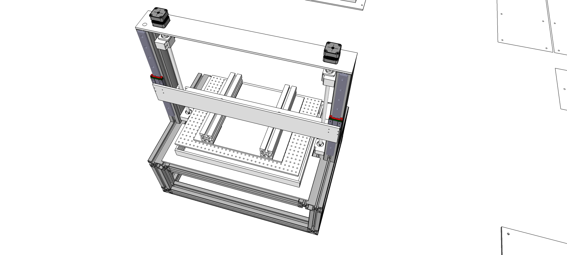

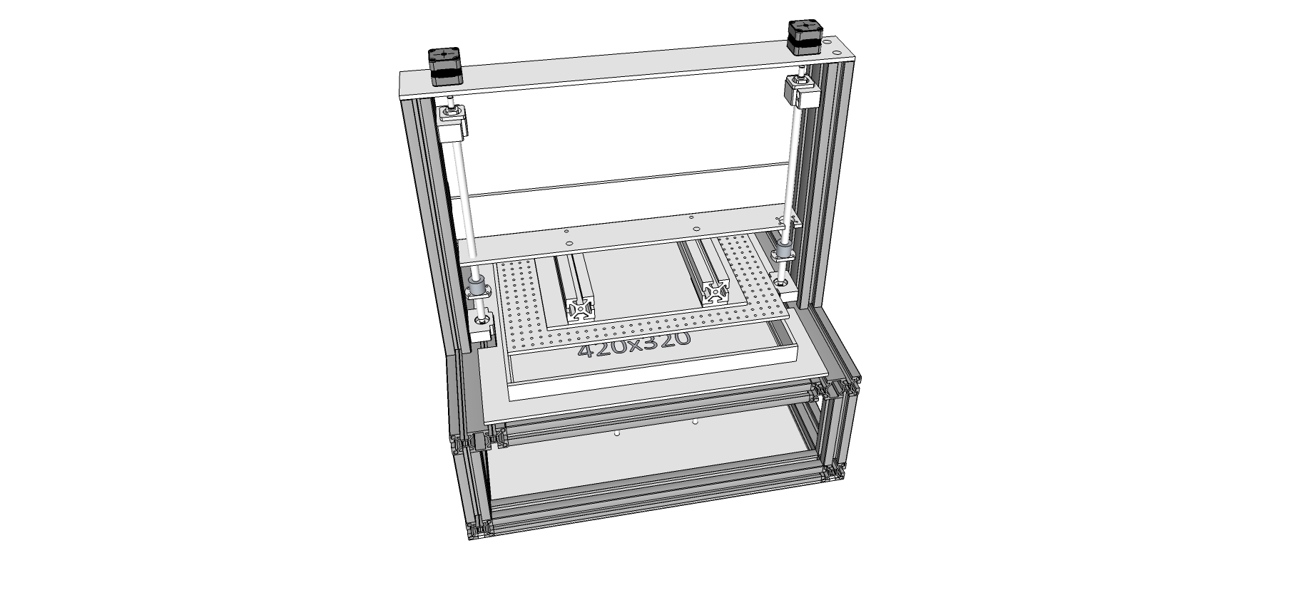

Heres a few Pictures from the 3d model. Its not complete. I will be spending some time completing it and the actual prototype in the next month. Im waiting for my custom MCPCB and lenses to show up. I plan on selling the entire machine as a kit for people to put together.
I am using Hiwin rails and ball screws for the Z axis. More details and pictures to come. Feel free to ask any questions and i'll do my best to answer them. I will start a new thread when I have more to show.

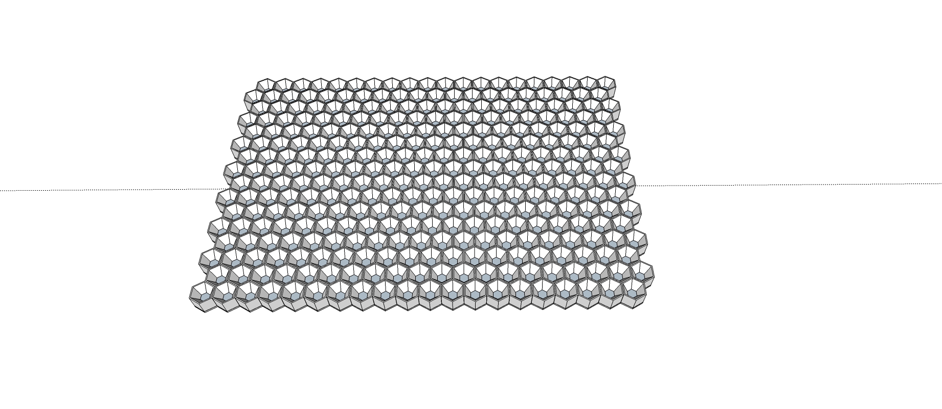

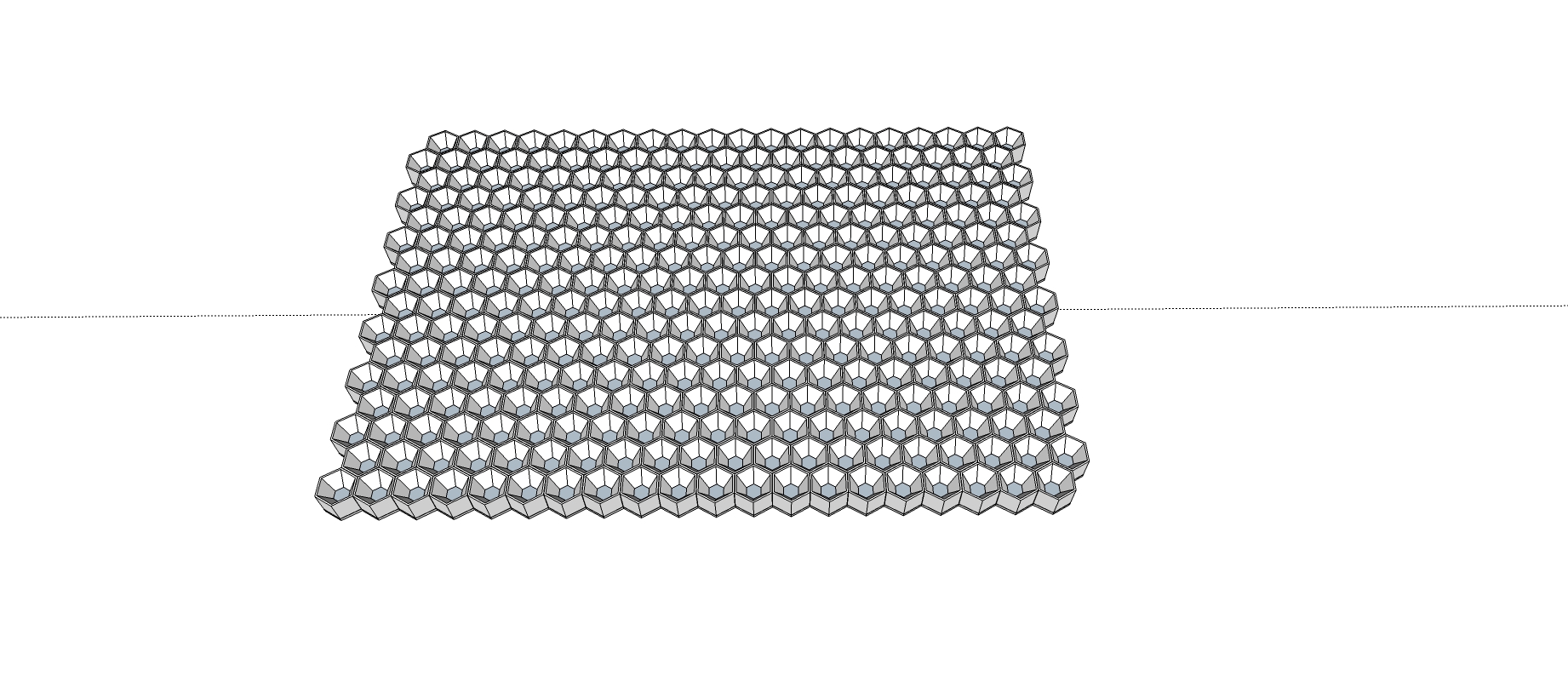

This is the LED array, 320 pcs of 3w 410nm LED's, and 6 degree collimation optics. Custom Metal core PCB and it gets attached to a large heatsink for cooling as this thing gets hot!
I made it modular and scalable so it can be made larger or smaller to suit different size LCD's.
