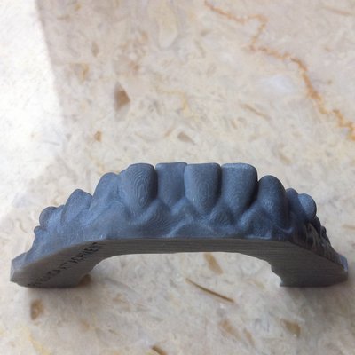

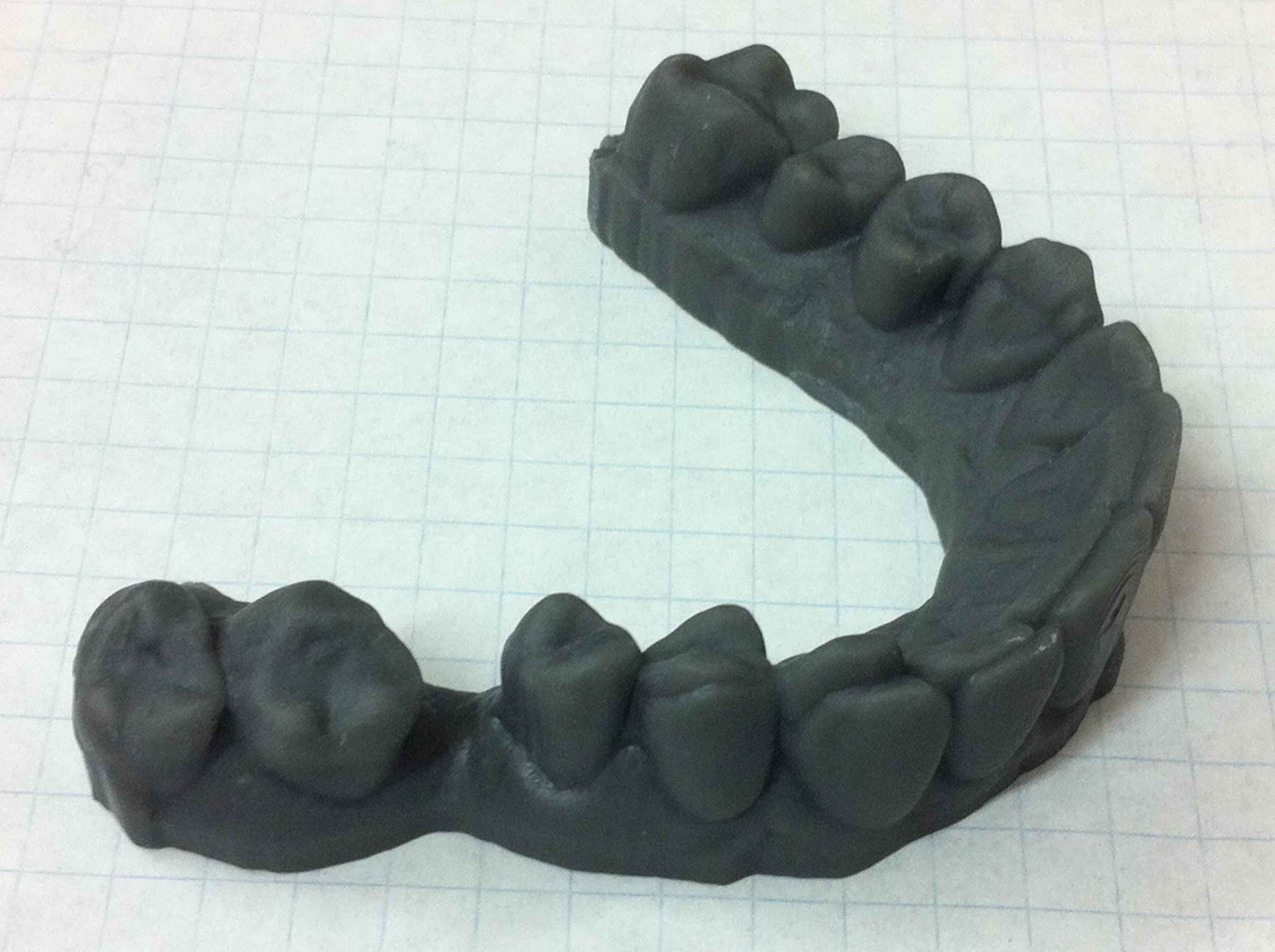

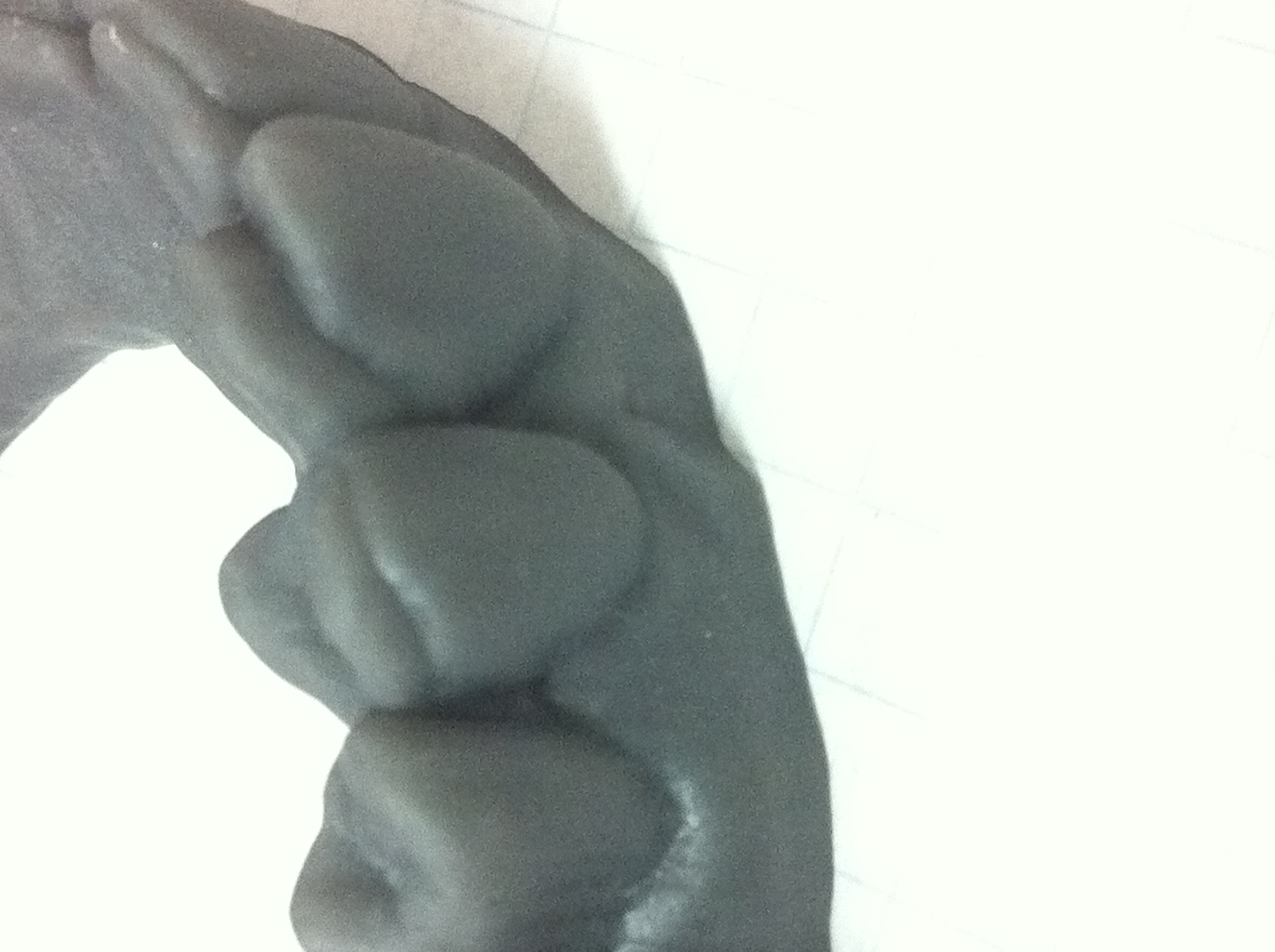

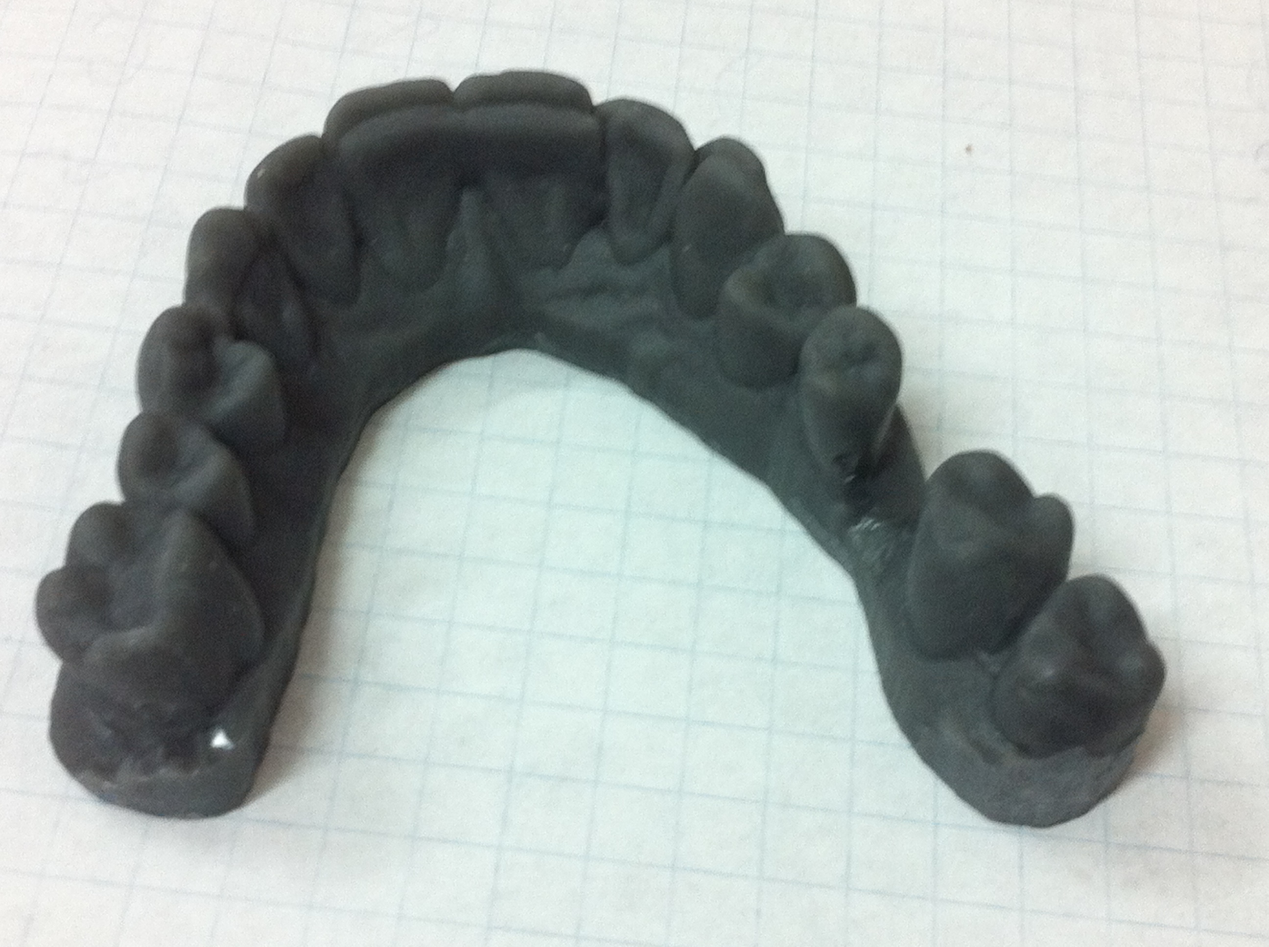

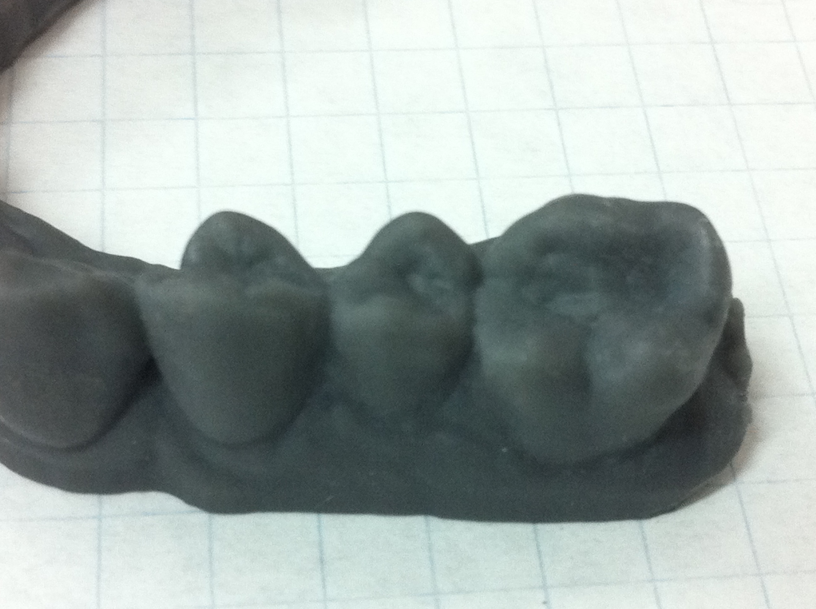

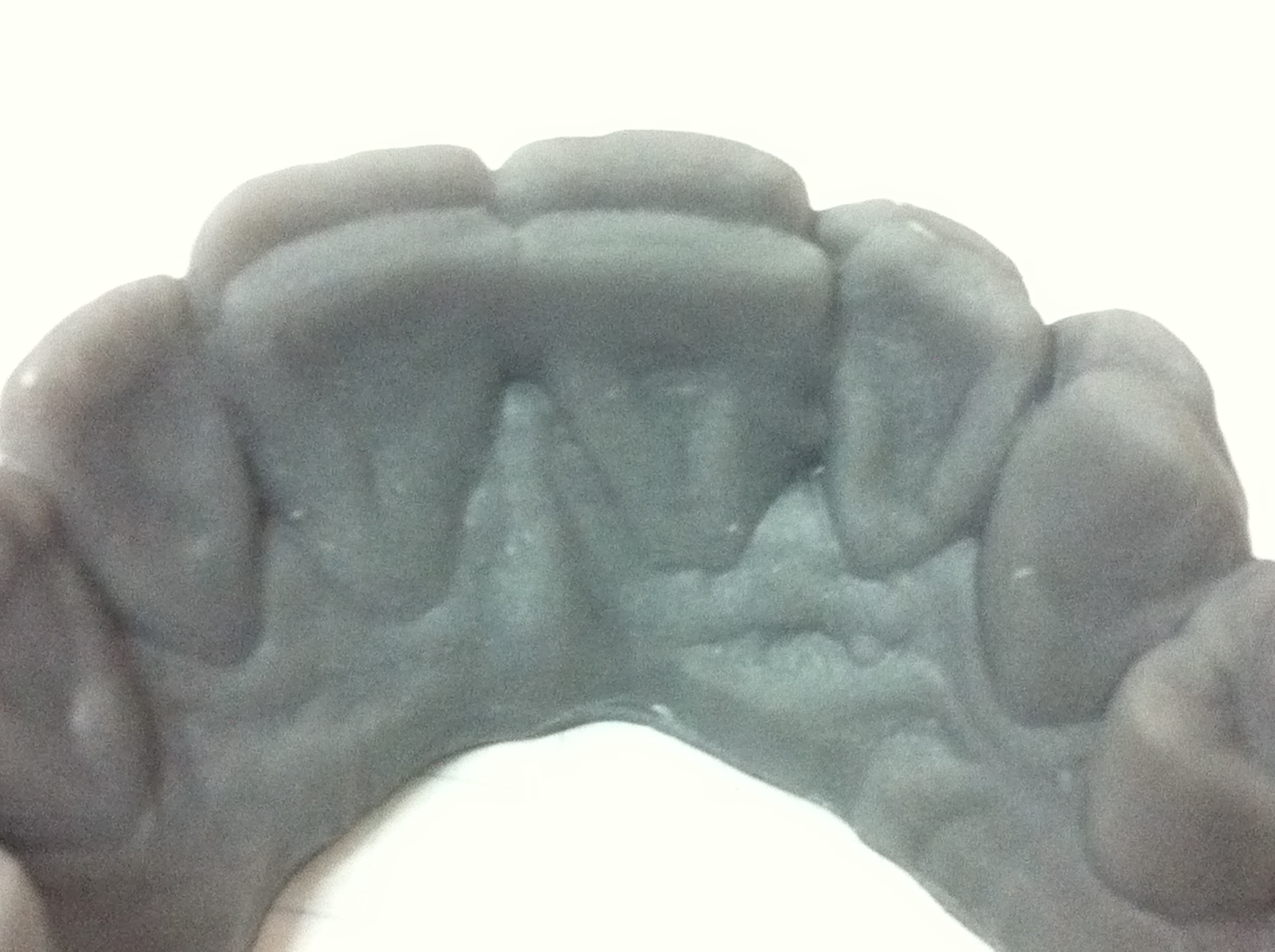

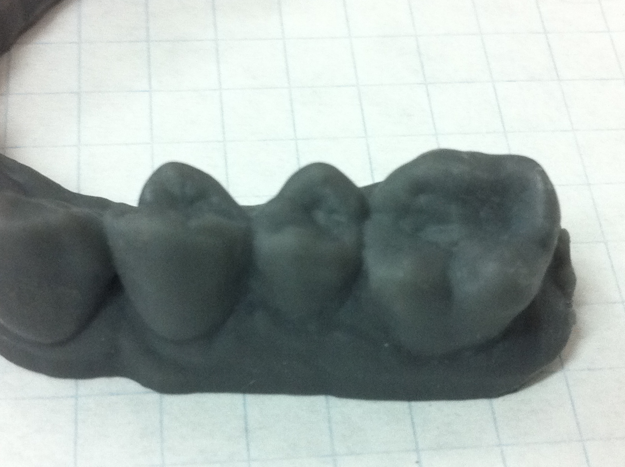

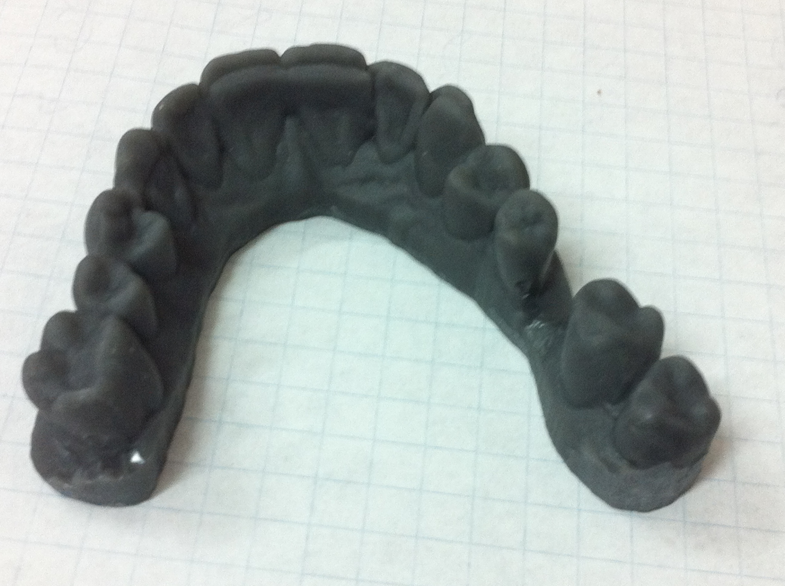

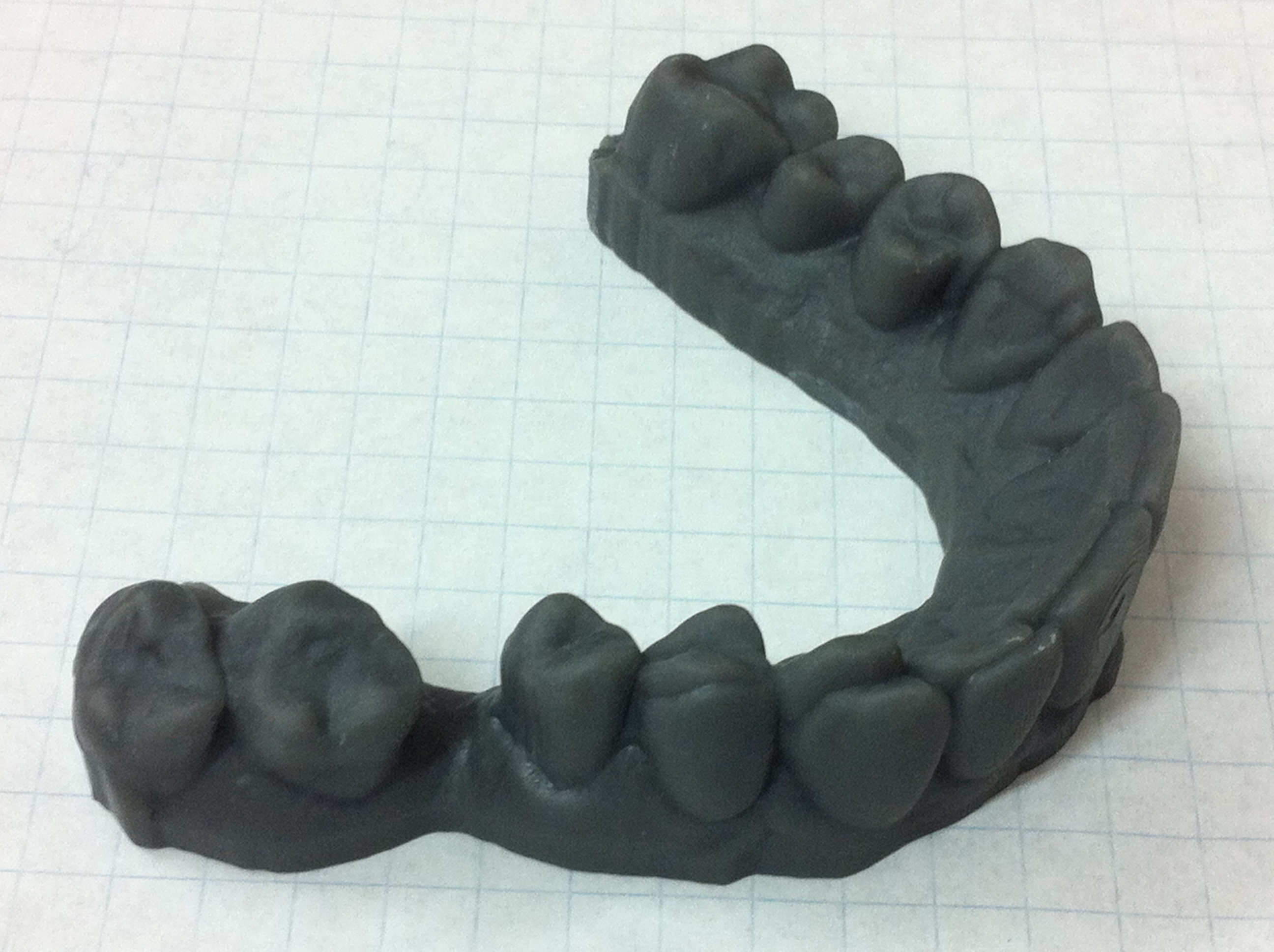

Hard gray resin Photocentric changed in color. Printed 60 microns thickness and 75 resolution.
Difficult to detach from the plate but tough and durable.

Is this on one of their Liquid Crystal printers or something DIY?
Looks great!

Printer DIY Projector acer p1500.
I think we can still improve, test cases still short more results.

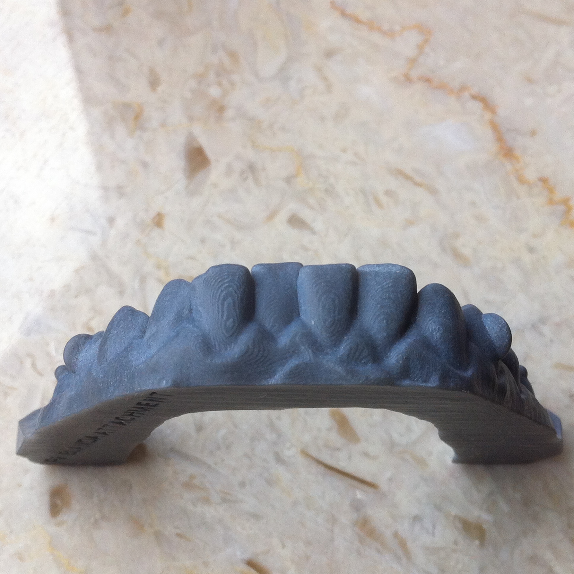

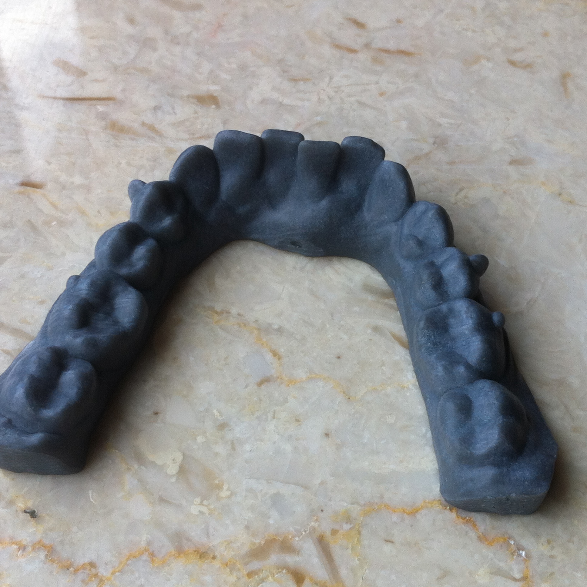

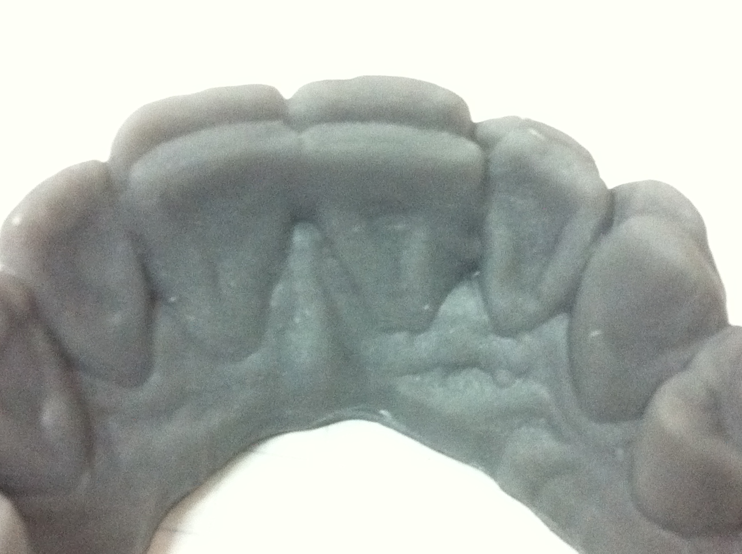

Re: Photocentric resin.

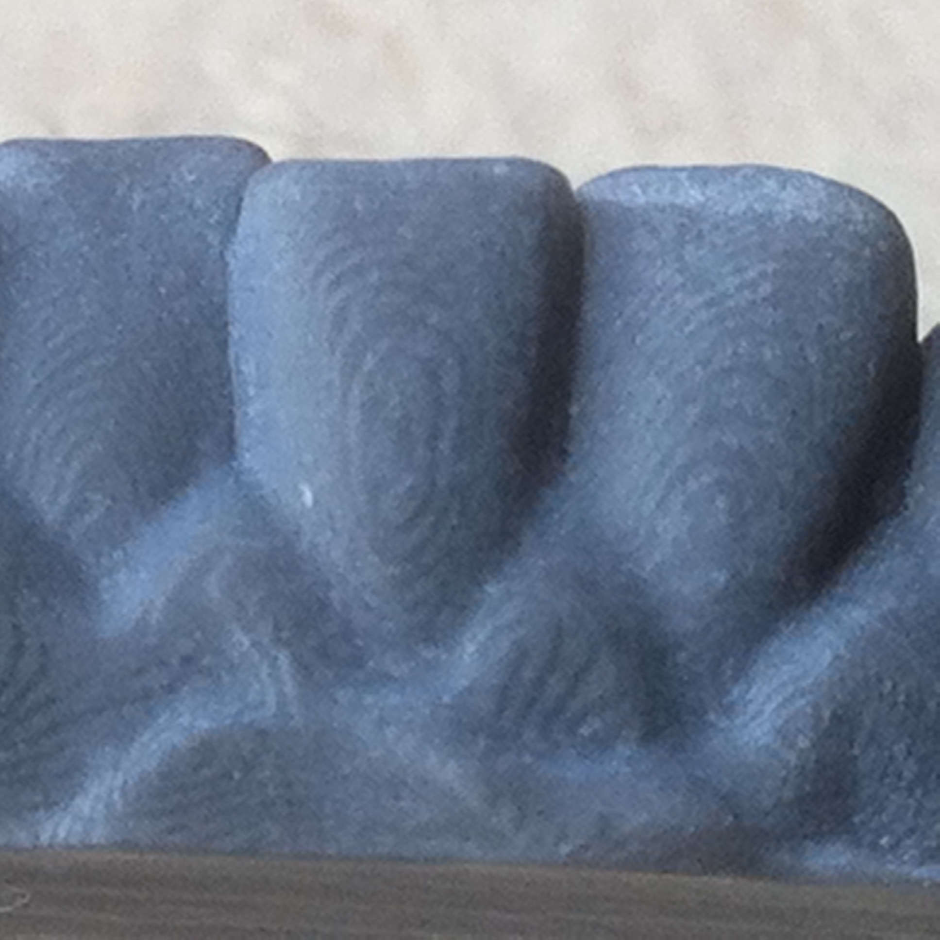

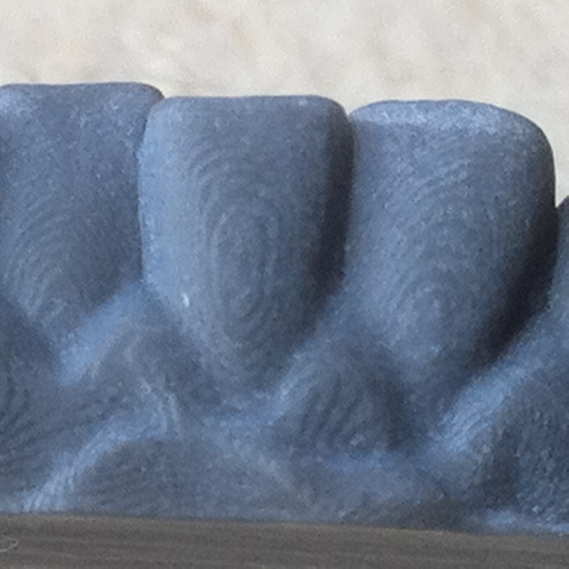

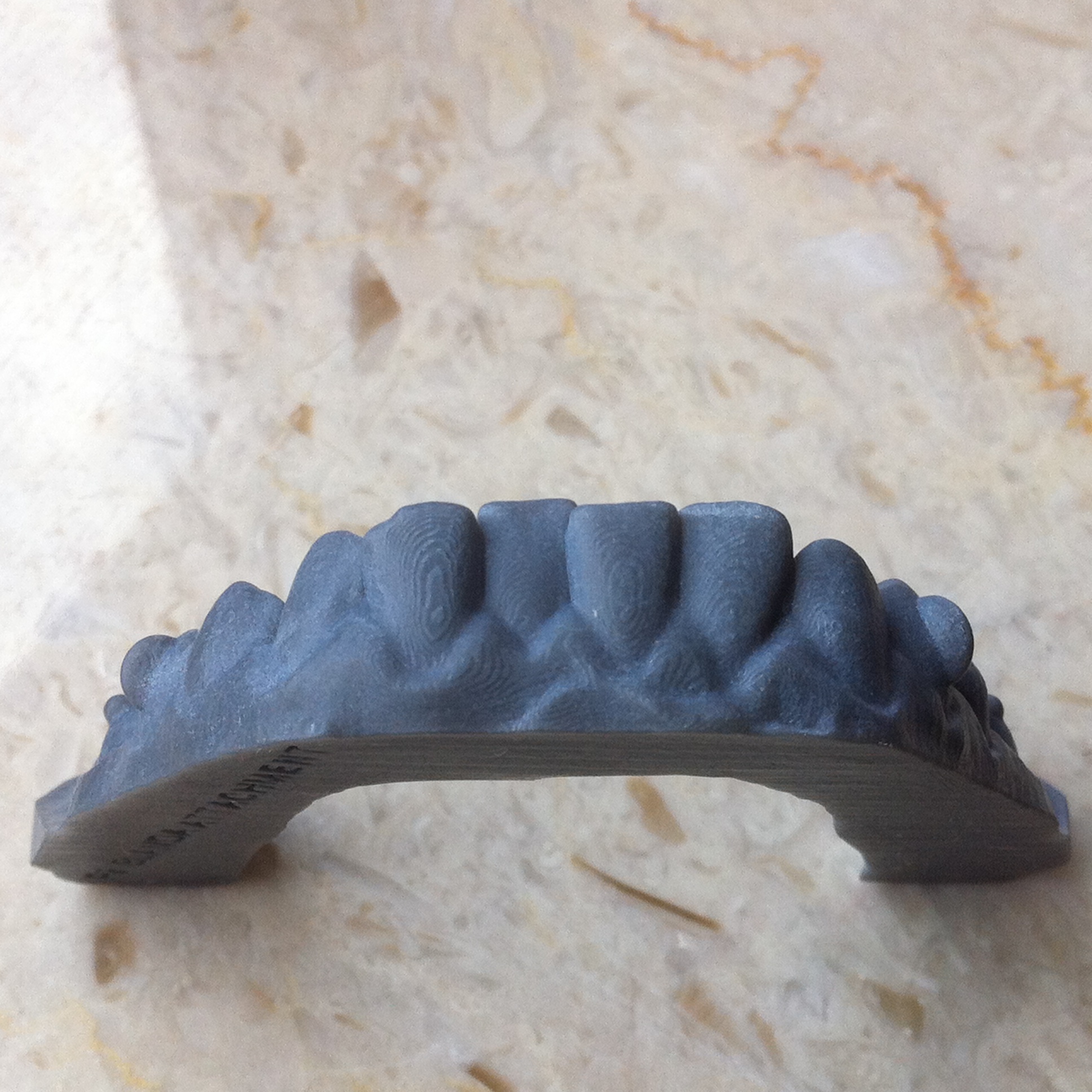

Test to 100 microns layer. Excellent, the photos do not do.
Removed the initial stress of the press, about 2 cm.
Difference between file and print about 110 microns in height of 6 cm.
Scanner used for coupling with an accuracy error of less than 10 microns for the dental sector.
