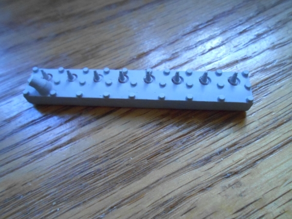

Another issue is overhangs/flat surfaces.
I.E. a LEGO piece - the overhanging top is bulging.
Adding holes to it help, but not all the way.
Increasing settling delay does not do much of anything.
Anything i can do about that?
Or is it exclusively a wiper-soluble problem?
Appearance: http://i.imgur.com/KVgSqua.jpg
						The parts no longer just unstick.
But they still warp slowly on long stretches.
Before on the left, after on the right: http://i.imgur.com/MKQ3LV7.jpg
