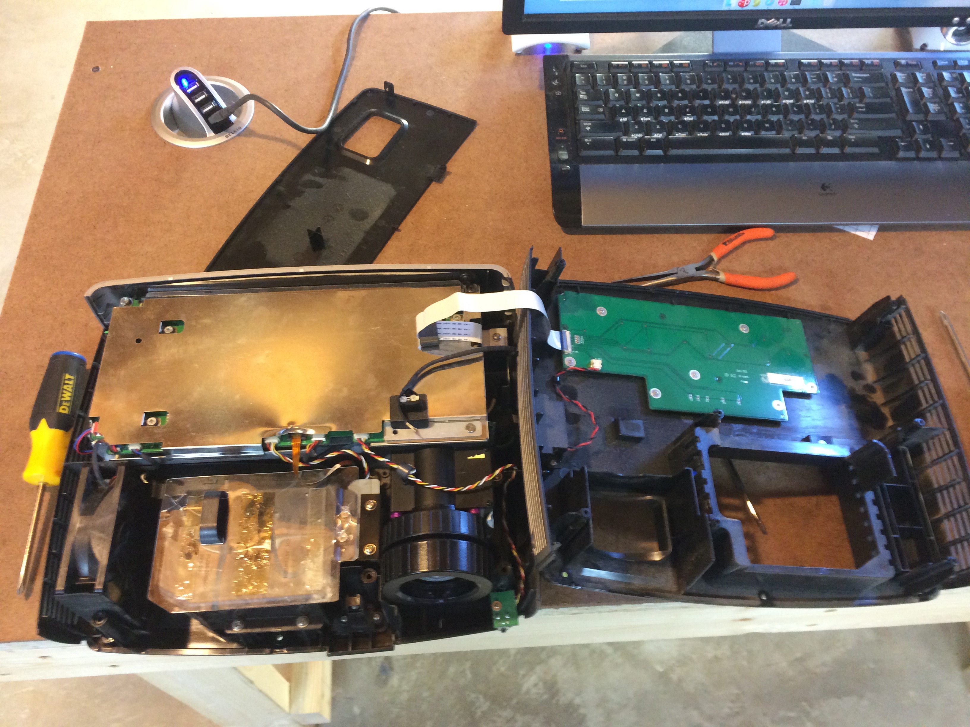

I'm not afraid of opening the projector, just more interested in how much I need to mod it.
1) Not sure the color wheel needs to go from what I've read. I know there's a UV filter glass on the bulb assembly, but from a few comments, the color wheel might be fine left in. Unless someone had particular experience that says otherwise.

Actually, it's an Ask Proxima A1200EP which is just a rebranded InFocus IN2104EP.
Got the UV filter off because I've heard the IN2104 won't cure Makerjuice with it on. Haven't touched the color wheel. Just hoping I don't need to.
I can get the projector to focus sharply down to approximately 6-7 inches wide without modifying anything else. Guess I need to get some Makerjuice now and start testing exposure times and resolutions?

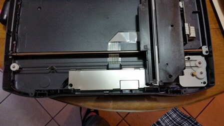

Had a good look in the scanner I'm hoping to use.
The stepper is 12V 5 Ohm with 3.75 step angle with two reduction gears for the belt drive. There is one round shaft that attached to the molded plastic case of the scanner. The scanner claims a resolution of 4800 over the nearly 300mm length of the scan area. I calculate that to be about 0.06mm per step but that's using the scanner. Haven't tried driving it directly yet.

I started using a IN2104EP. I took out the UV glass from the bulb assembly, broke off the color wheel and added spacers to lens assembly to shorten the focus distance. I knew I needed to shorten the focus distance since I'm going for smaller prints. During the mods I stripped the projector down further than I needed to, all the way back to the DLP chip. The projector worked great on my bottom up setup, I was able to get decent resolution and cure times and ran several multi hour prints.
Then one day I turn the projector on and I get a LOT of stuck pixels. I'm not sure it was just the projector, me stripping it down the the DLP chip which could have effected cooling or removing the UV glass and color wheel. I'm doing this on a thin budget, so I've ordered another 2104 and will have it tomorrow. I'll do the same, remove the UV glass, color wheel and add the spacers. I may leave off the cover and add a fan to help cooling.
As a note, after the 2104 failed I got a Dell 1409x. I did the same process and after running for about 5 minutes smoke started coming from the projector. It started to melt and burn the plastic in the assembly behind the lens assembly. In the trash with that one. Giving the 2104 one last shot, otherwise I'll need to save for a proven projector.
