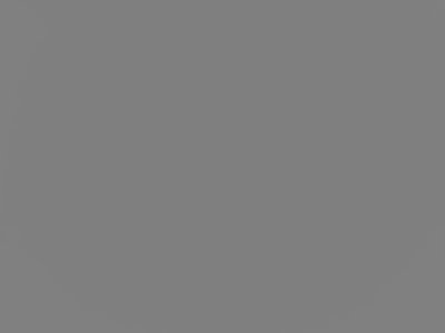

I made a picture to illustrate what a mask does:
So the mask evens out brightness imperfections in the projector output.

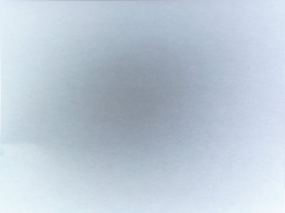

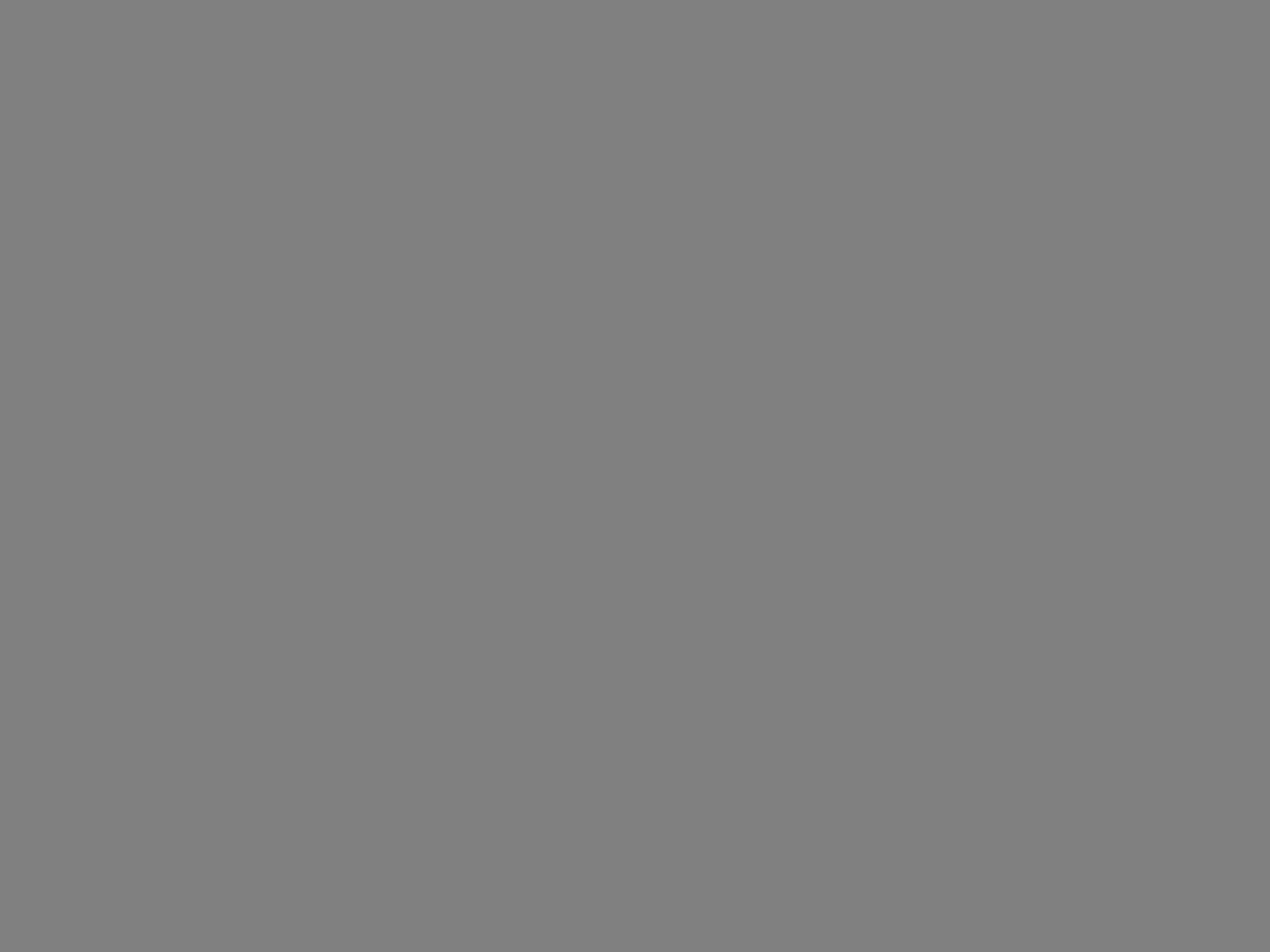

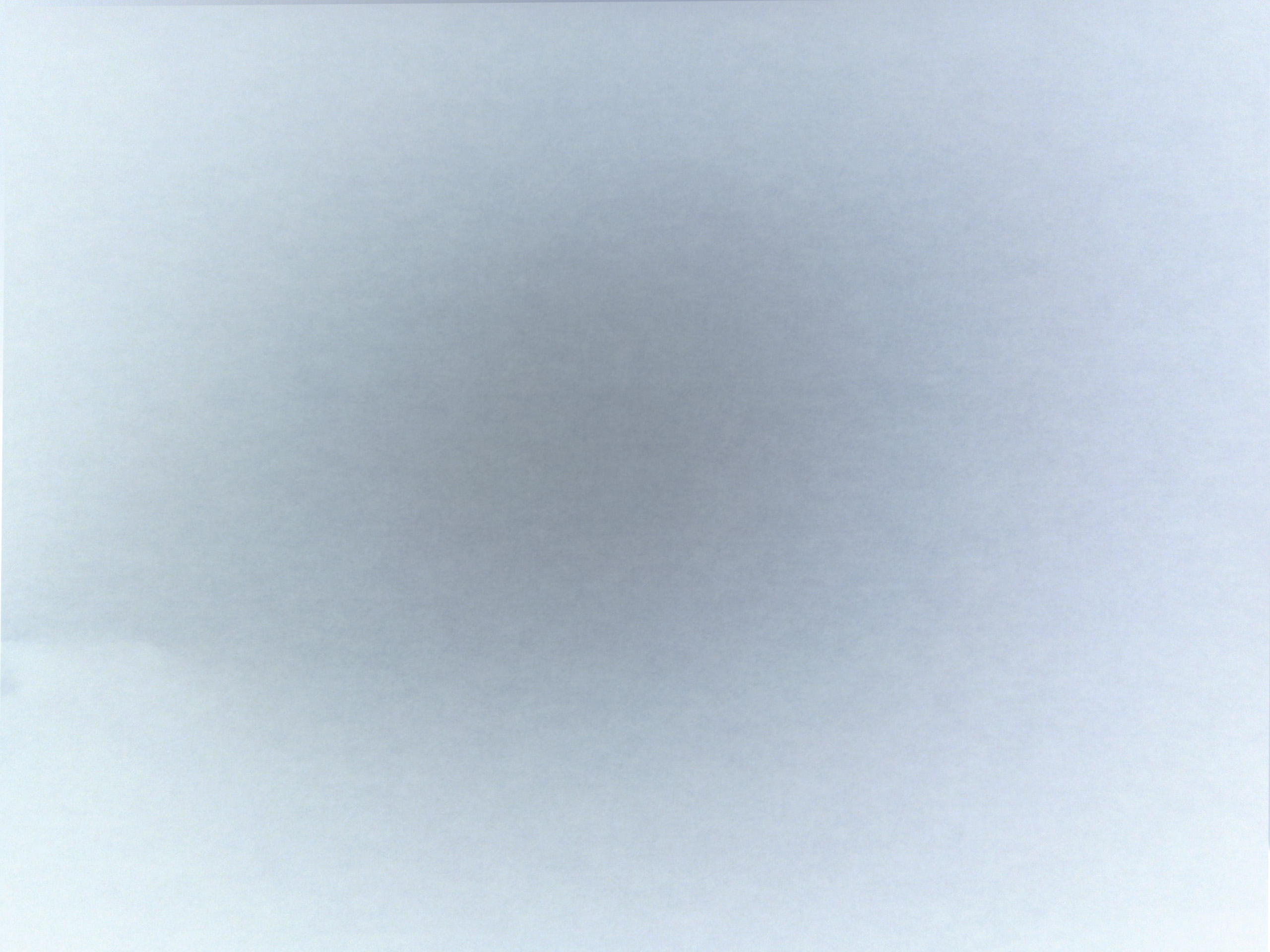

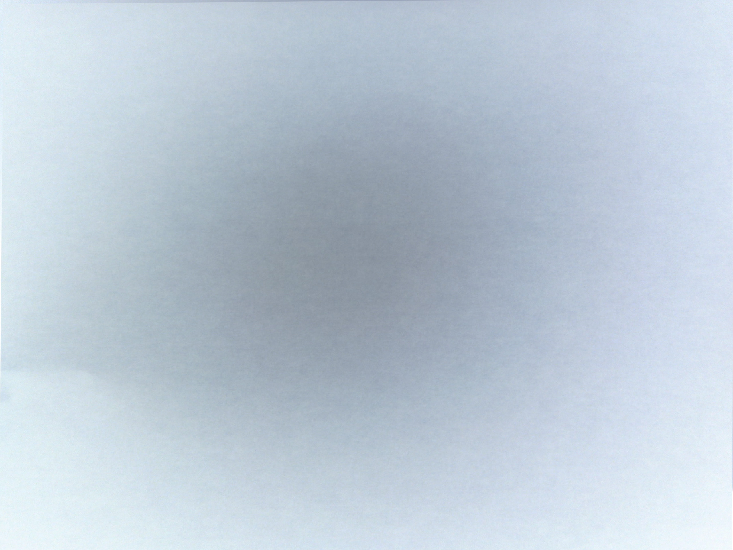

i just did a test. a white paper in front a lamp. it could simulate the uneveness if the light. take a photo.
i load this image to photoshop, invert it in a second layer and apply a 50% transparency.
The result image is perfect even grey image.
i dont know the exact steps or settings to get the right png mask file ... it is documented somewhere?

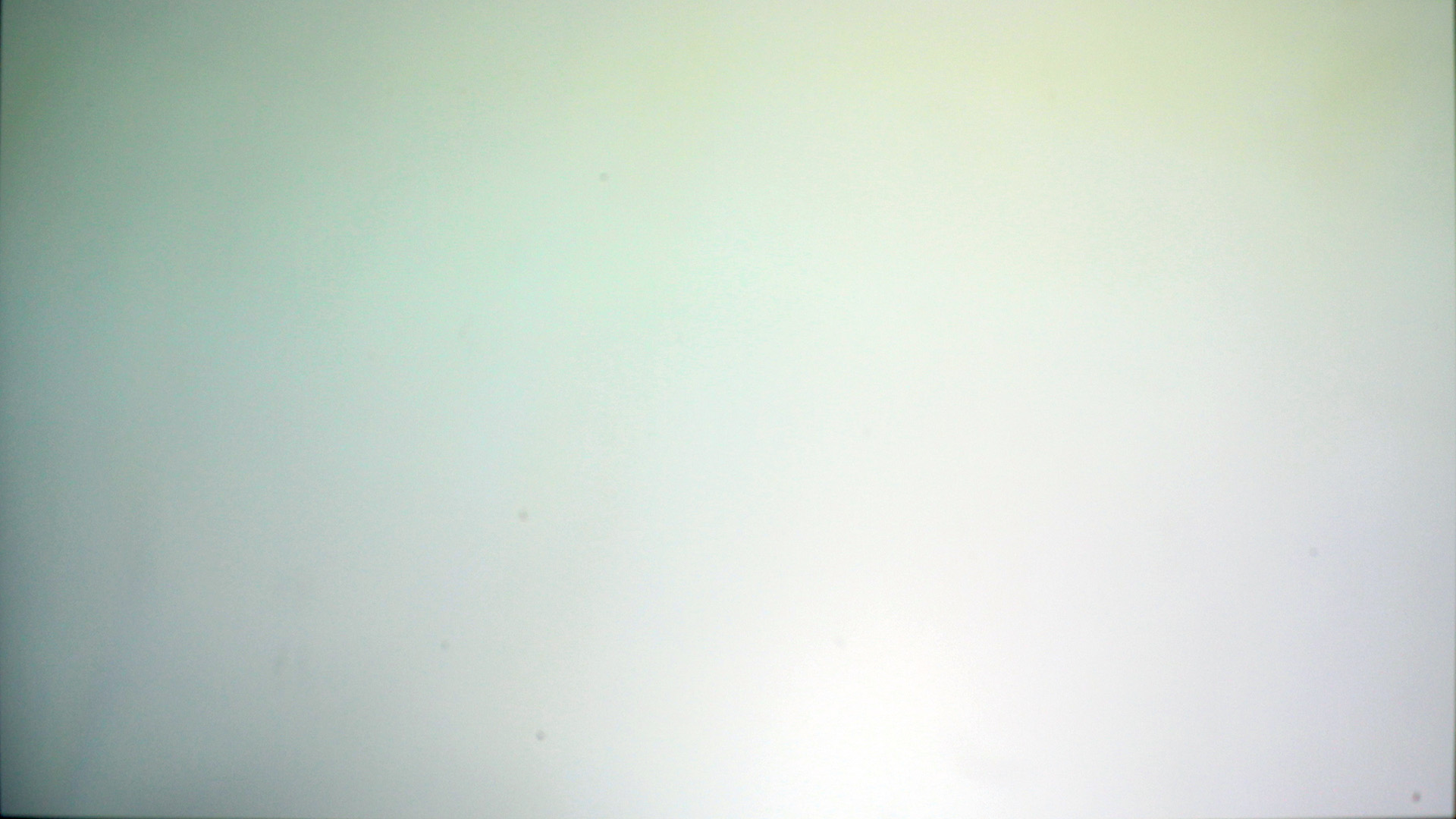

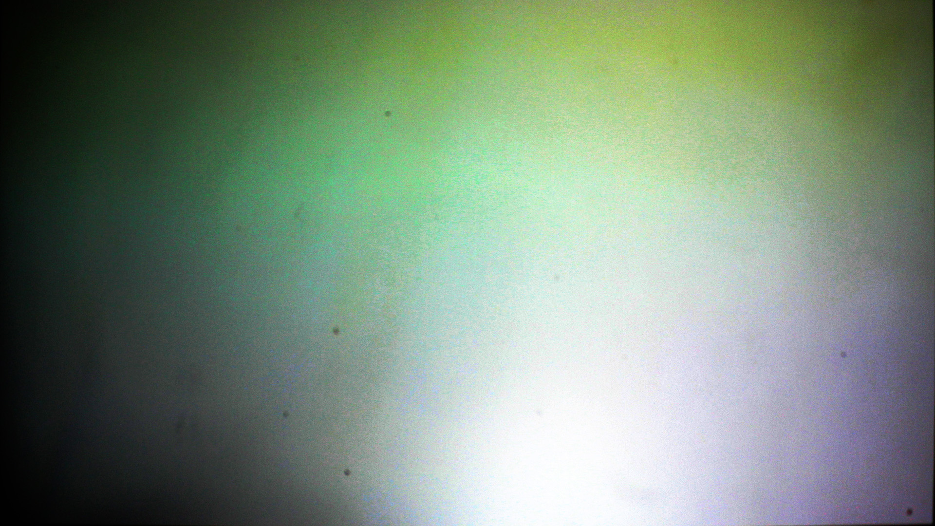

this is photo taken with my dslr from a white image projected in a white wall. can see clearly the hot spot, and how brightness decreases to the borders, especially the left side.

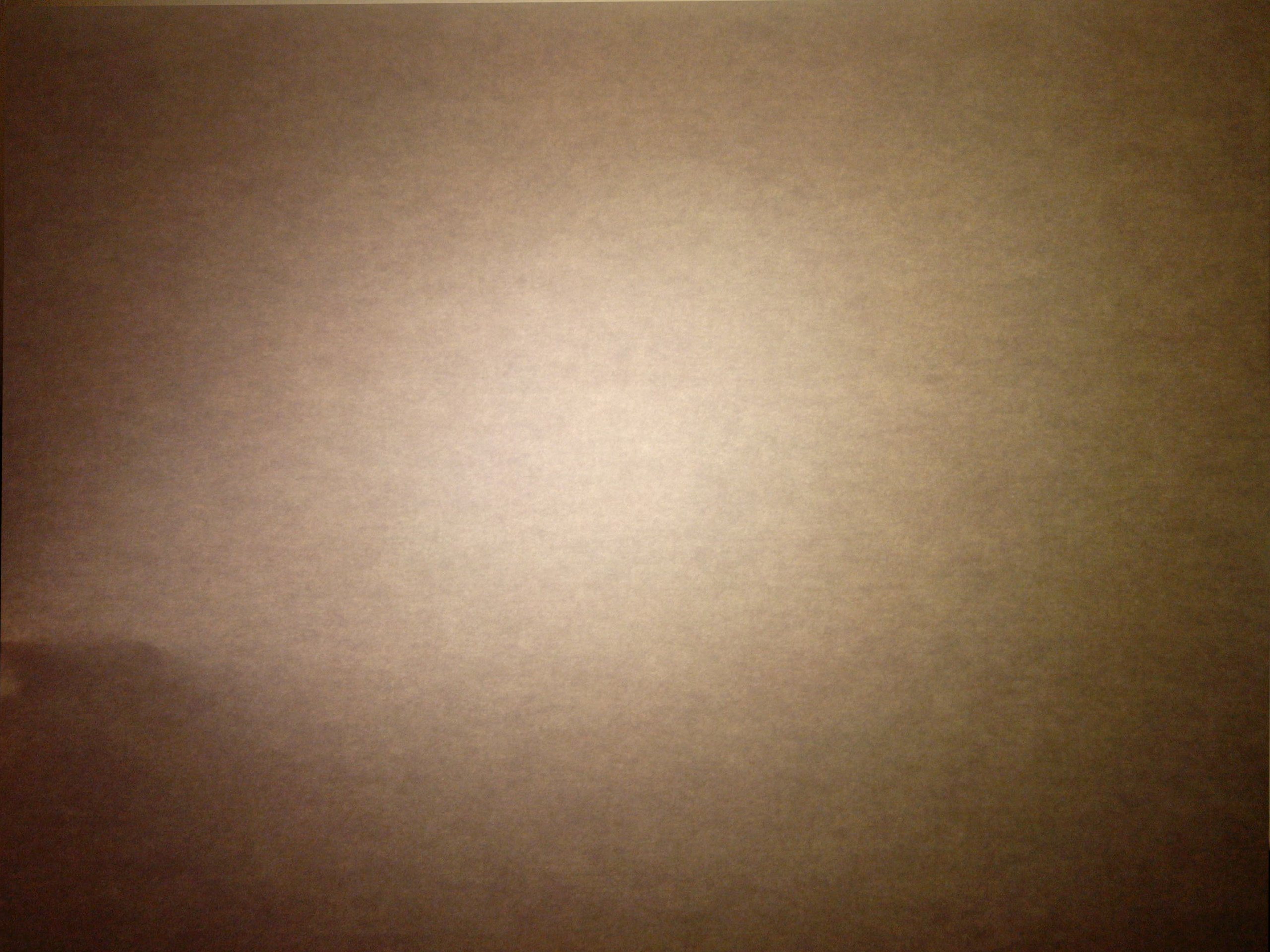

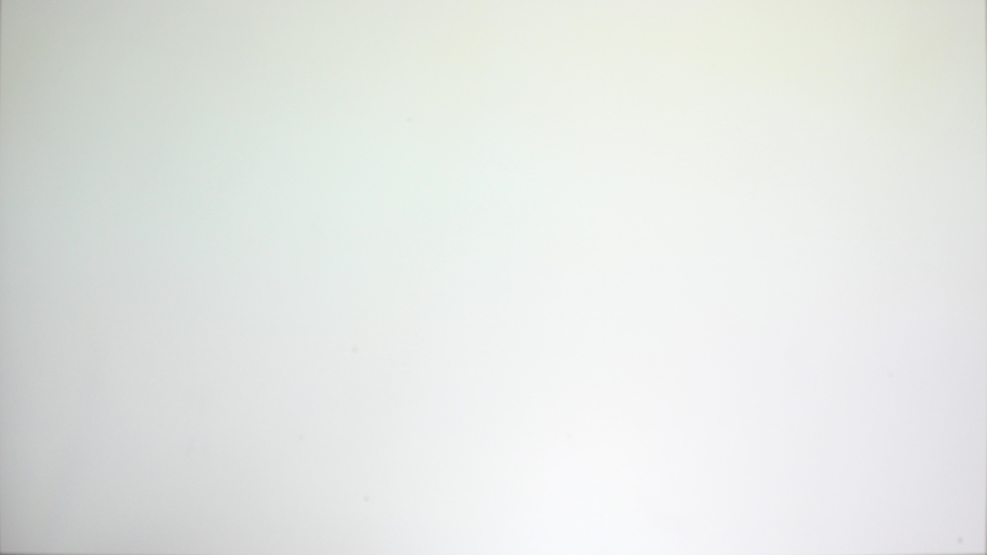

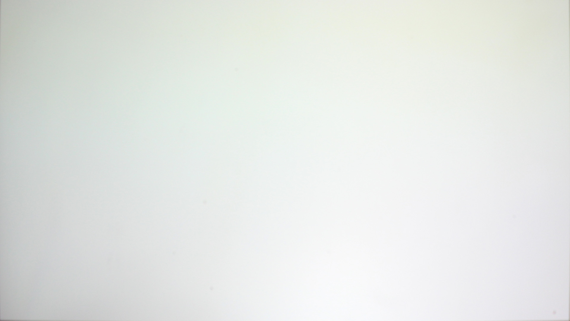

this photo is photoshoped with automatics levels, and the degradation is more visible.
with this filter, is much more visible, not realistic, the brightness diference.
now, i guess, i must invert and convert some of these images to apply the mask.
