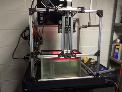

First 3d build here and it turned out really well. Specs at the moment are 7.5 x 4in x 7 tall. Resolution is currently 100 micron xy by 170 micron z layers. Thanks to Muve 1 and Pacmanfan for making these builds accessible to all. If anyone has questions feel free to shoot.
- edit sorry for the wrong numbers. I just figured out how to calibrate z for leadscrew in marlin. Had no idea how to calculate the real height until now.

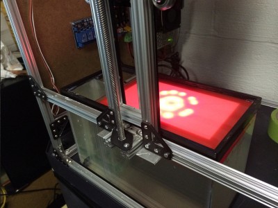

Wow! That looks great! Are you using a fishtank as the vat? What size is it? Are you floating resin on water?

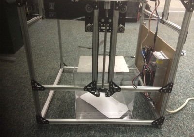

Soap cuts surface tension for consistent level. No soap in contact with resin I'll post pic when I get some time.

Ok so...still trying to wrap my head around this
The smaller "build height" compartment is connected with the build compartment through a hole on the bottom?
the 3rd compartment is empty and catches overflow from the build height compartment?
soap layer is ontop of the build height compartment?

Is there the possibility to have more photos of the tank build?
