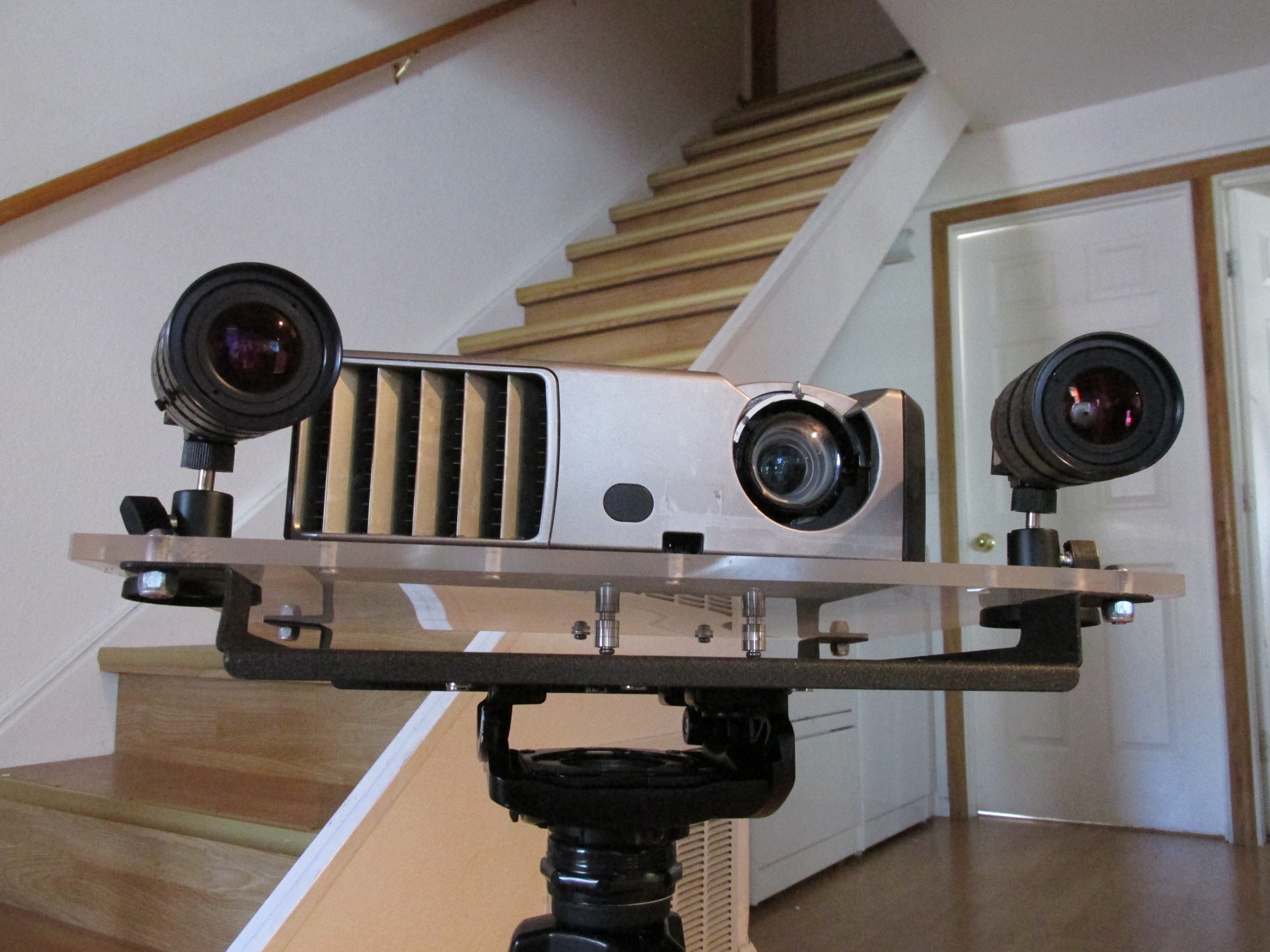

Finally, my fully assembled structured light 3D scanner.

do you have any scans you could show us?

So far the only scan I've been able to do with this configuration for lack of time is this one:
Hopefully I'll be able to run more scans this week.
