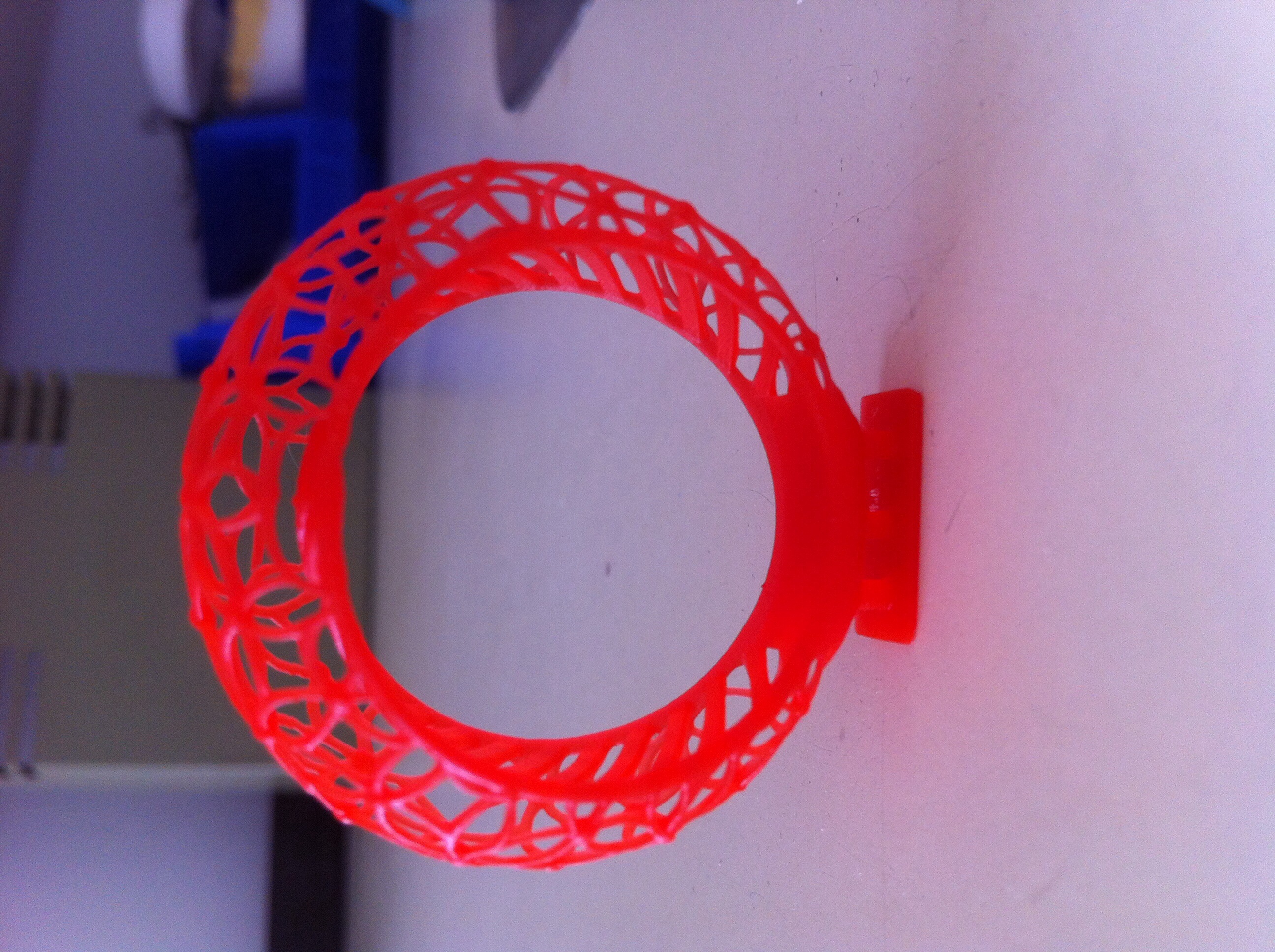

@seblos Is that with LittleRP?
Re: FTD (FunToDo) resins on LittleRP?
@seblos, a really nice print!! Congrats.
HP thanks!!
