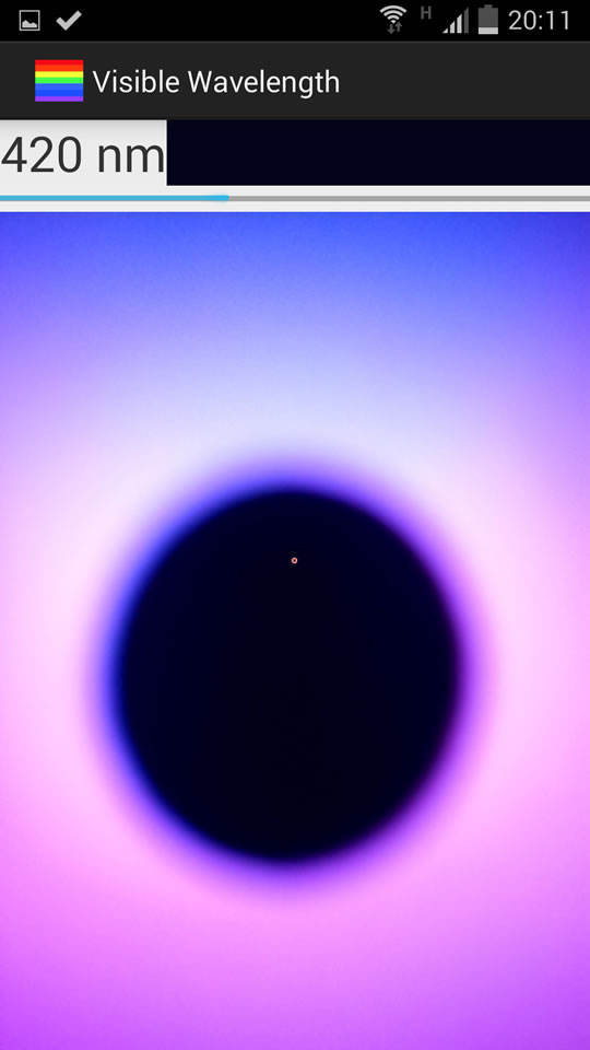

i set 405nm they show me:
Color:
rgb(130,0, 200)
Hex: #8200c8

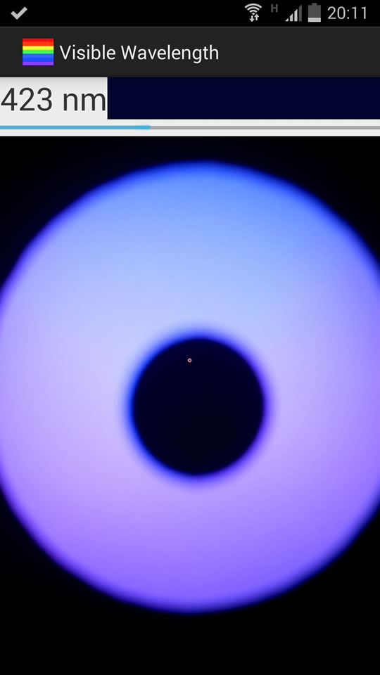

I put this in WC and using a app to mensure Wavelength
second test:
My question just Wavelength is enough or will need some extra light than LCD panel light ?
maybe if put some lights behind and project with color thats makes 405 nm ??
cheers!

My question is:
Just a wavelenght cure resin or need light power eg: this wavelength with 2klumens of light ?
				nc42
- Posts: 126
Re: LCD Based 3D Printer - Introduction
Cure tune is a function of the intensity of the light at the appropriate wave length. Adding light of other wave lengths won't improve the cure properties

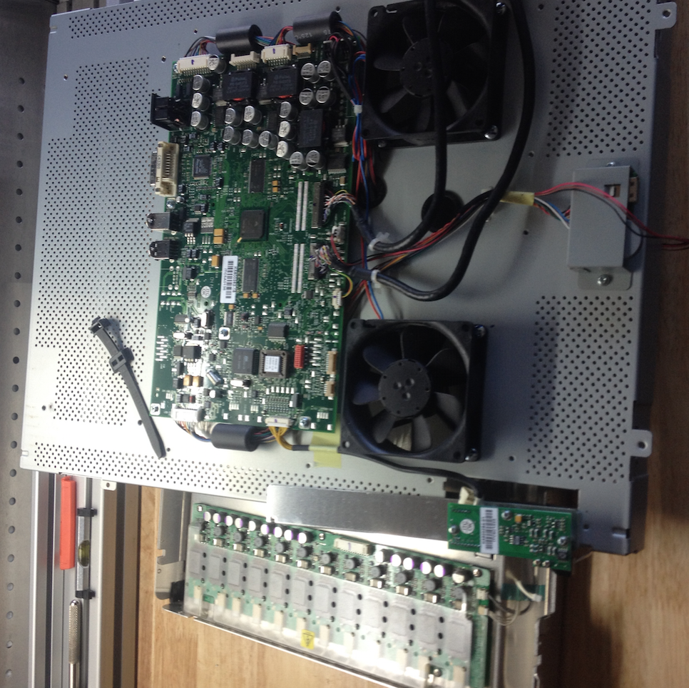

Taking these monster apart; is not a joke.
Sincere Regards
Saeed From Los Angeles.

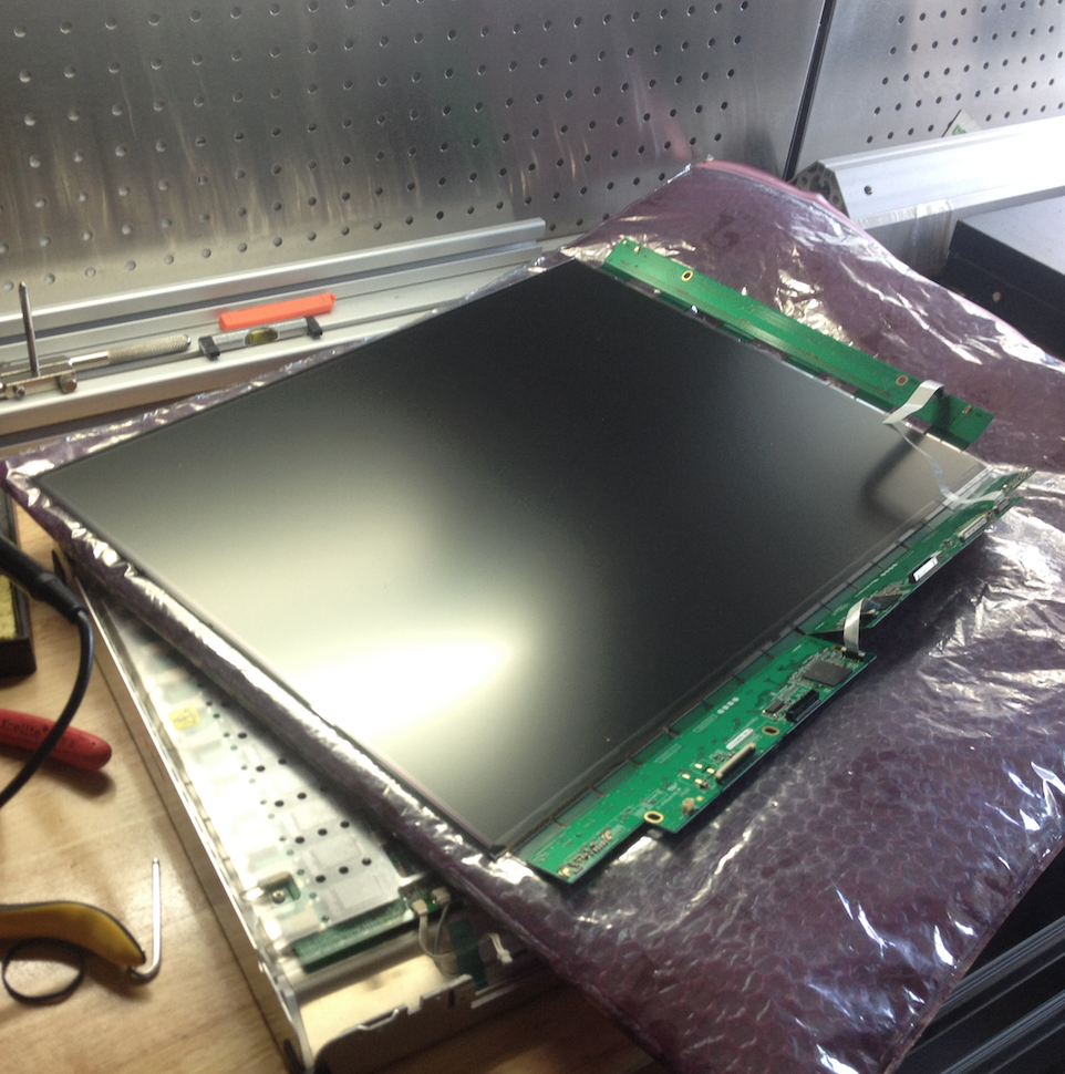

IMO, buying a used monitor is not the best idea.. I have a grave yard of about 6 greyscale monitors. Only a few had the right controller board. You will find most of these monitors use the same panel, but have different controller boards. The panel they use is made by IDtech.
They arent that hard to strip down, but you will have to be very careful. You will also have to remove antiglare layers from both sides of the LCD.
Ive gone to buying the brand new bare panels and I have a supplier who will make me a custom controller board for it.
I dont know of any suppliers still making Monochrome (Grayscale) LCD's. I think the market for them was mostly Xray viewing and new xray equipment is utilizing color to highlight different parts. So not much demand for these screens.
